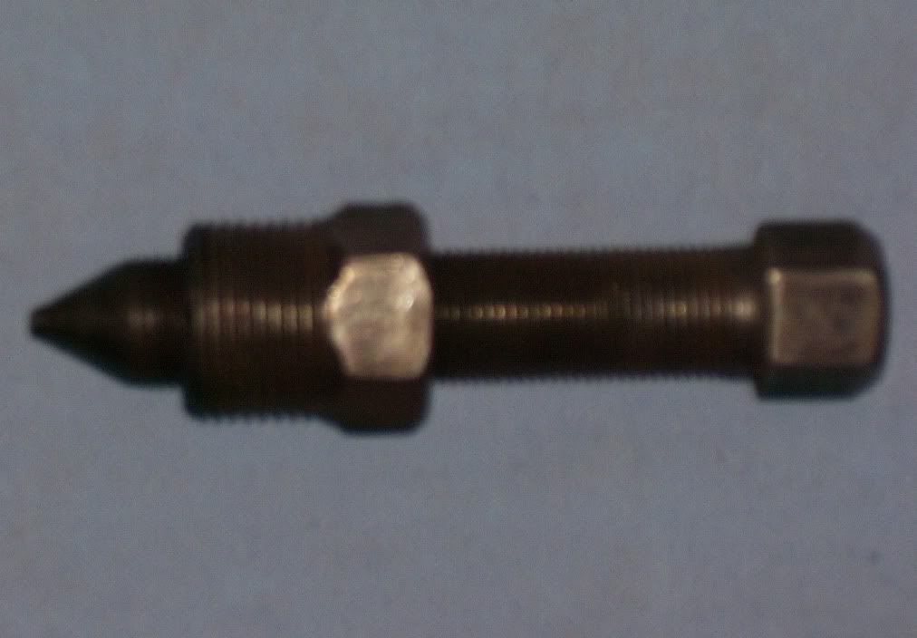

yep the threaded insert with the pointed driving bolt is what you want the red motor one bolts on to the inner section of the balencer in 3 points
Better dead than red
EK, the VN of the 60s
Heres a pic of the tool.
Coxhead tool# 1603
The thread that screws into the balancer is 1' 1/8" UNF
Thats a diameter of 1" 1/8" With 12 threads per inch.
Just incase you want to make your own.
This info is correct.
If its not, Munro & Spyder are going to be
laughing at me...again :oops:

Hey karsten i also got a super cheap special which hasnt meet a balancer it couldnt take of yet.I assume it would work on a grey aswell.I have since made one up myself though which is much the same as thommos only a bit shorter and is mainly used to turn the engine over to adjust my roller rockers.
