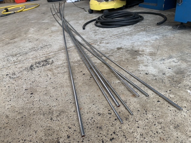

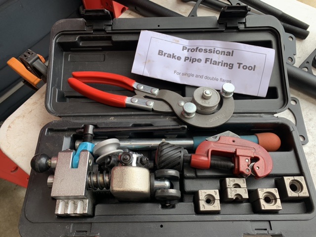

Actually excited about this part. Clay was kind enough to lend me his tube bender and flaring tool for the job.
Went out and bought all the tube and fittings and I’ll have a play to see what I can make up.

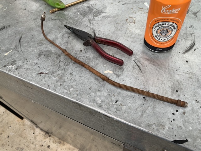

Question …. Is brake line ‘coil’ shroud actually required?
I’ll have to cause it down if necessary but I don’t have it for today…

yes.
it does 2 things:
prevents crimping
prevents shock
you can buy it new from the same place that sold the bundy tube
it does 2 things:
prevents crimping
prevents shock

Thanks for the advice, the bloke at the brake shop in St Marys said the coil just stopped the tube rubbing on the chassis and all it did was catch mud and I’m better off leaving it off.gpi wrote: Sun Dec 05, 2021 1:49 pm yes.
it does 2 things:
prevents crimping
prevents shock
If Holden did it in the factory I guess I should do the same here now.

Two types of tubing spring:
a) the temporary type. You fit these over the tube, bend it by hand then remove the spring. It prevents tube crimping. Can buy these springs in Bunnings.
b) the permanent type. Prevents chafing (at least until the spring wears through too) and rock damage. Collects debris. Not sure you can buy this type anymore. I left mine off, and just took care when running the tubing to ensure no rubbing.

Yeah Harv I’m hearing you, been running the lines all day and I think with using the rubber clamps in the right spots I can stop any rubbing.Harv wrote: Sun Dec 05, 2021 5:56 pm
PS: notice you found the 3-way brass block... where was it hiding?
Also we drive on 5% of the dirt roads that we had in 1960 so it’s a fair bet that the brake lines will be pretty safe.
