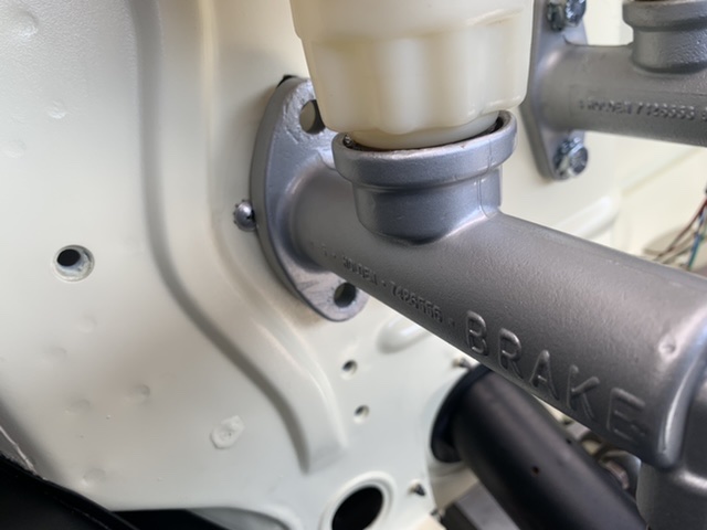

So today’s set back has got me stumped…
I got all the brakes overhauled at PBR in Adelaide near 12 months ago and I’m today I got to the job of fitting the master cylinders so I can start making up the brake lines.
Clutch master fitted ok but the brake master is no go!
Brake has a wider base and it doesn’t have clearance to sit flush on the firewall next to the small screw which locates the pedal assembly.
I’m thinking PBR got my master cylinder mixed up with another customers as I took both my masters off the car and sent them in so I know that they fitted ok before hand.
Photos show the two different shape bases so I have got no idea what has happened.
PBR said ‘they will get back to me’…..
Drew
Posts: 2705
Re: FB Standard Wagon
Chinese casting !!
Die grinder or linisher to take the sides down.
Those masters fit a couple of model Holdens EK EJ EH etc so probably generic.
Your original maybe with the master gods, good luck getting it back.
Posts: 11647
Prolly got some originals if you want. Did they resleeve? Just have mine a quick 240 grit finger hone and new rubbers. All good.
FB ute driver, EK van project
Posts: 14249
Just die grind a bit off and whack it on mate , not an original one anyway so what the hey ....
