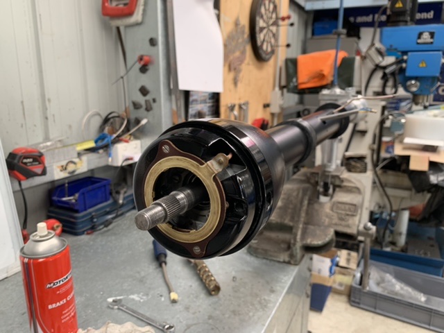

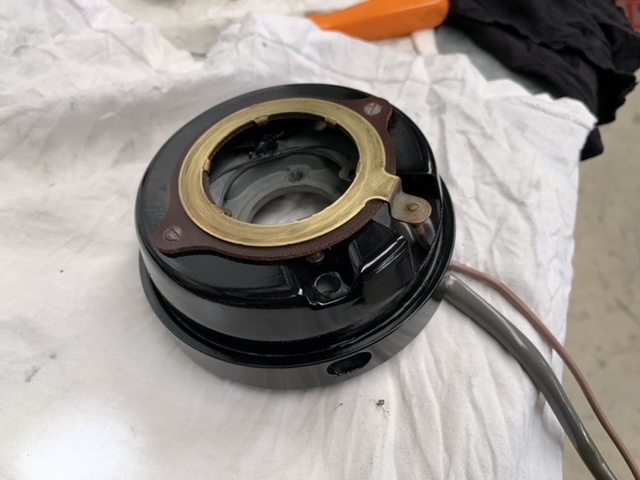

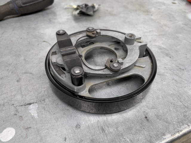

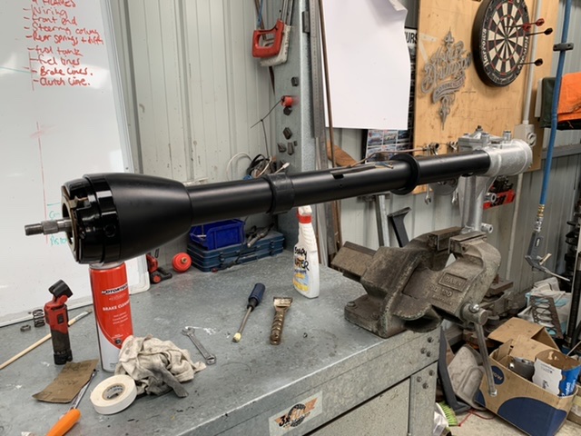

So life is busy and I’m doubting that I’ll have the car on the road for the Barossa nationals in June but I’ll keep soldiering on.
Built the steering column and rebuilt the indicator mechanism too.

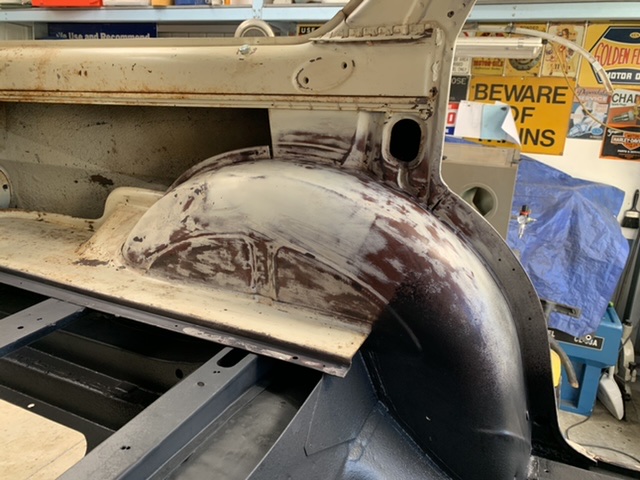

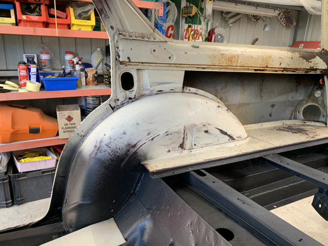

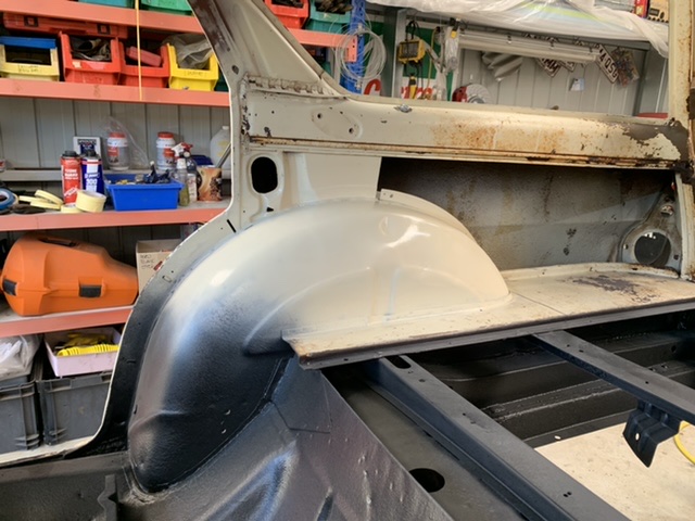

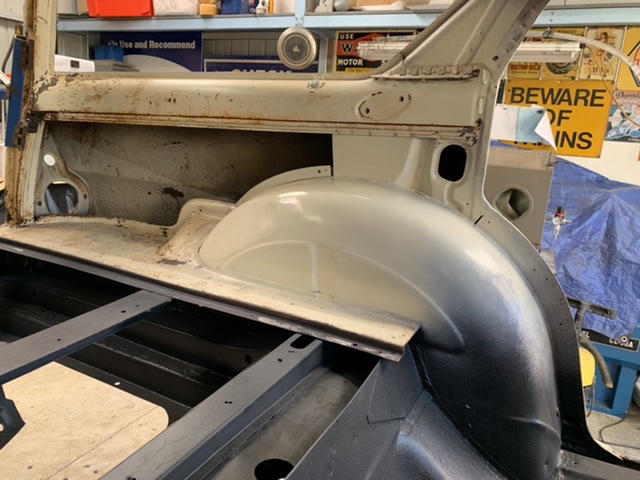

And my spray painting mate Damo came over and showed me how to tint some paint and do the age old trick of blowing some paint in so it doesn’t stand out like dogs balls.
Low pressure, low material, small fan on the gun and wait for it…
A piece of cardboard to stop any over spray!

Cheers guys, I must say it’s a challenge to not go that touch to far on the body and paint because just a touch too much will just spoil it.
I think I went too far with painting the firewall but I jut want the engine bay looking new incase the coppers pull me over.
Well it guaranteed I will get pulled over haha, it’s gonna be a copper stopper!

Nice work Drew
Who would have thought ........ cardboard hey! Oh forgot to say the steering column looks very tidy too
