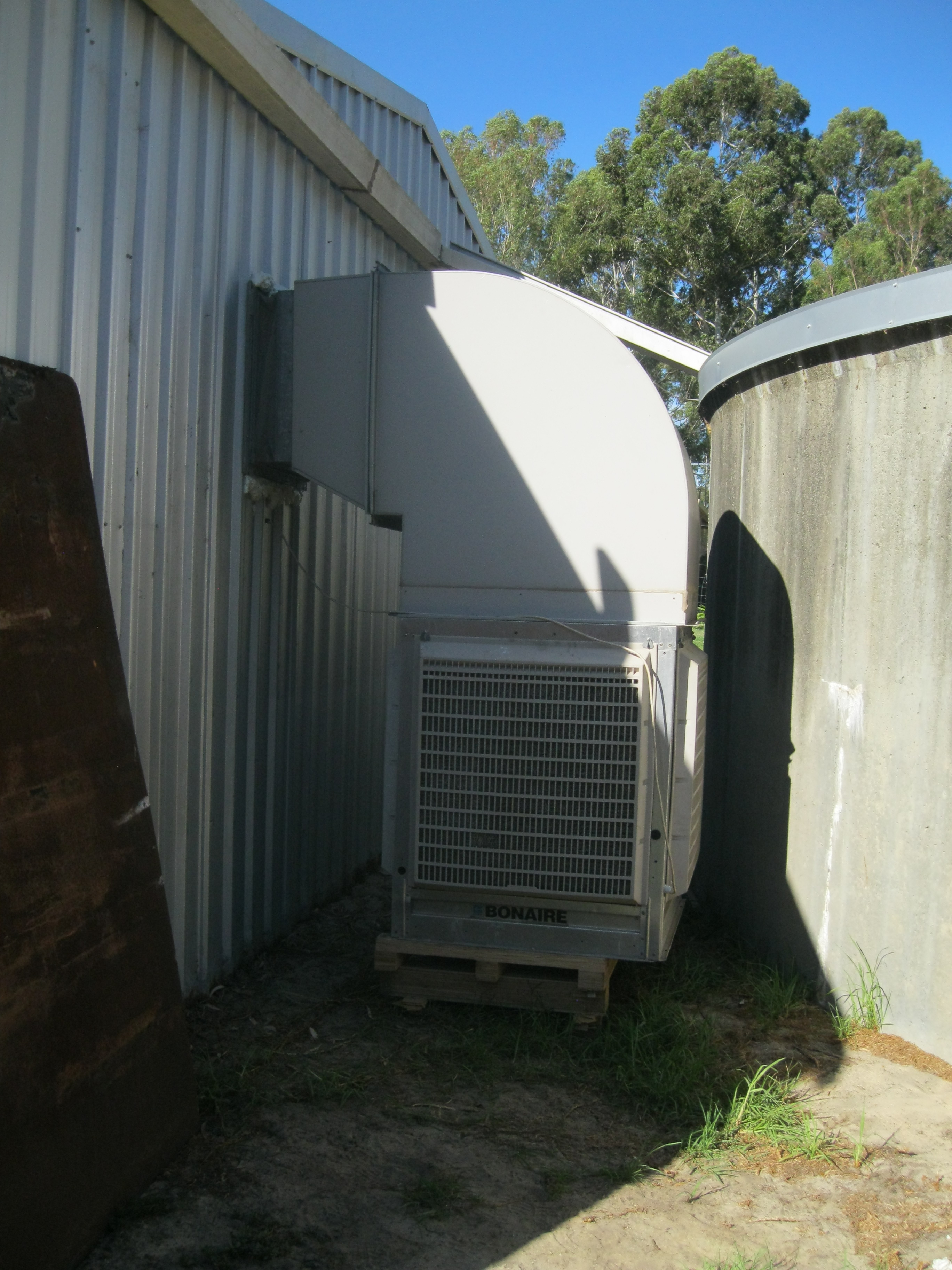

I am guessing where you are doesn't get too humid ? an evaporative cooler uses bugger all power , I have 3 on my shed and its as cool as a cucumber in summer with zero insulation

I followed Blacky's lead after being in his shed one day, he had a couple of these laying around in the yard (amongst other stuff
) drop the inside of mine by about 10 deg
Re: Project 2.
That's a big one!
Took Blacky's advice and bought a more modest version this morning off face book market place. Not good for painting but should help for everything else.

Thanks for the offer Blacky, I have 20 amps of electrons, but have taken your advice and gone for low power evap option.Blacky wrote: Tue Nov 02, 2021 11:30 pm You lucky, lucky bastard - wish i had the time a retired person does , I will be working up until lunchtime on the day of my funereal![]()
send me a pic of your switchboard in the house and the shed and I will see what you have and how many spare electrons you have floating around![]()
Re: Project 2.
That's the same size as the ones Blacky has on his shed Brett tells you how big his shed is ha ha
Re: Project 2.
Yes, mine is not so vast. There are an increasing number of humid summer days now, but should still be a big improvement. I couldn't see how an aircon the size the power supply could support would keep pace with the gaps and the lack of insulation.
