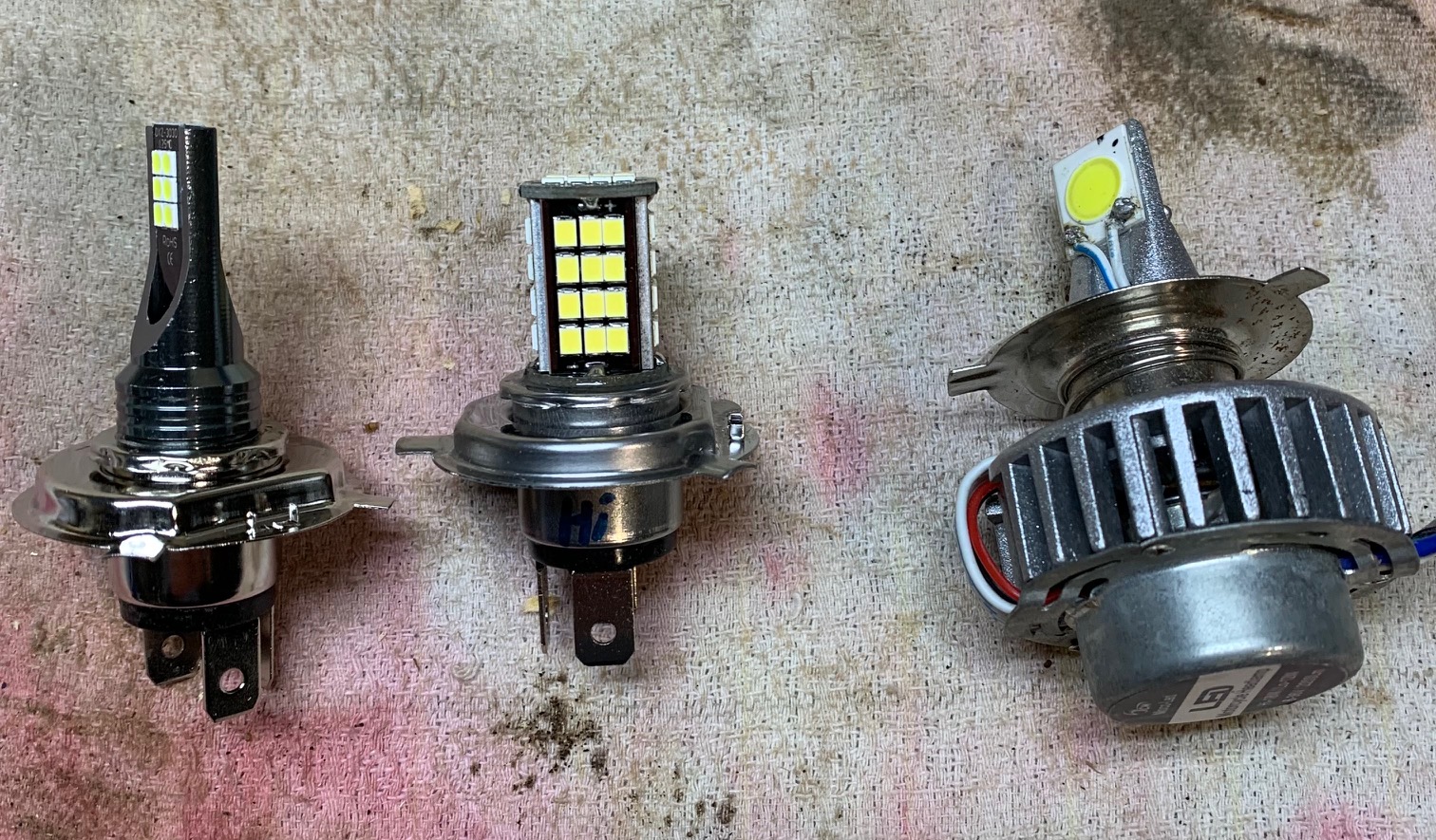

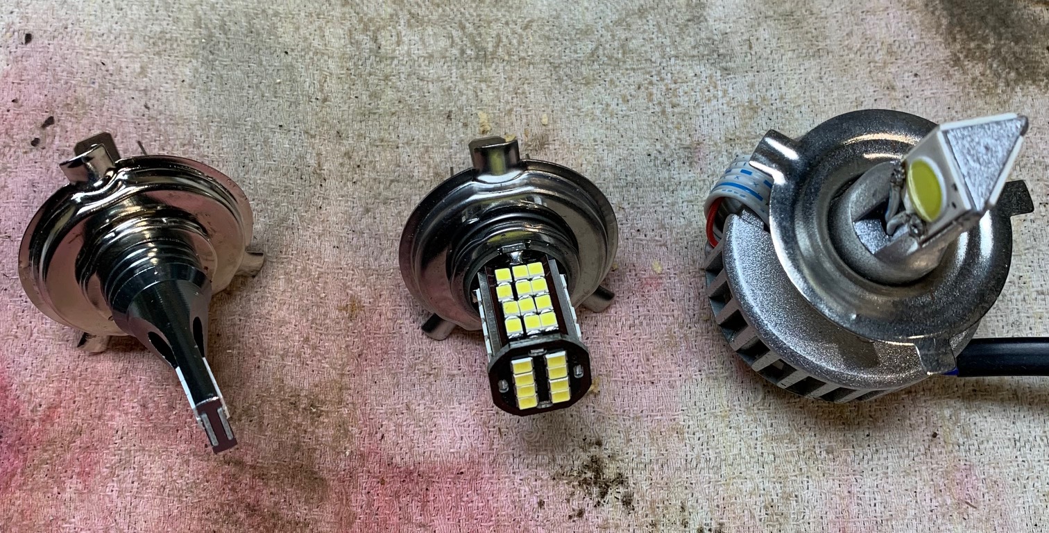

I have also played around with LED in my motorcycle (single headlight) and they vary quite a bit.
Left LED - poor quality in terms of light volume (lumens) and beam. Hi & Lo is only effected by dimming the output. As such when you go to high beam you don’t see further down the road. Not recommend.
Middle - This one runs on 6 volt which is unique (not an issue with your FB or EK) but great for 1936 vintage bike! Also available in 12 volt. A lot more LED’s, more light but same as above with hi/low beam.
Right - The best of my sample by a mile. Light output is huge and a much more concise light output concentration. Two LED’s for low beam and third LED for high beam. Don’t believe eBay description that it runs on 6 volt (reason for purchase) because it doesn’t work! Fixed that with a Buck Tranny though, anyway no probs at 12 volt. My only experience was the life of unit, one LED failed then another. The best of my trials.
LED globes can be easily adapted to fit old headlight units (as I have done on English bikes) and would be worth pursuing. Ultimately depends on what your requirements are in the end. Hope this helps.
