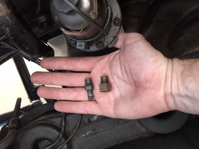

I had some issues with air into the fuel bowl recently. I started with a hose directly connected to to fuel pump into a jar of fuel. Best to keep the jar far enough from anything that might spark. Screwed a barb into the fuel pump. Hose on the end of the barb and other end in the jar. Helps eliminate the fuel pump as the issue.
Cheers Andrew- Attachments
