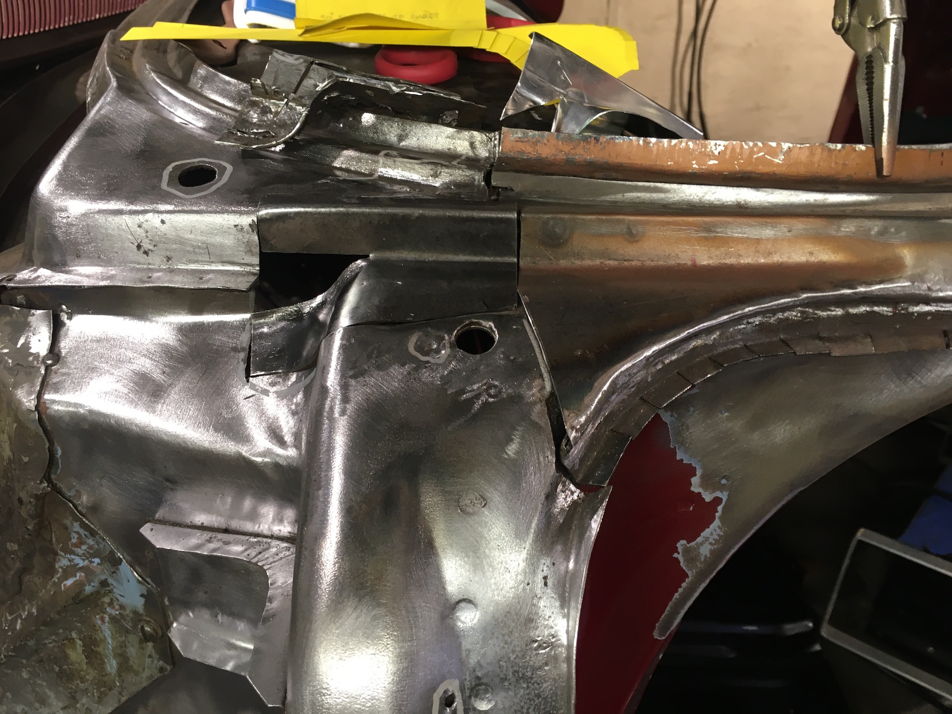

Also cut out the next rust fix.
Time to get out the thick yellow card again.
Scott

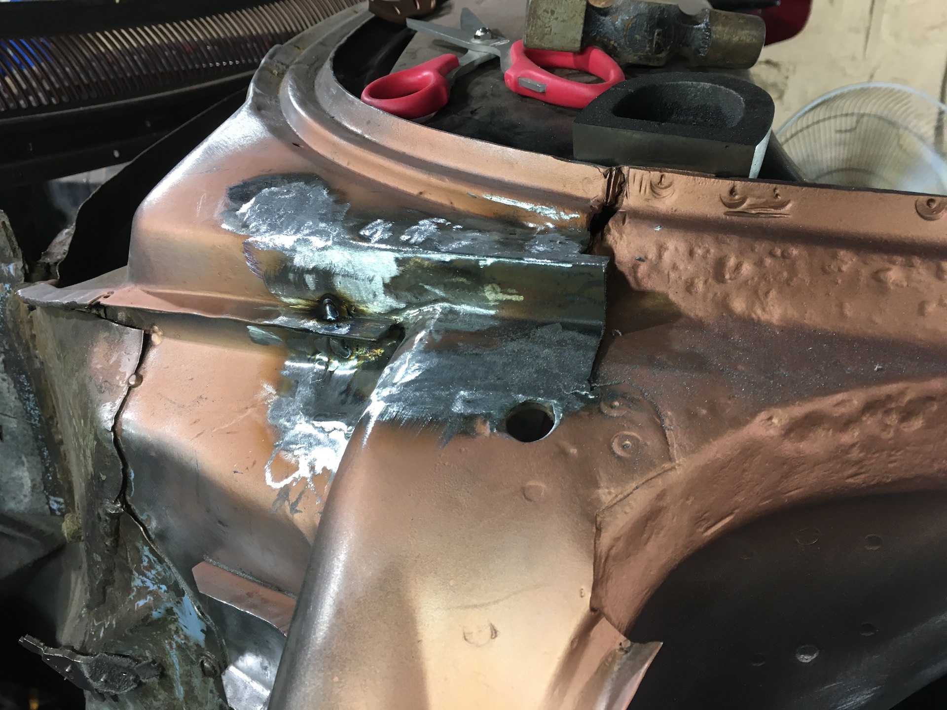

Finally finished fabricating that small rust repair.
First couple of folds and test fit. Started adding the bend to match the curve at the top of the A-Pillar. Bit more hammering to complete the curves and add a lip at the bottom. Rebuild the end of the seam folding over a bit of scrap I had lying around. Should have spent more time finding a bigger bit and I could have made this in two pieces All 3 pieces welded up. Welded in. Still getting rid of a couple pin holes. Drilled a couple 7mm holes in the RHS to plug weld to the A-Pillar too.
Scott
