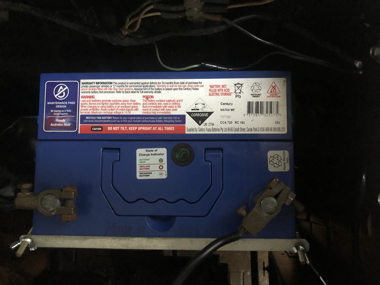

Something to think about. With the posts inboard of centre the positive clamp is pretty close to the steel threaded rod, wingnut and retainer bar. I would look for a battery with the posts on the centreline to avoid potential for a short to earth.

I run a Century NS70X MF in both Graces ute and the FB. It’s a little larger than what Century recommends, but still fits neatly in the battery tray. I figure a few spare CCA can’t be a bad thing. Clearance to the hold-down bar and terminals is OK.
