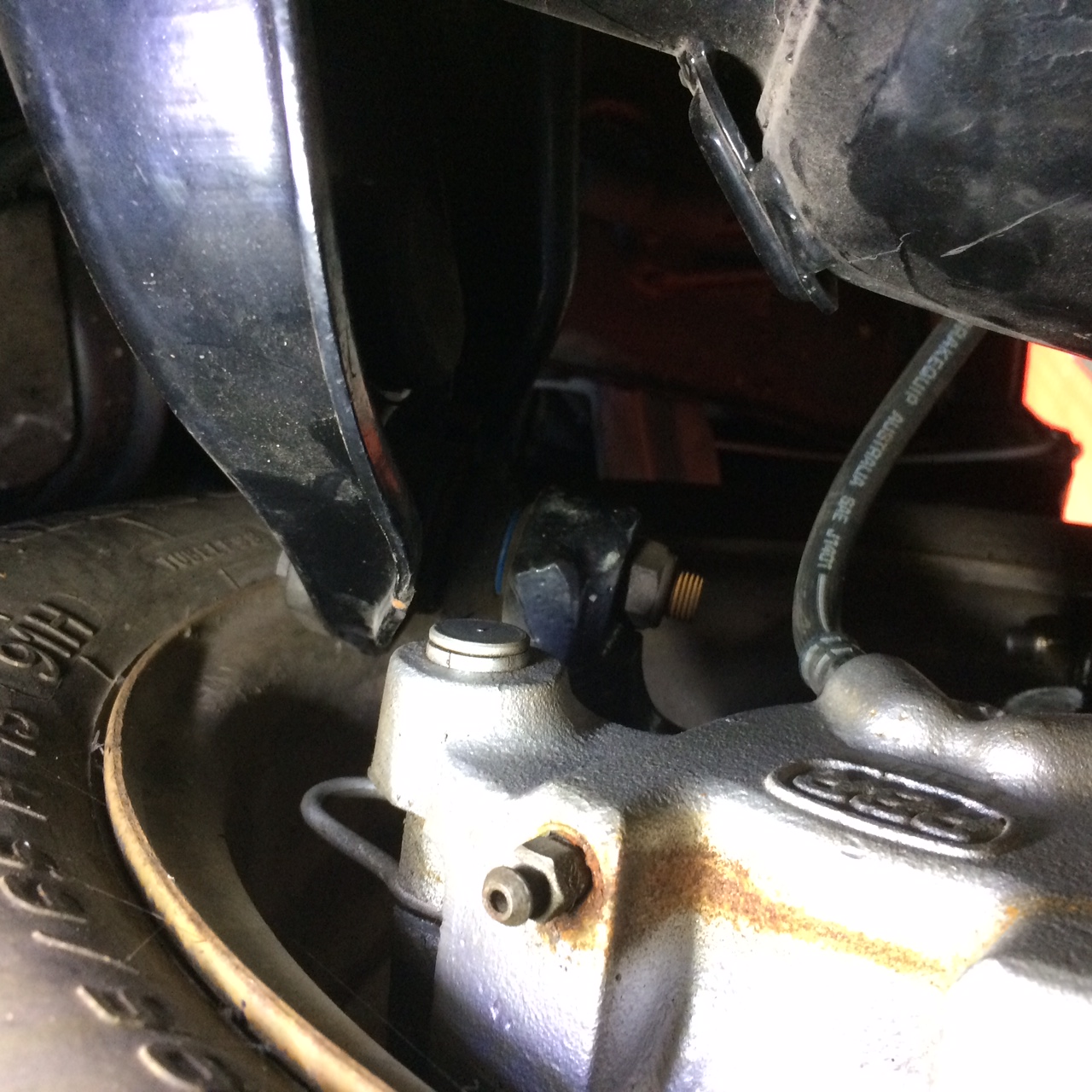

OK, I can't post pics. It seems I need to have some public hosting thingy. I thought I could do the old drop and drag but those days seem gone.
I tried sending a PM to you Neil including a pic, but that was the same.
But on GMH - torana forum is a picture that is same. See post 10 on this http://www.gmh-torana.com.au/forums/top ... onversion/
The top part (pin/slide thing) of the caliper when turning steering in the opposite direction, hits the edge of the top control arm (wishbone) near the top ball joint.
As previously mentioned. Problem started when I put in new lowered King Springs - dropped 60mm. Centre of hub to top of guard is 245mm. Presuming standard springs are 30mm higher, raising vehicle to 275mm, still doesn't raise the vehicle enough to clear the caliper. Raising it to 300mm, lowers the caliper enough to clear under the top control arm. Clearly the springs I took out are raised.
The other thing I note is my original engineers certificate suggests the calipers were alloy Girlock from HZ, it is now carrying Cast PBR HQ. Not sure if these are slightly wider. I need 1" narrower clearance at the top pin of caliper.
Hope this helps.
Hope this helps.

Re: Lowering front end, caliper now hitting top wishbone control arm
eKay
I use a site called TinyPic to post photos others use tapa talk I think it is called don't use photobucket.
The cast caliper does seem to be higher than the the girlock one.
These are a couple of fairly old photos from my FC build that show the Girlock caliper, not sure if I had the drop spindles on there or not at this stage and the lowered springs are still in.
In the first photo you can just see the top wishbone and the fact that the front edge is angled from the pivot point back towards the ball joint, I would like to know if yours are like that and did you say you moved the caliper to the back if so this could also be your issue.
See if you can post the photos again or PM me and I will send you my email.
It looks like the Girlock caliper is narrower at the top pin and that could be the fix - maybe..
