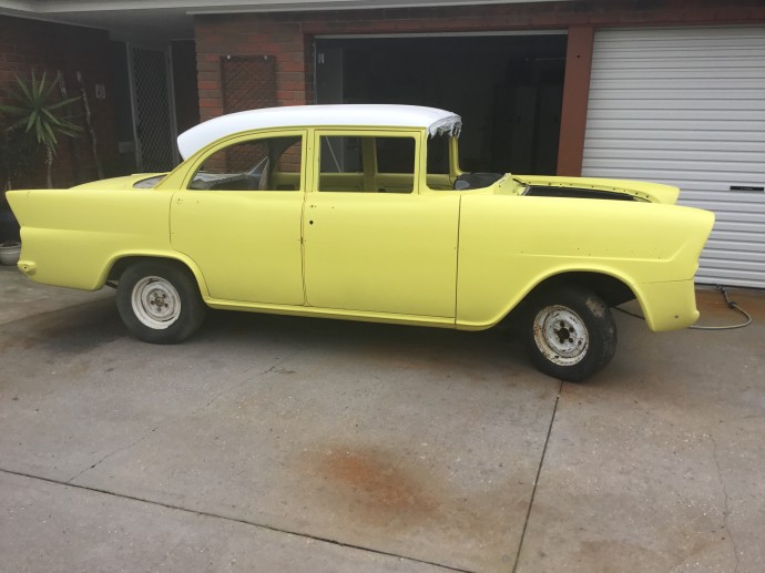

Picked up an EK sedan on the weekend and just starting work on it. Body is in fantastic condition except for the floor foot wells. Ordered a tunnel from CRS and 4 foot wells from Rare Spares.
Does anyone on here know what and how the brakes are fitted on the Castlemaine Rod Shops custom front ends. When I spoke to them this morning they didn't have a clue on the product they are supplying. They said they where &*#@ discs.
I'm just chasing what model they are to see if I can get a hub for it like they use on the VB - VK Commodores. Hoppers make a &*#@ hub but I have to know what hub CRS are using. If I know I can get a hub for the CRS front end I can fit VT rotors all around and use the hat style on the front and use the hat to set my offset.
Anyone have one or know about them.
Thanks Trevor
