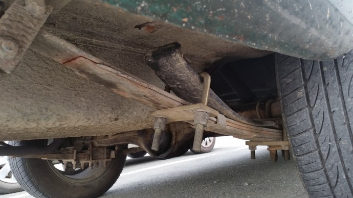

Hi Guys, well I got my WOF but I am totally unhappy with the rear suspension setup in my new (To me) '59 FC
Im not a mechanic by any means so take it easy on me as I try to explain my issue below :-P
To get the WOF I need to re-juggle and align the non-standard "helper spring" you can see in the attached pics. This spring just seems all kind of wrong to mein a lot of ways. There is no "block" or "depression" where the U-Bolt should clamp, so the U-bolt can slide down the curve of the spring as you try to tighten it. Basically the setup just doesnt look right to my eye...
You can see the stance of the car in the side view. I think the rear springs are quite "saggy" which is why the previous owner installed the "helper springs". with just 2 average size people in the back seat the wheels will rub on the rear guards at the slightest bump in the road, and the car seems to have quite a bit of "roll"
To my eye it looks like it needs to go up in the rear, or down in the front. Down in the front would be great to my eye, but I already have the front wheels rubbing on the guards under cornering and small bumps, so I think up in the back is a better/easier option. I think I might want to keep it standard also as apart from the wheels its pretty standard.
So Im thinking of throwing away the "helper" spring and someone told me you can get the springs "reset" There is a place in CHCH that does this (http://www.springs.co.nz)
My question to the gurus on here is this the best option? I would like the rear "up" just a little and probably much firmer. How would I go about communicating this to the spring guys if I just send the springs? Should I take the car to them to look at?
Should I be looking for extra or different springs from something else? etc etc
Thanks for any help guys, would like to tidy up the rear end of the old girl if I can.

Have you thought about a set of ute/van springs?...... I would lose those 'helpers' !!

One option would be to go to a spring works place and have them reset/ refurbished. Or try and pick up a second hand set and swap them over.

My FB sedan had those helper springs. I don't think those are installed correctly, they should be underneath I reckon. In any event I would say the leaf springs have just sagged over time. I had my springs reset to standard and they also inserted another leaf (full length). Was a big improvement. Have a chat to the spring guys and see if they know what the specs should be for the original springs and go from there.

I tend to agree that these 'helpers' appear not to be installed correctly. Now I maybe be wrong, but wouldn't placing the 'helper' between the top of the original spring and the spring pad on the diff housing in fact lower the car?...As per a lowering block?....If so, then these helpers are helping lower your car by what looks to be about 10mm (the thickness of helper). They're also doing some damage as can be seen in your original pic.
[Edit] This applies to FB/EK so I'm assuming FE/FC will have a similar rear leaf options.
Sedan, 4 leaf.
Wagon, 6 leaf.
Ute/van, stiffer 6 leaf.
The six leaf springs will raise the back by approximately 1"
