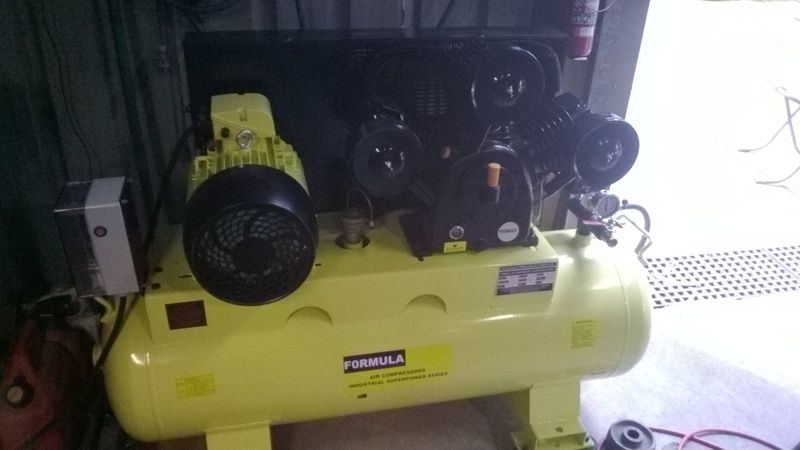

I had a 15cfm for years used it with a with a sandblaster, spray painting etc but it finally died and I had to upgrade.
Because I wanted to paint with 2 pack I bit the bullet and bought a 42 cfm unit that supplies breathing air as well as run the spray gun.
Its the best thing I have ever done. Of course its up to you and I don't know what type of paint you are using but for me safety is paramount because the isocyanates in 2 pack can be deadly.
I call my compressor the grunter !Image

She's a monster!

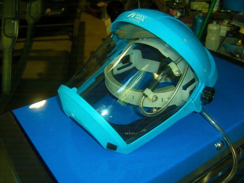

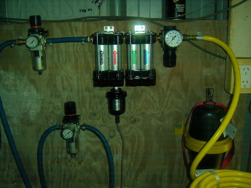

Out of interest how does the compressor supply the breathing air ? , does it have a dedicated filter for the breathing air ?

Yep you need a different regulator that converts the air to breathable. Also the you need a different air line which is rated for breathable air. I still wonder how good the air actually is?

Yes indeed you need a separate filter/filters for breathing. I have a water trap then a martech 4 filter inline and dedicated to my breathing mask. The filters take out water, oil, carbon monoxide, and fumes and apparently give you good quality air to the positive pressure face shield. Unfortunately I have asthma and I cant take any chances whatsoever, I really get pissed off because everything a car represents it just bad for me, fumes, fuel, tyre smoke, welding sanding etc etc. I try to stay one step ahead and just use masks all day long, so far so good. :) :) :) :)
The bottom regulator goes to a toilet paper filter on the right to collect all moisture before the spray gun and works a treat.
The top is the dedicated breathing line this to works very well and the air tastes better than the air outside :shock: :shock:
The mask pressurises and there is no way any isocyanates can get in as its positive pressure.
The only issue is you must keep the compressor isolated from the spray mist as this can suck the fumes in and straight down your lungs. The breathing filter manufactures don't guarantee it stops everything so I don't chance it.

Thanks for the extra info Greg , nice setup too .
