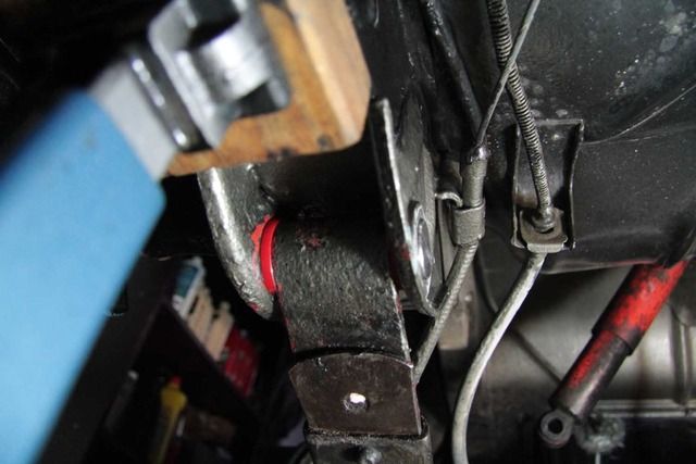

This is what instigated the rear suspension refurb. I had a "clunk" in the rear end when going from forward to reverse.. couldn't find it in anything around the axle - but when I lifted it up on stands to do the wheels, I found this.... the front bush/pin rubbing against the frame - and the outer end could be moved using a lever....

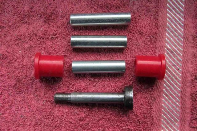

This shows the original pin from the left side with the crush tubes and nolathane bushes provided in the kit.
These bushes are a good fit over the crush tube - they have a much larger hole to fit over the crush tube than the originals and one end has a smaller diameter of the outer end - this goes on the inner end of the pin - but I used the full diameter one on both ends of the right hand side.
The longer tube is not used, the shorter one has to be shortened by 4 mm - you can see all three in this pic.
Along with shortening the tube, I had to ream out 0.5 mm with a round file so that it would slide over the original pin.

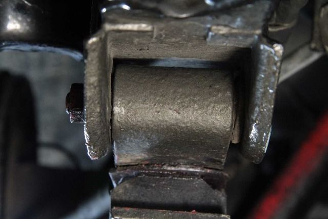

Ok - so the offending bits on the right hand side have been removed. The new pin, crush tube and bushes are fitted.
The Rare's pin is a nice sliding fit inside the crush tube (no filing required) and the bushes, of course - are a snug fit over the crush tube.

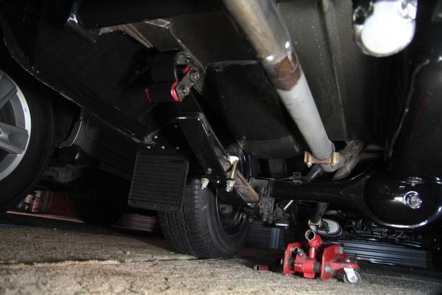

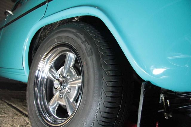

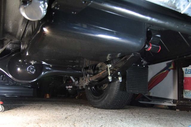

A few pix of the result...
and this is what I ended up when the vehicle was lowered back on the deck - didn't gain one bit of clearance, but I now have a very firm rear end and I'm hoping it will no longer dip so far as to scrub the walls of the tyres.

So, to end my input into this thread off...
