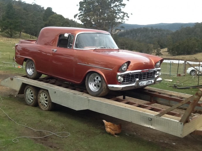

Gee over 12 months since my last post , what a slacker :shock: .
For those that are interested still no progress on the ute unfortunately , have moved house again , didn't like the city so have gone back to the bush .
Continuing on with my problem of buying old crapped out things ,I have brought a 1901 Farm house that was half falling down and have been flat out making it Liveable.
Have got the house to a stage now that it is comfortable ,off grid power and a hot shower :mrgreen: ,so my thoughts are turning to building a new shed now to get back into the cars .
Have just starting digging out a flat area for the shed and putting paperwork into council .
Son is on to me flat out to get the ute done for his leavers dinner this year , so it will give me a deadline to get it finished .
So it should be this year ,lol, so stay tuned :oops:

Cleaned out the hay shed and built an extension on the front with a roller door to keep the sheep out .
Got everything I need in there , heater, fridge and a toolbox , not the flashiest shed but now I have somewhere to work on the ute .
Got two months to finish before my sons leavers dinner , talk about leave it to the last minute .
Into the ute this weekend .
Will get that pic for you shortly Aaron , but your probably finished by now :roll:
