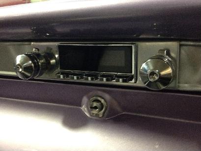

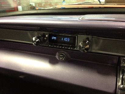

Here you Finny. Looks sweet eh? i got the chrome face with chrome buttons and ordered the 57 chev knobs. the knobs are not plastic either, they are chrome plated die cast and feel nice and solid.
The only thing I cut was my old DIY aluminium blanking off plate which i turned into a new fascia. and gave it a bit of a polish.
if you do want to buy one of these you will need to make your own fascia as nothing available with the dial offset to suit FB EK
best to use a length of 50mm aluminium flat bar and cut your own holes to suit (you can get a 2ft length from local red and green hardware store for about $15)....i did file about 1mm off the top edge of the rectangular radio dash opening....i dont consider that as cutting holes. :vecctor:
the nice thing about these radios is the knobs are totally seperate from the radio unit so you can put 'em anywhere within cable length (and you can get cable extension piece as they use a 4 core telephone cable with the little acrylic plugs to plug in), theoretically you could stick the knobs in the boot if you really wanted to. :ughh:
