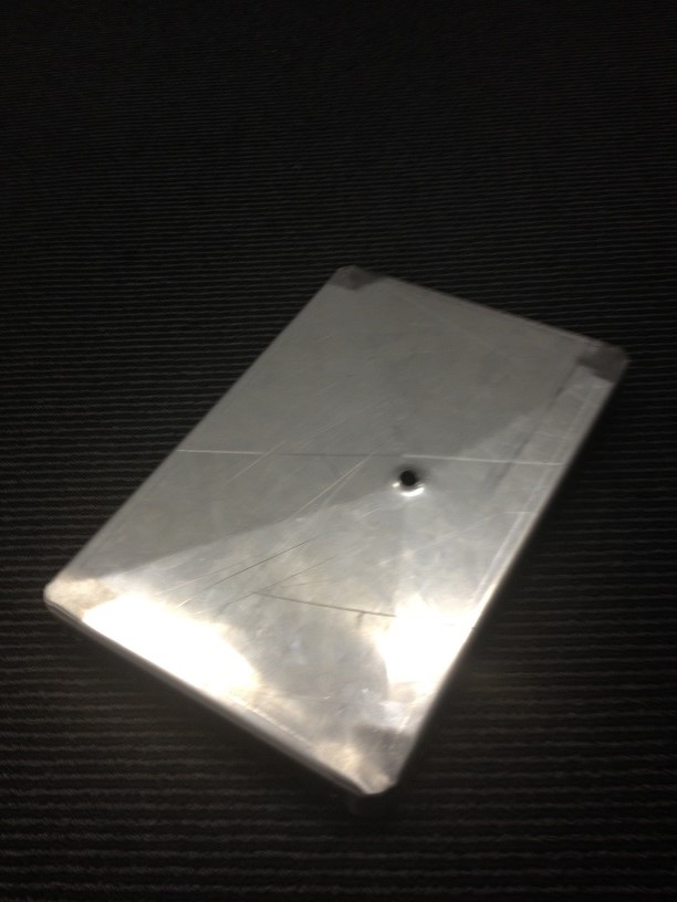

Took delivery of the new battery tray today
this one is 2mm stainless steel so it'll , pressed with drain lines and drain hole, fxing holes at ends and 1 at side.+ i also requested additional hole at side for battery retaining rod as per my old battery tray. Not sure if its stock hole or a later addition. Corners are rounded for fitting into stock heat guard but had them welded up full height at the sides to contain battery spills etc... i think it looks better than stock this way. Cant wait to get home and test fit. i think i'll file down the welds some more at the corners and give it a polish on the exposed faces...pity its hiding under a battery c's it sure is pretty.
Happy to make more for others wanting one....not sure of cost yet as will depend on quantity but if you want one please let me know and i'll order a batch to be made.
had this one made in stainless, but can also be made in steel (not sure why you'd want one in steel when stainless is an option)
i'll take additional photos fitted.

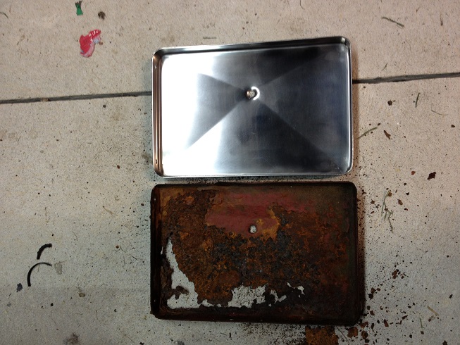

New and old side by side.
i managed to get a chance to replace it last night.
unfortunately ran out of battery on phone an ddidn't get a photo of it in the car....i'll take photo of it installed next opportunity
