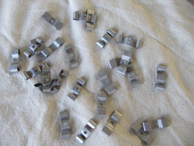

By Christmas I was pretty much over things so decided to take a good break during January. I did make a start on the stainless and some badges.

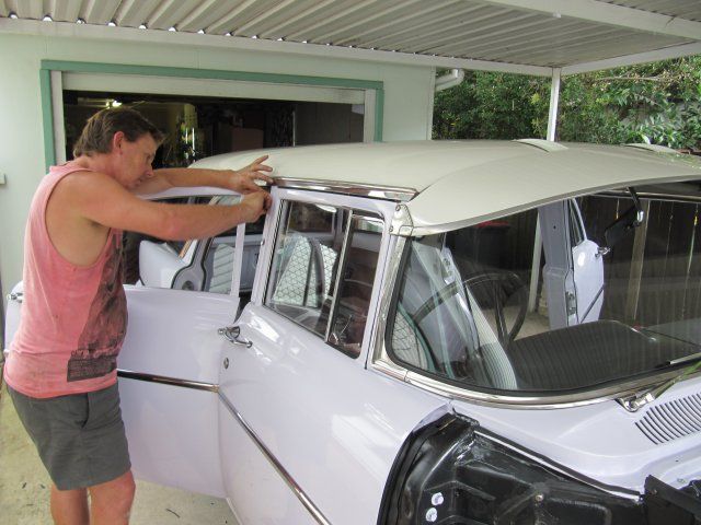

These clips come from Sam Crupi and are for the stainless door trim. Top stuff.
Polished up the stainless with a loose leaf buff and grey compound.

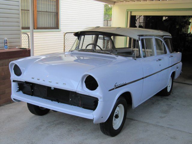

Re: Rebuilding of Old Timer (EK wagon)
Then to top it off Dave dropped in and before I knew it the front guards were on, stone tray and bonnet. Thanks guys.
I took a leaf out of Wayne's book and grabbed the camera. :P Hard work but someone has to do it... :)
And here is Saturday's effort...
8) 8) 8) :thumbsup: :thumbsup: :thumbsup:

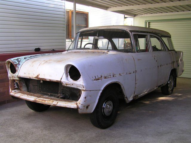

and here's a reminder 'before' shot...
