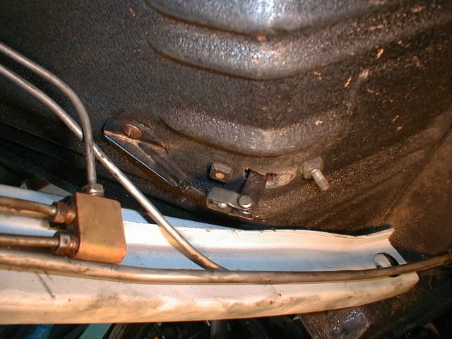

Have any of you guys got photos or more details with regard to the cable/ pedal setup cause I am also going down this same road.
HEMI
Posts: 86
Joined: Fri Aug 12, 2005 8:37 pm
Location: BADELAIDE
Post by HEMI »
Hi PEARO hope this helps.
I like this mod cause it uses the original pedal and you can run the cable through the bulkhead with the choke cable.
Think its off a 80s model, grab a spare and keep it in the boot.
Regards HEMI[/img]

Post by PEARO »
Thanks HEMI,
That looks as simple and neat as it gets. Thanks again for your quick response you have saved me a lot of mucking around.

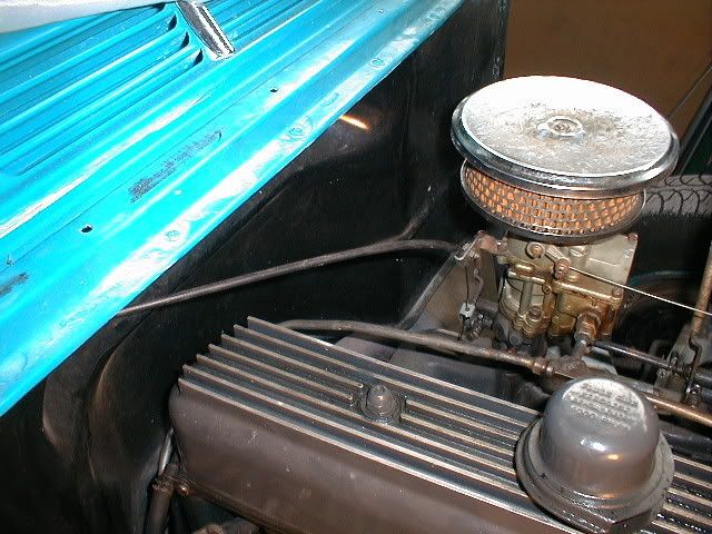

heres the same cable setup, but for the 4bbl - thanx to HEMI - for hooking me up!!!:wink:
Mitsubishi L300 van cable - $10 :wink:

I am having trouble getting the carby (2 barrel Holley) to reach full butterfly travel (fully open) was wondering if I need to extend the pedal lever ( where the cable links to the pedal) which would give me more travel of the cable and allowing the buttefly to open fully. Did you guys have trouble with this.
MINT62
Posts: 840
Location: South Oz
Post by MINT62 »
gday rob
dont recall having much trouble when Hemi did my cable, but i was working on somthing else so only saw the before and after
the only thing i could suggest is making sure where the cable attaches on the throttle lever-of the carby, that it is as far to the left as possible
-which would also alow the butterfly to open more also
thats if yove got the same set up
the part im refering to is the brass cable holder thingy on the throttle lever - above pic - you could drill a hole further over and refit or get a new one
sorry im no carby expert
try sending Hemi a pm, he may be able to help you out
regards ray 8)
