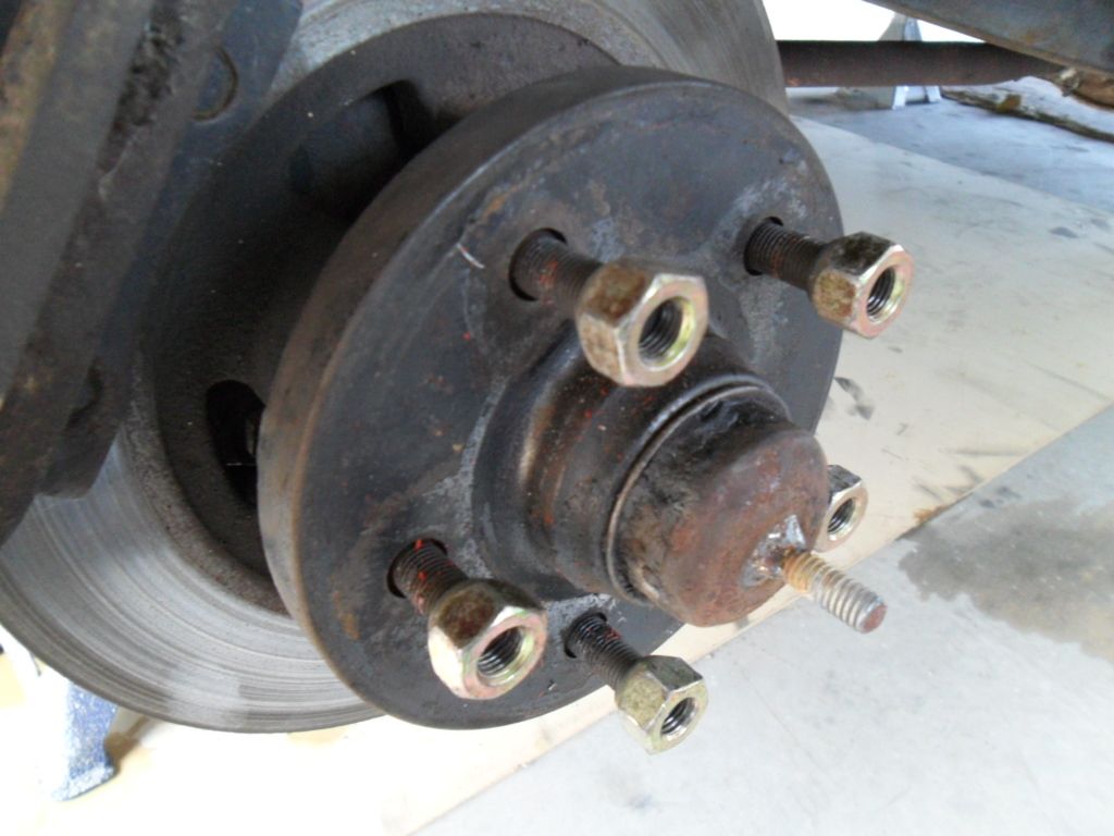

The caps I used are cast alloy and have a thread inside them like this:

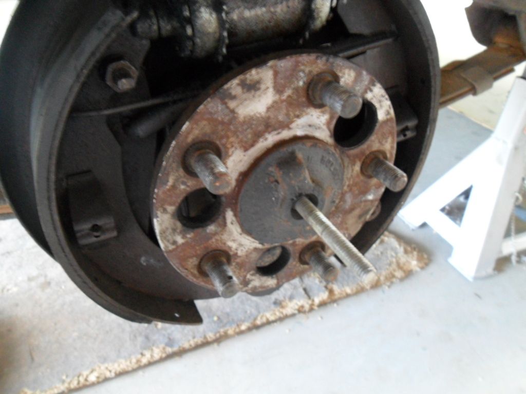

I drilled and tapped the rear axle to match the thread in the Bullet cap, then cut a peice of threaded rod to the right length so the cap could be srewed on after the wheel is fitted:

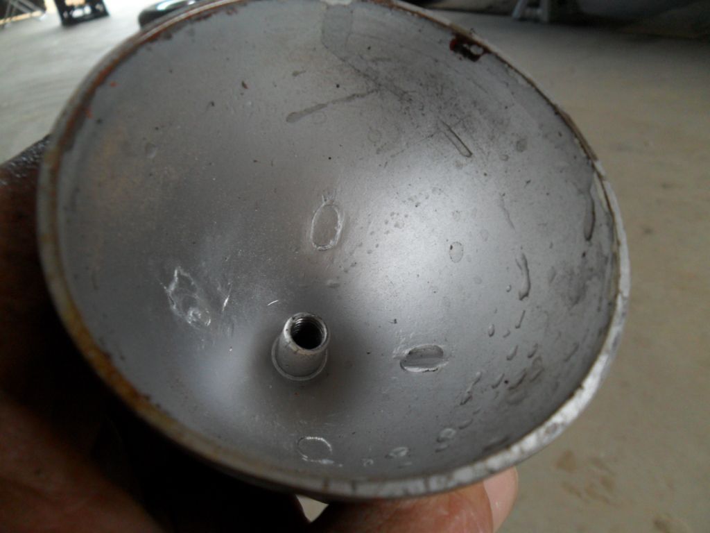

The front was the same idea but the threaded rod is simply welded to the dust cap:

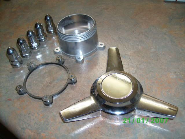

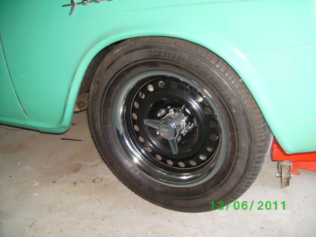

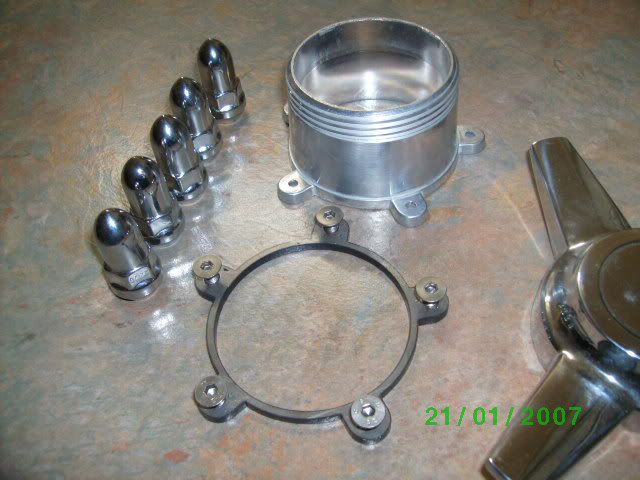

Heres how I got my 3 bar spinners on to 15'' &*#@ rims..got the drawing for the adapter plate done on auto-cad and then got them laser cut ...tack welded them to the rim centre .........Have got whitewall flappers to be be fitted soon ....Fingers
