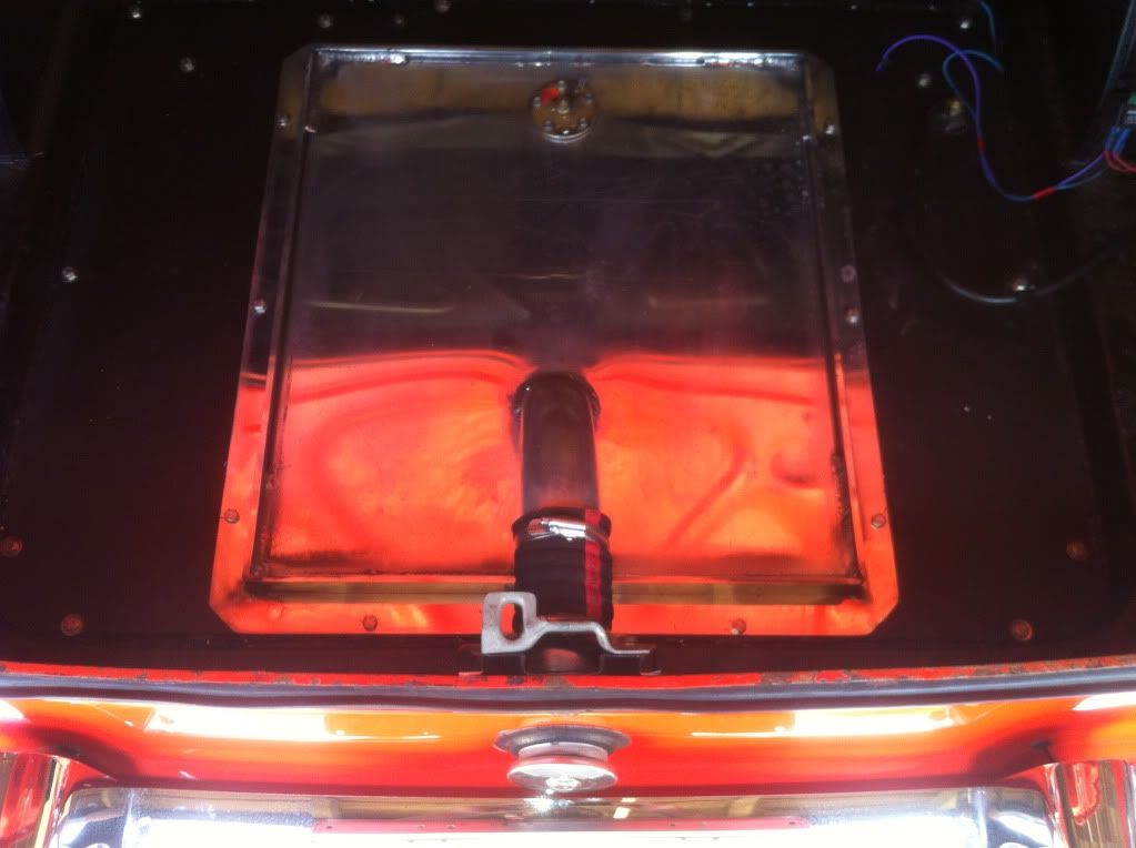

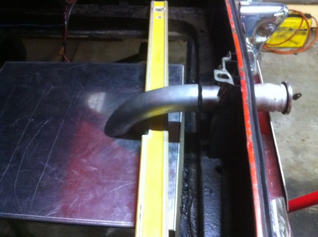

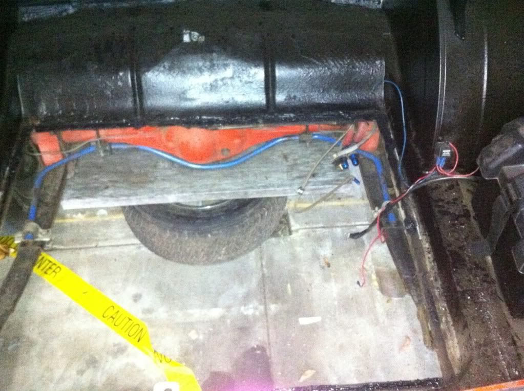

Okay so after having some fun at the drags it was time to get her ready for rego,
Had to get rid of this set up ,engneer said fuel must be filled from outside the car.
searsy
Posts: 629
Location: Lismore NSW
Re: testing
Post by searsy »

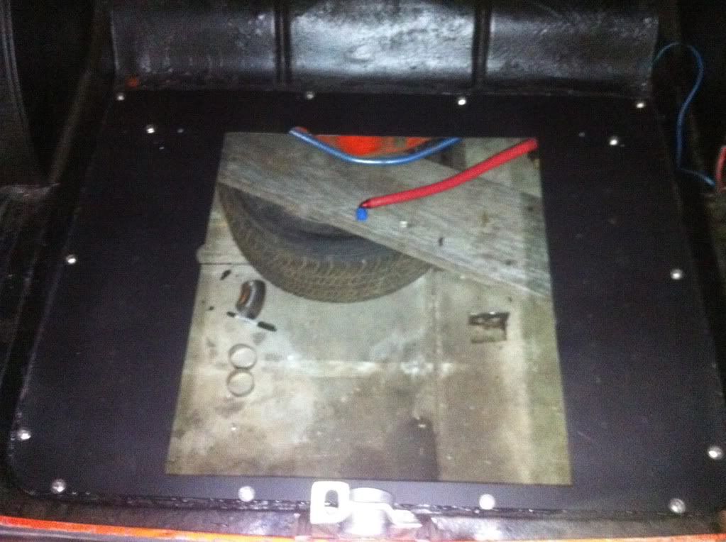

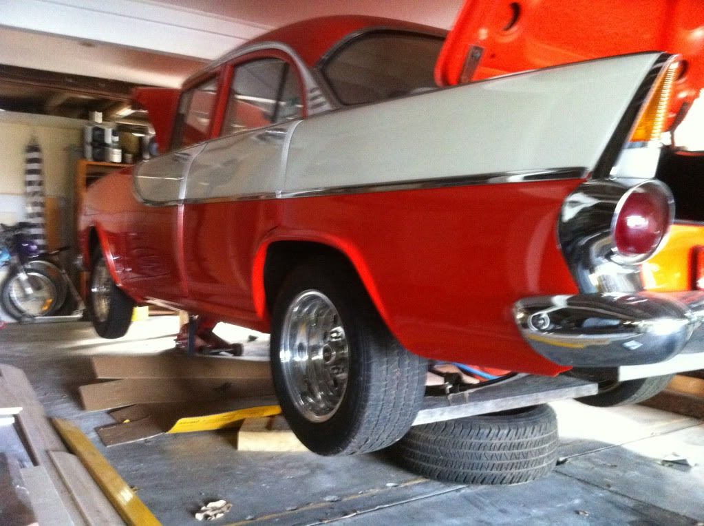

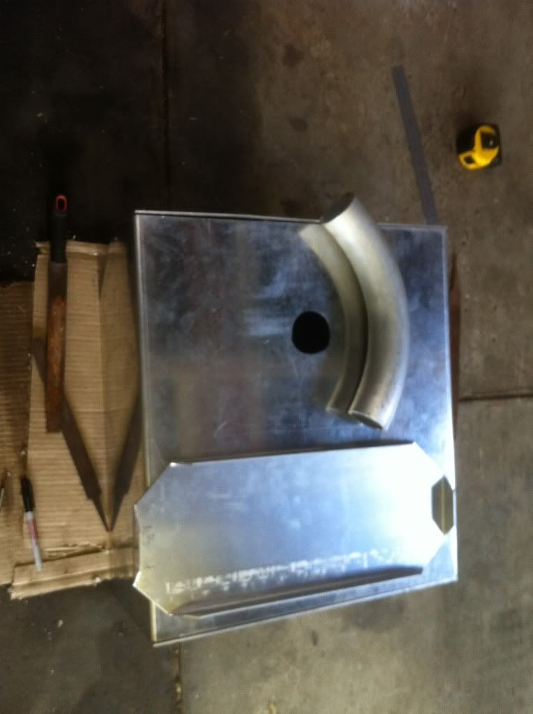

So time to put her up as high as i can, bloody house should be 2 foot higher.
then pull it to bits
bugger thats a big hole

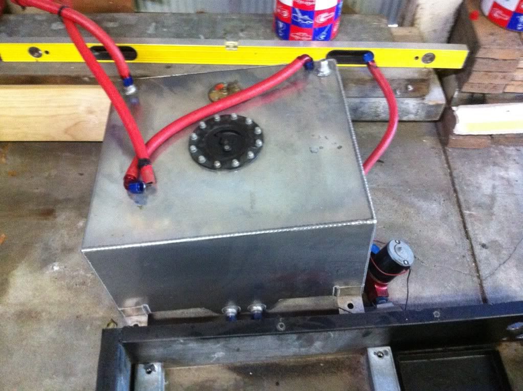

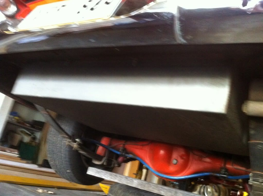

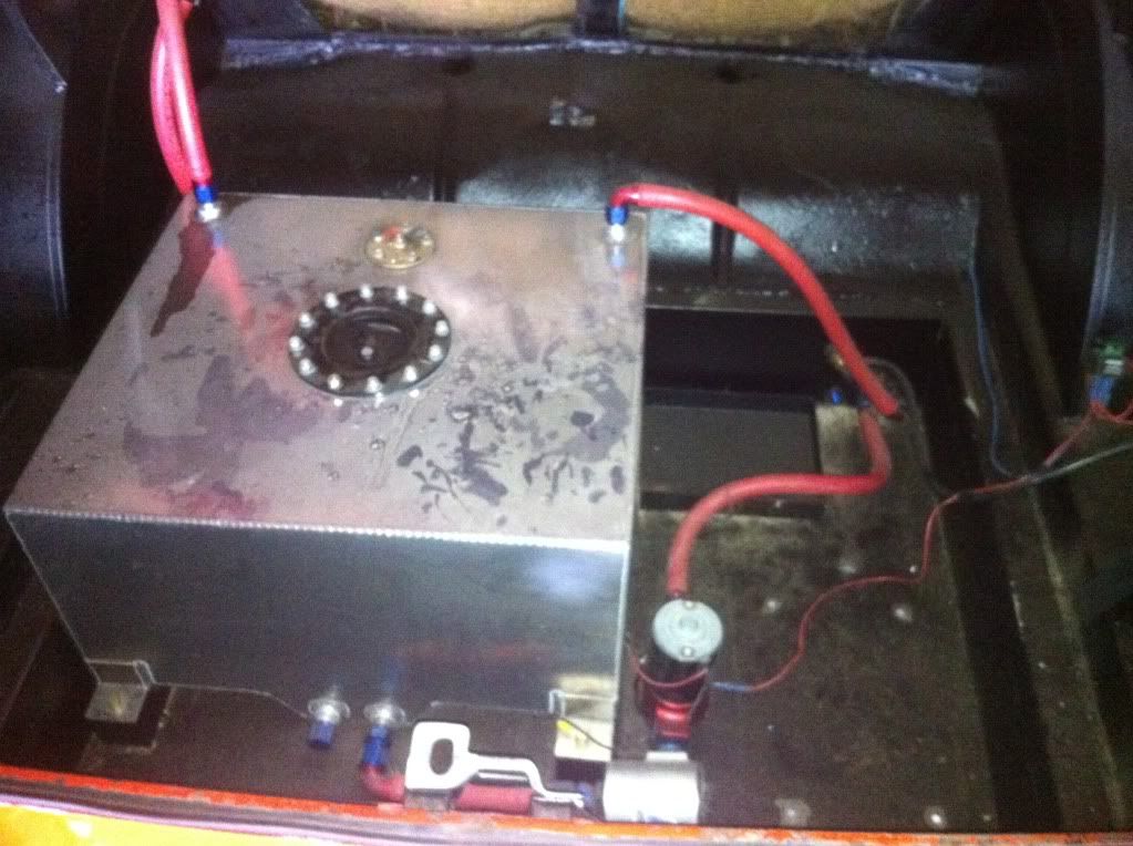

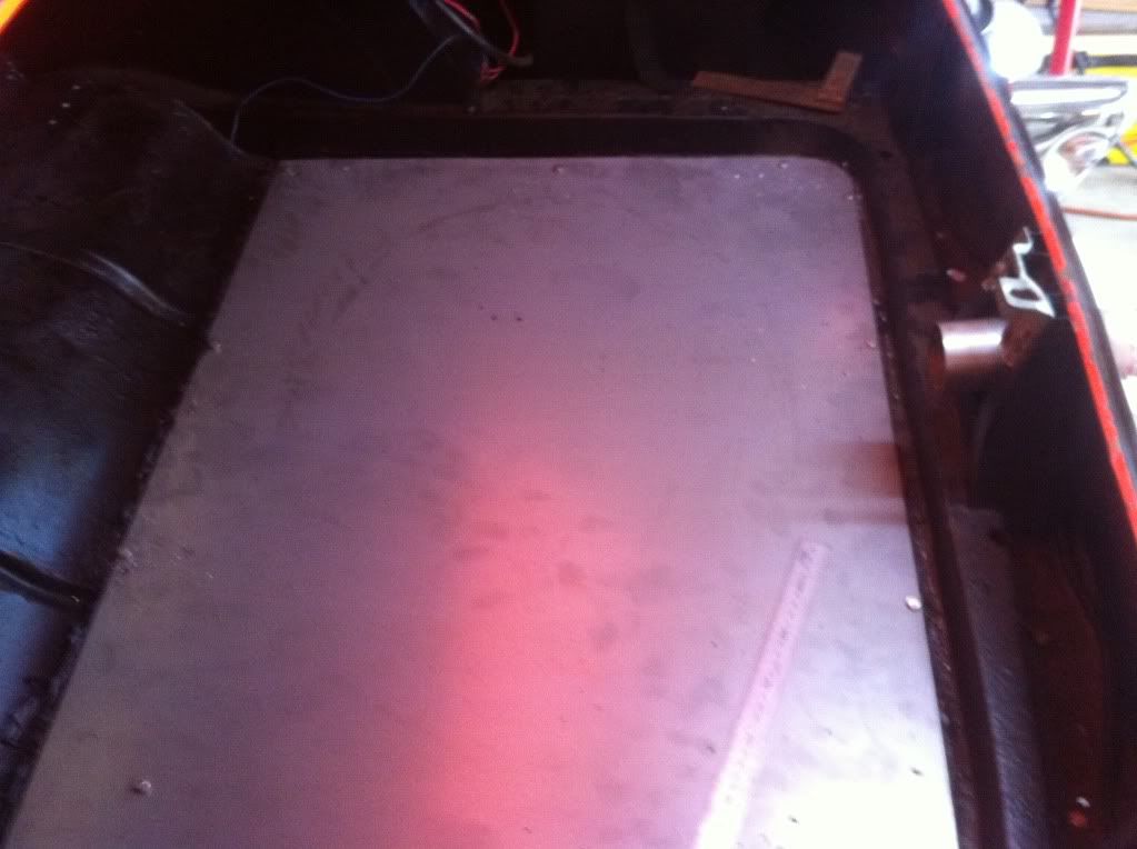

So I got some 2mm plate cut a smaller hole and made a small drop tank, I know some people dont like drop tanks but I was under time constraints and its only a small one 50 lts and doesnt sit down very low,
Stygian
Posts: 1274
Re: testing
Post by Stygian »
That's much more visually appealing :thumbsup:
searsy

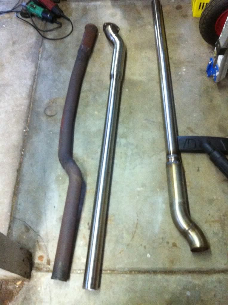

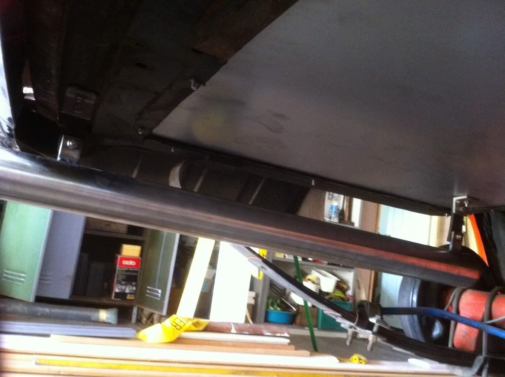

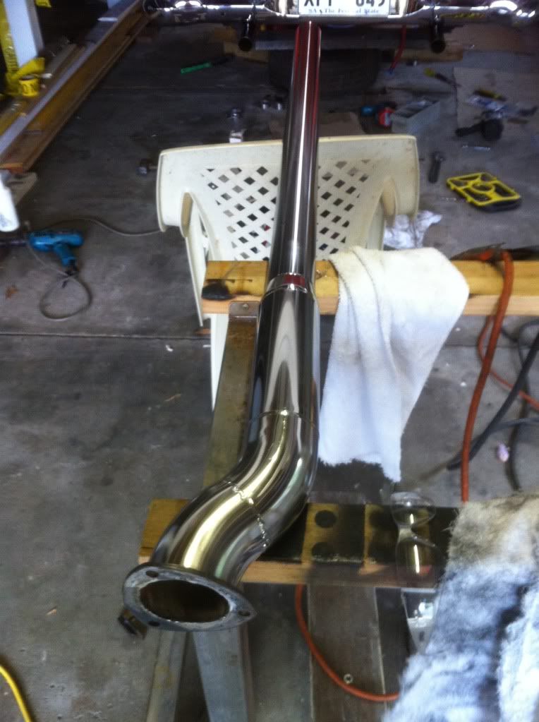

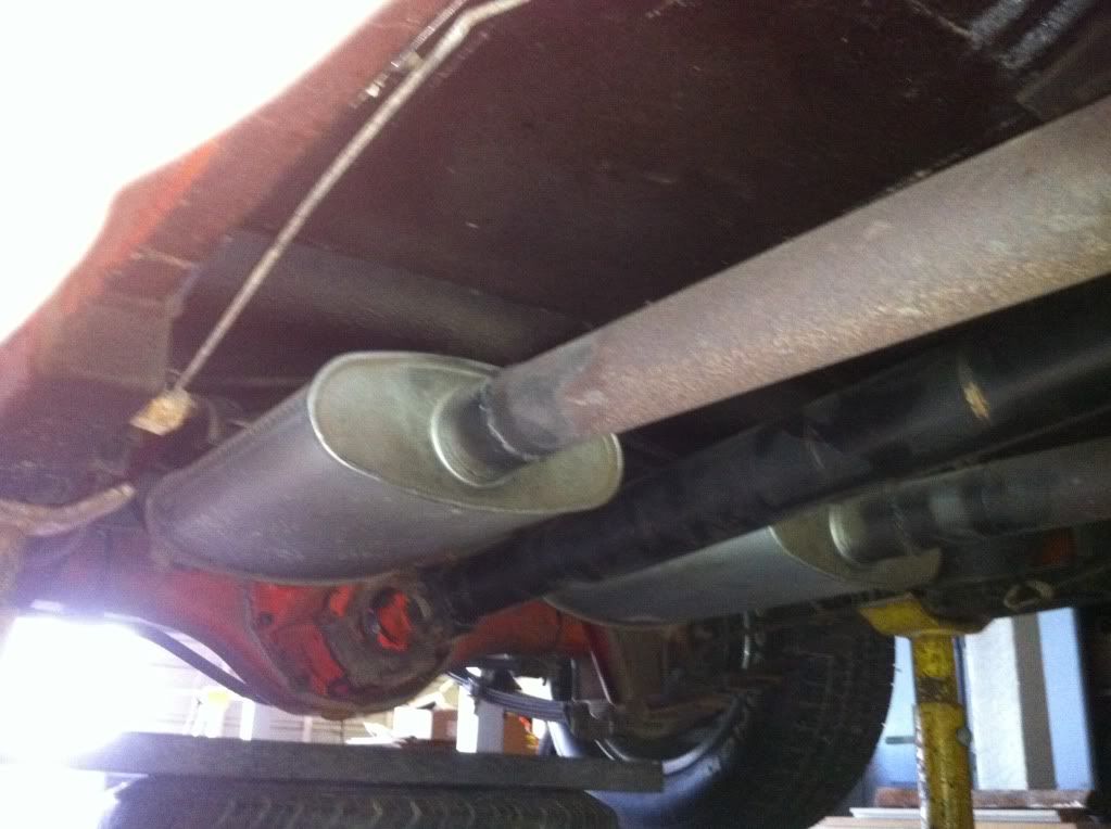

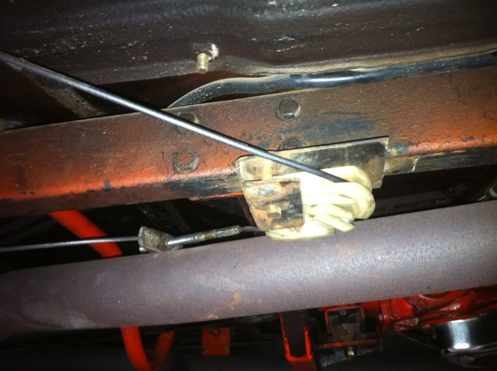

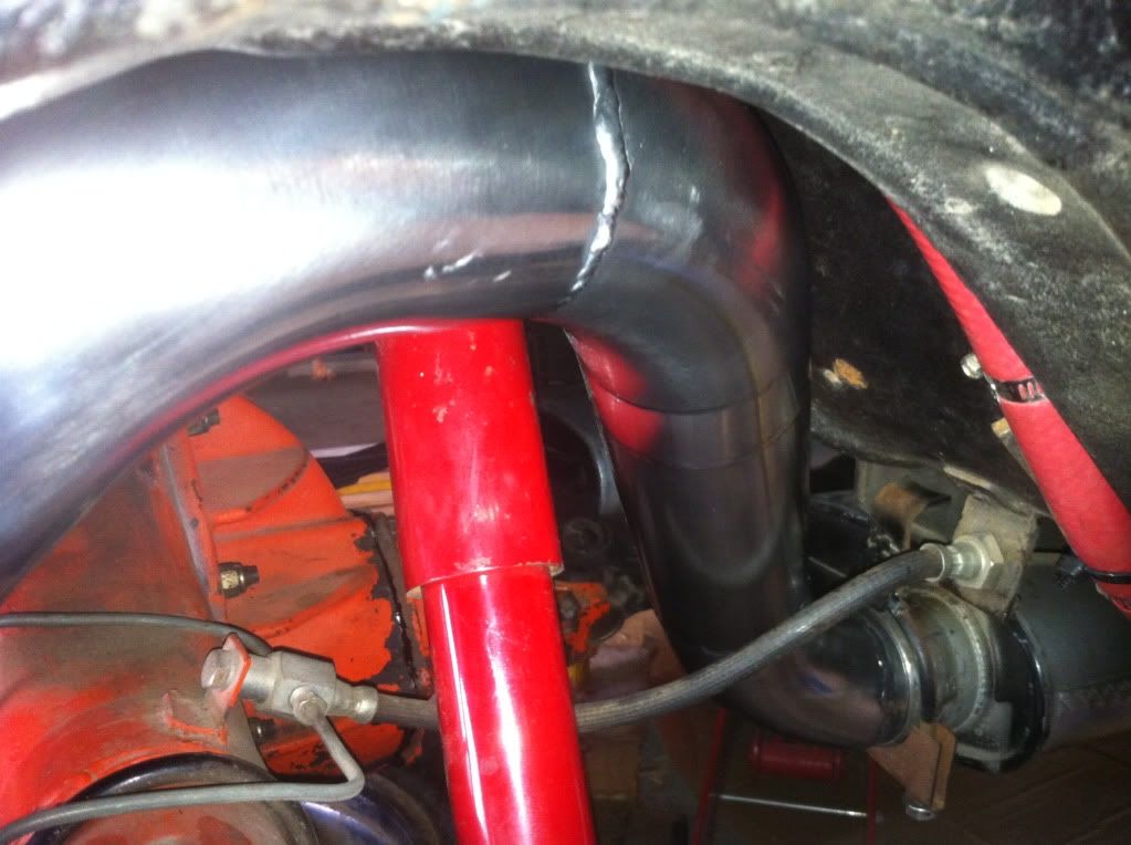

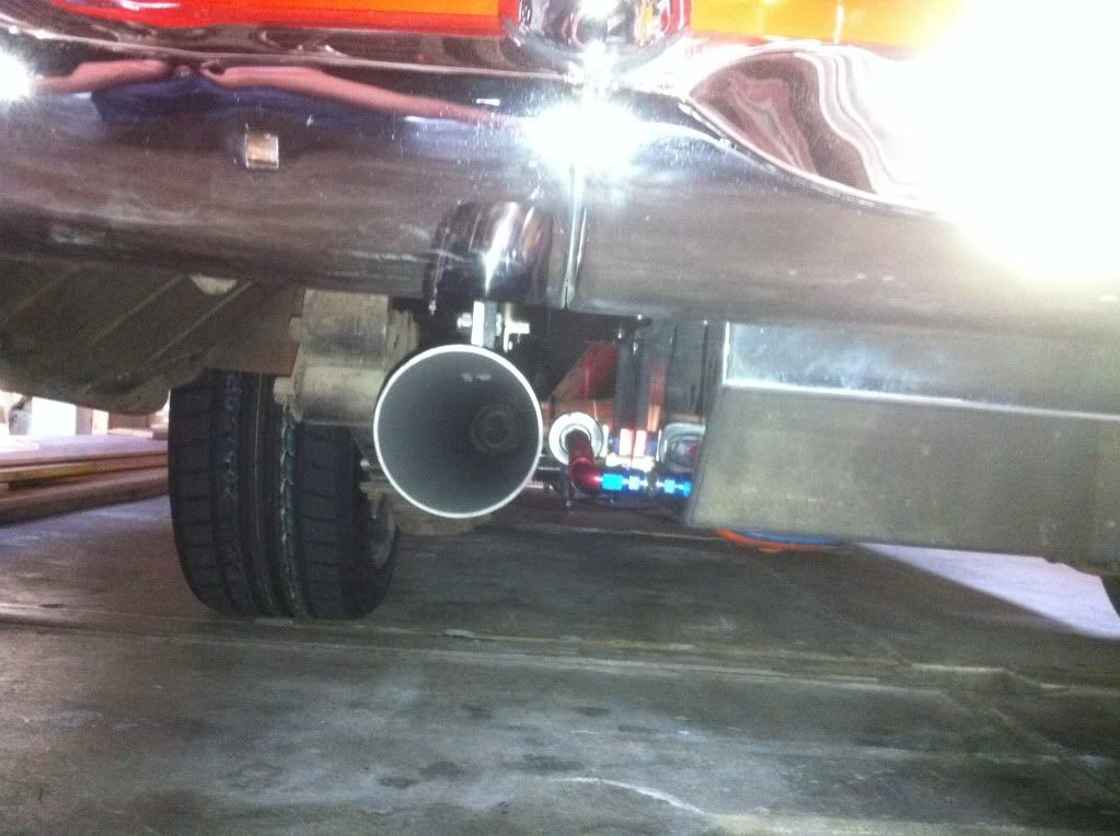

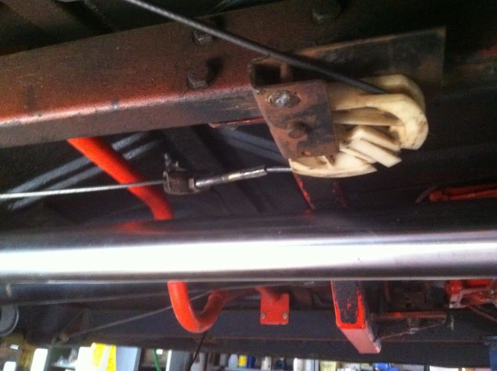

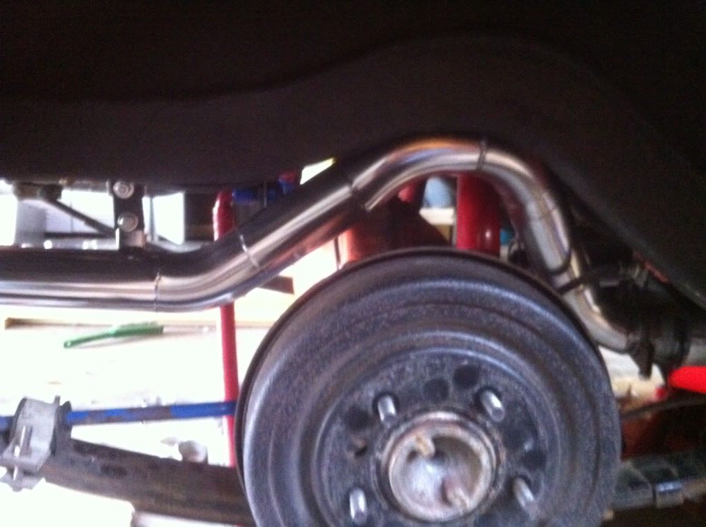

Next job was to get the exhaust out the back, also the exhaust was to close to the handbrake cable so I thought I would make a new one
more room around the hand brake area
And finally out where it belongs

Posts: 13477
Re: testing
Nice work :thumbsup: you do the pipes yourself ?

Drop Tank looks fine... :thumbsup:
