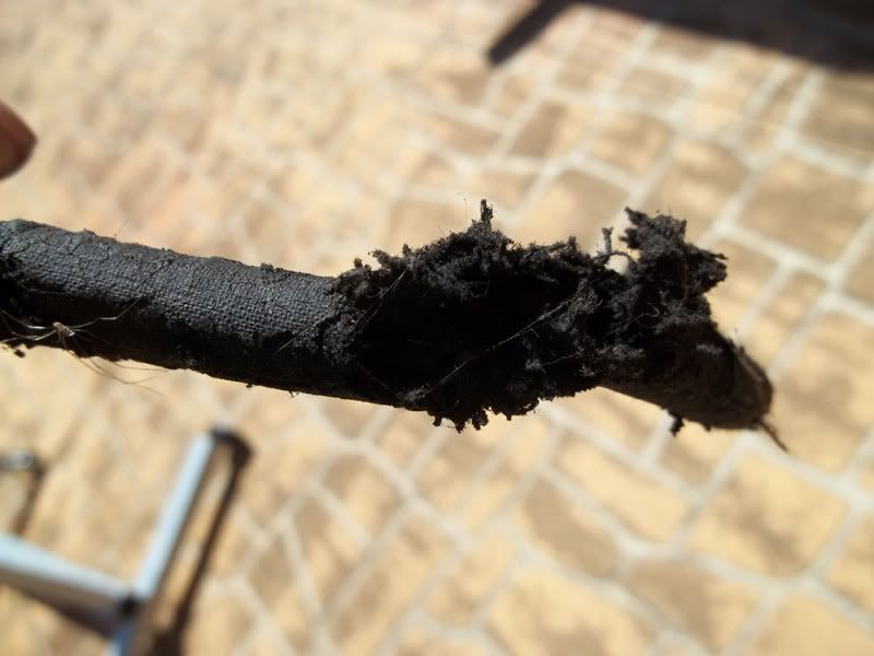

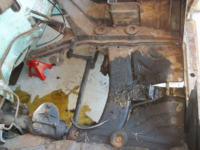

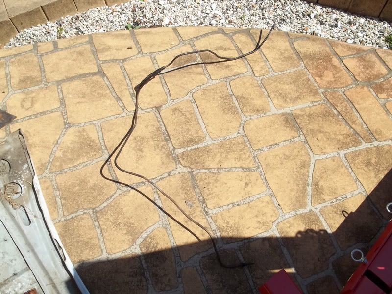

They left the vacume line still in it's a wonder the old girl went at all!
Check the hose!
The line was still running up to the wiper motor and not plugged either.

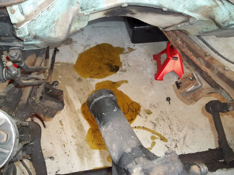

Transmission oil still bright. Forgot to plug it ..Bugger.

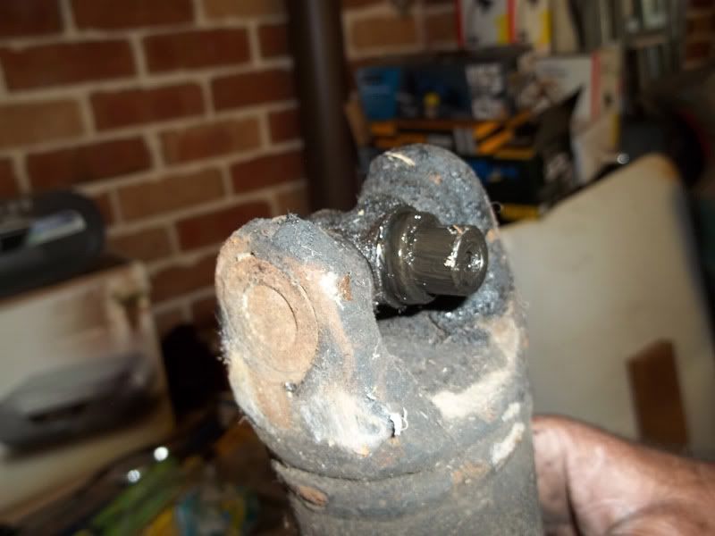

Back uni joint, not to bad.

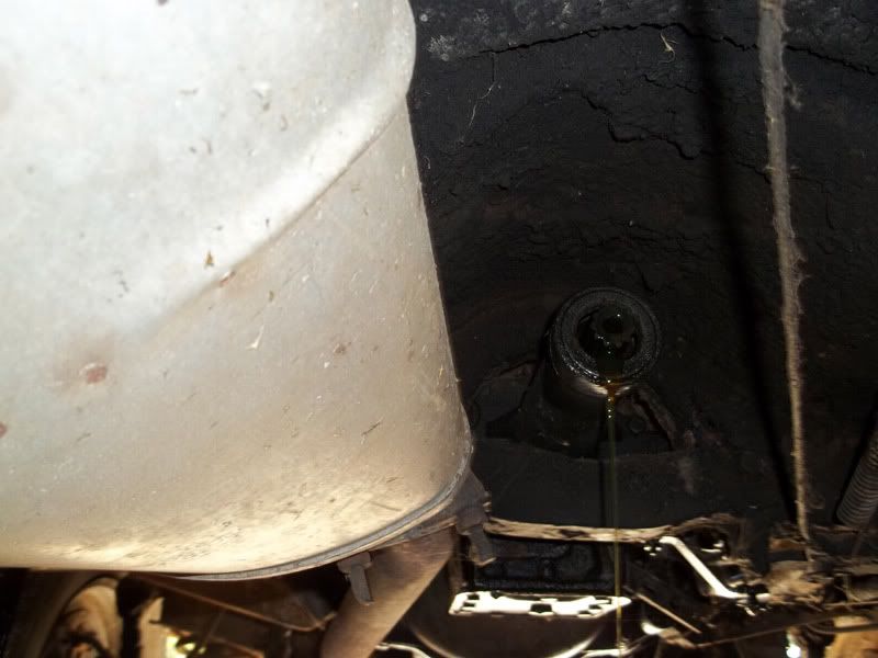

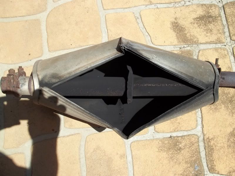

Exchust pile and muffler
Love to know what caused that Blowout?

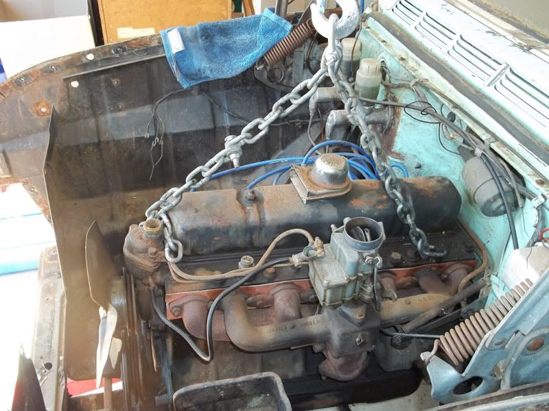

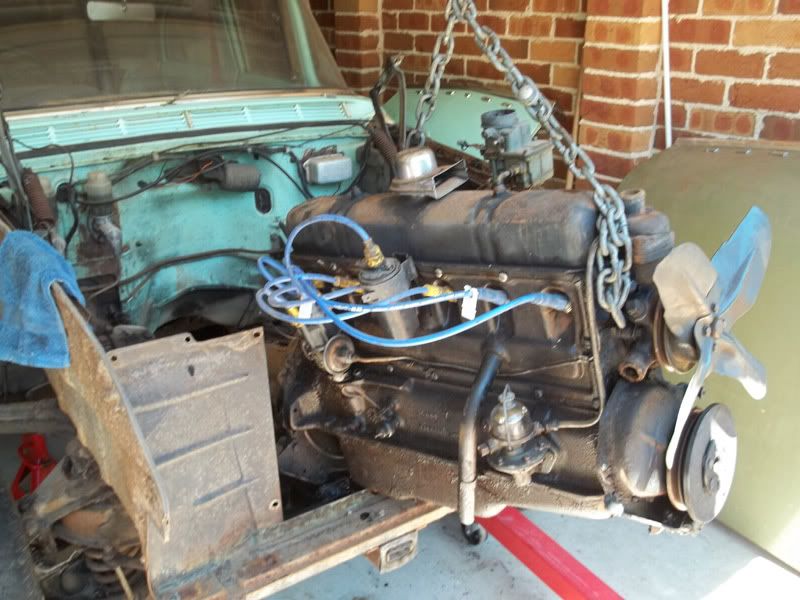

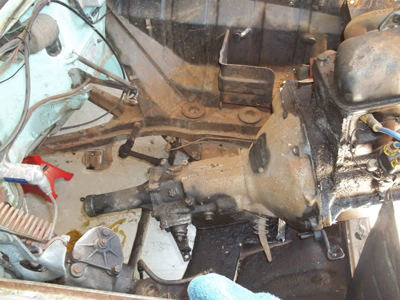

The gray comming out
Slipping the crash box out.
Love the smell of oil in the morning
She's free

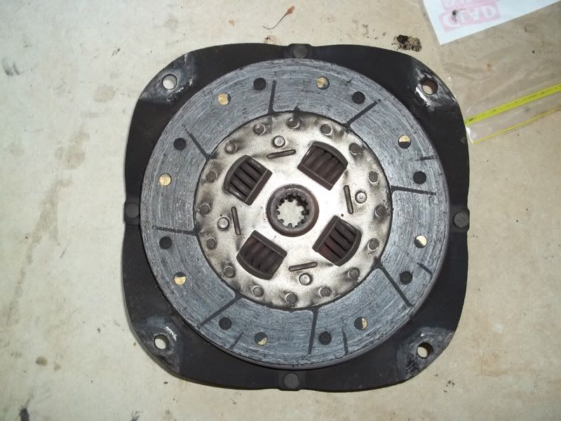

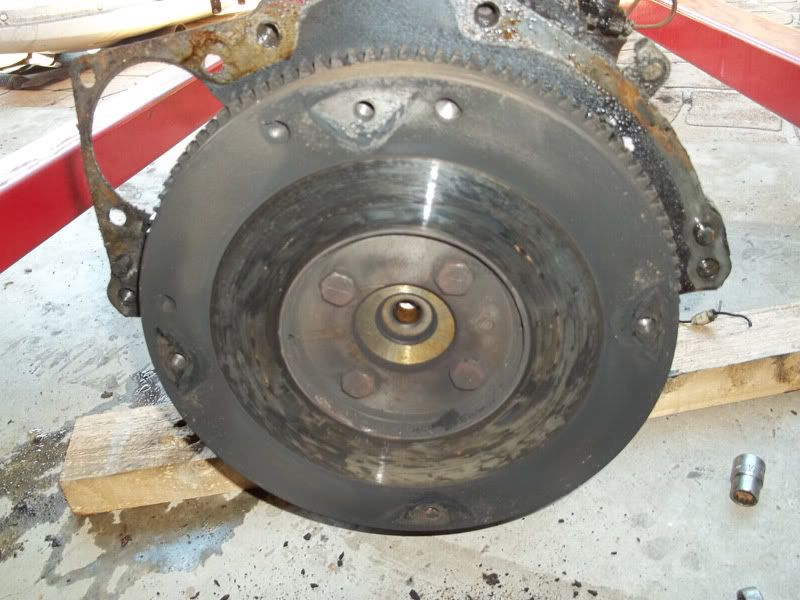

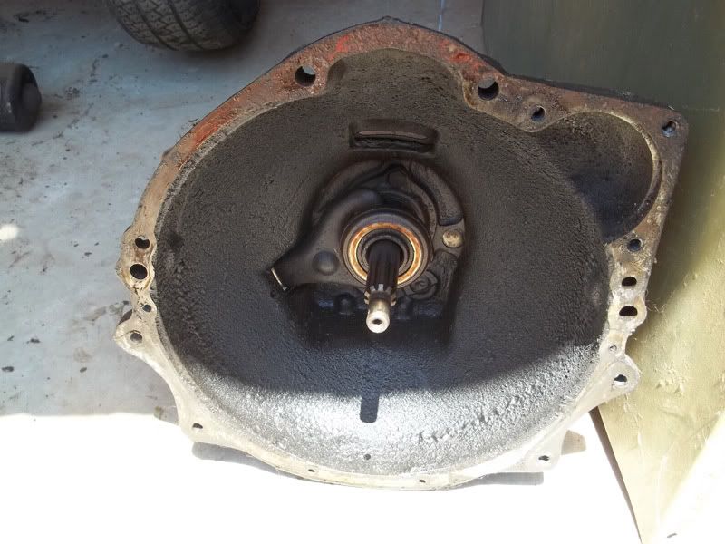

Crashbox needs a new bearing, so looks like a ovehaul kit.
No comment, you can see it.
Clutch has been running on rivits for a while!

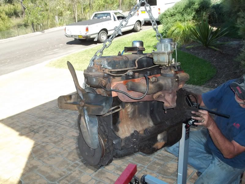

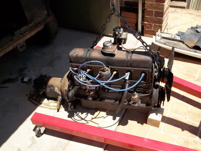

The gray on a engine stand and pushed to the back of the garage till another day.
Check the hose!

That muffler looks like it's taken a hit in the front causing it to split down the seam.
Re: Wayne with a 1961 FB
key bangers?
x2 as soon as i saw it i thought i've seen that beforebrowno wrote:key bangers?

It would have to be wouldn't it ???browno wrote:key bangers?
Crikey, I haven't done one of those for a whileBlacky wrote:It would have to be wouldn't it ???browno wrote:key bangers?

Well he only did it once...MeFB wrote:Crikey, I haven't done one of those for a whileBlacky wrote:It would have to be wouldn't it ???browno wrote:key bangers?Either the mother of all key-bangers or a spud up the tail pipe

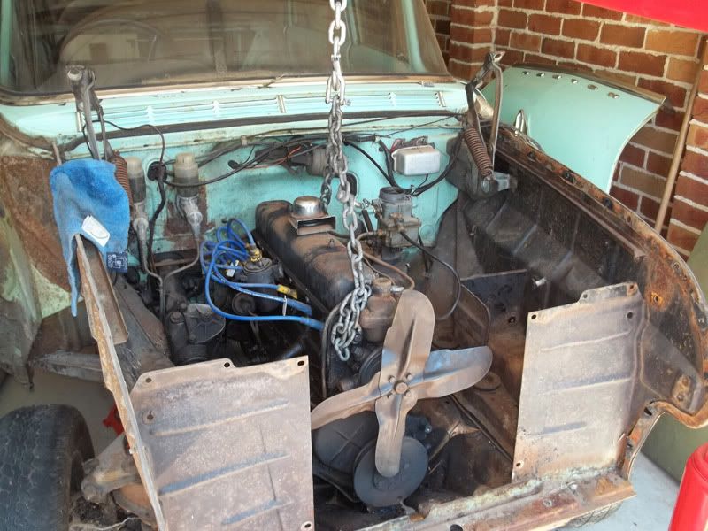

Update 04/01/2012
Well another hot day in the garage..pant pant.
I have taken around 900 pics so far so here's a cross section of them from today.
Just have to remove the doors, front and back windows, the side trim and wiring loom
and its off to the blasters in a week or two.
Using the engine hoist to hold up the front end while we get it out.

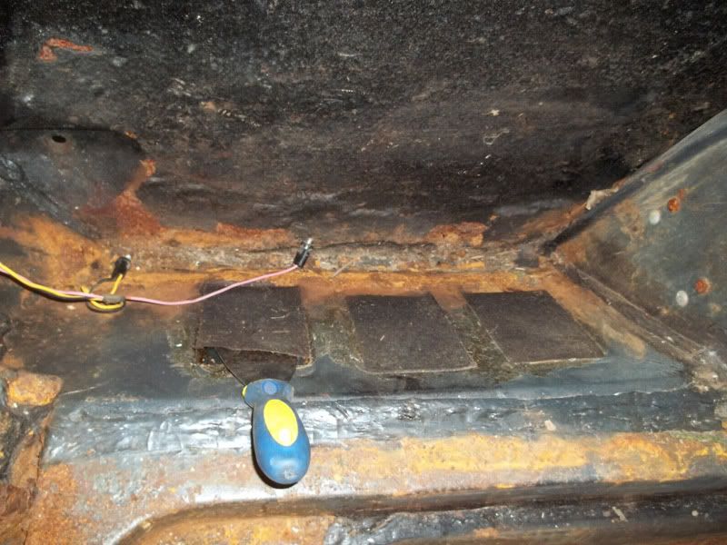

Mmmm lost screwdriver, wonder how long thats been there?
