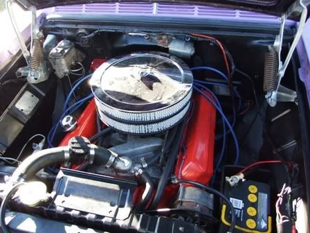

Just getting motor and gear box mocked up just working how to put pic's on this site

just working out were to mount brake booster .ute will be a daily driver so under front guard will it fail with dirt and water?

angela wrote:just working out were to mount brake booster .ute will be a daily driver so under front guard will it fail with dirt and water?
Looks like there is some serious engineering going on there :thumbsup:
I think most people put a deflector in front of their boosters to stop them getting damaged when they are under the guards. I've also seen boosters that are custom designed to go under guards and they are a lot more compact.

you'll find if you masage back the firewall a touch on the left side of firewall you can sit the motor back a bit more :thumbsup:

harry186 wrote:you'll find if you masage back the firewall a touch on the left side of firewall you can sit the motor back a bit more :thumbsup:
thanks mate info helped a lot don't want cut engine mounts off again but bit more room would be good
