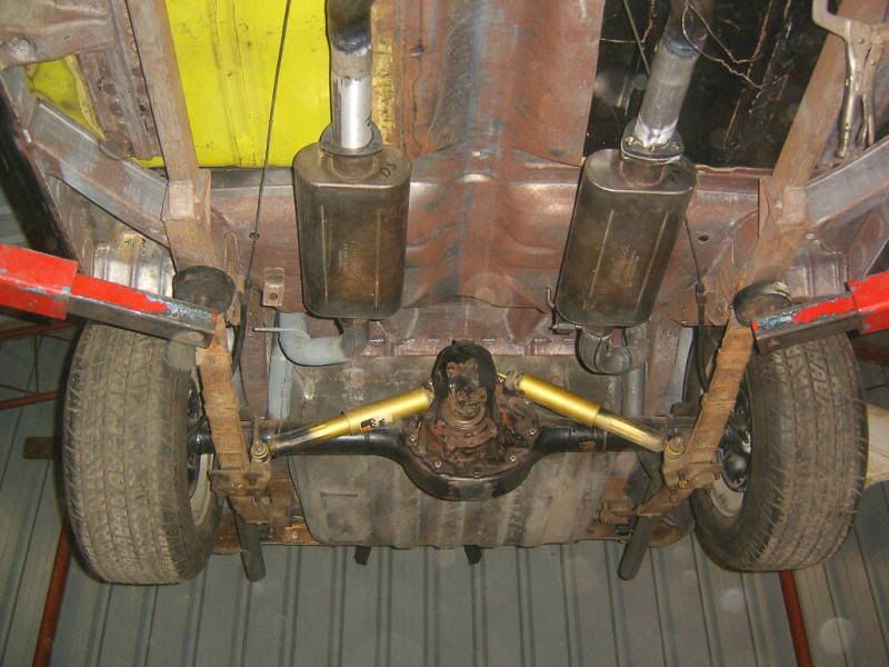

Posts: 4307
Re: Helenor
could you possably run the exhaust over the diff then outside the springs so the tailpipes come out directly under the tail lights (that's if you want dual exhaust) old tip :wink: from memory i think it was XC fowlcan tailpipes (which go over diff and outside spring) fit
Cal
Posts: 2796
Re: Helenor
Post by Cal »
I did the same with my XD. All the experts were telling me you couldn't run dual exhaust on XD's (as in a pipe on each side) because of the tank. It was a tight fit, but I ran the pipe on the outside of the leaf springs.
I think the XC ones were more centred, Mick.
Posts: 2515
Re: Helenor
Yeah,
Not the best photos but this is how I've done my tailpipes
You car is looking grand Scoobb.
I have a XB Fowlcon sedan tank so there is no room along side it. Over the top of the springs is the only way to go.
Posts: 4307
Re: Helenor
that's exactly what i was talking about greg, they even look just like the tail pipes i was talking about :ewink:

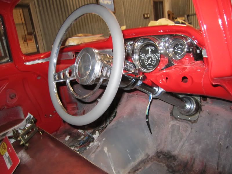

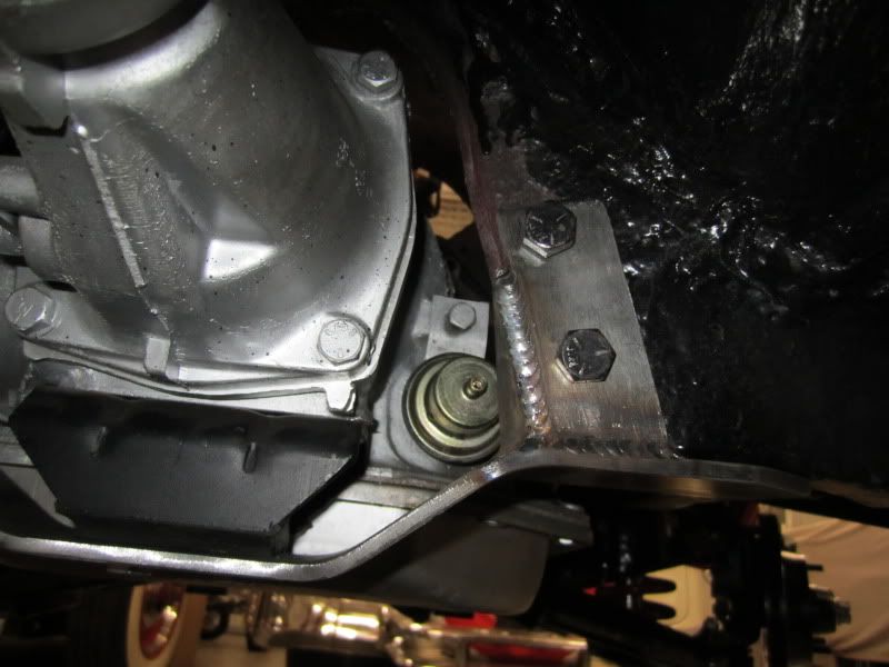

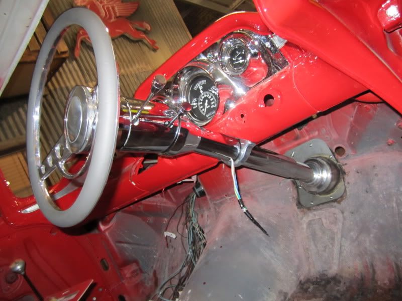

Boot false floor nearing completion
New steering column in
New fabricated gearbox mount

Re: Helenor
Looks like the column is too long?
Can it be pushed through the fire wall a bit more?
