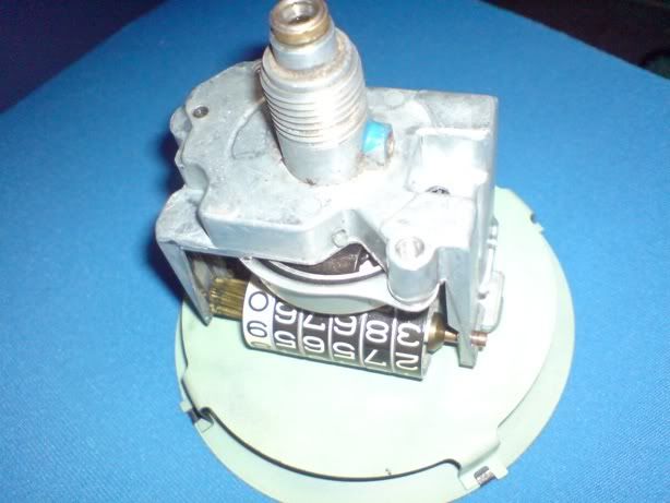

I've pulled it down as far as is easy (I'll add a pic in a moment).
However it doesn't look like it wants to pull apart easily any more. I
can see there are crimped areas on the chrome surround. Do I have
to bend these out to get at the inner workings or is there a trick I'm
missing?

Do these just bend back?
Note the steady hands of my niece :) she makes a great parts stand heehee :)

Right I got the casing off and now....
There seems to be something binding or catching the shaft as it tries to
spin. Maybe just a bit of dust / grime / age related muck? The shop
manual says if there is a prob send it off to a specialist to have it fixed.
Sigh. Anyone a specialist speedometer repairer?
I'd love to pull it apart and clean it but I don't want to stuff it up.
Any tips?

FB search wrote:Do these just bend back?
Firstly yes they do. I've had mine apart several times :x Only once was it a good reason...
Secondly my speedo has been doing all of the above, noisy and inacurate as all hell when I first drove the car. I disconnected the speedo and left it for a while. I then pulled it and cleaned it all hooked it up and it seemed fine. Checked its accuracy with a handheld GPS and was surprised by the accuracy. Then for some reason it started sticking and for around 10 mins of driving it would stick then come good. I have since checked the speedo cable to make sure it is not looped too tightly and found it was a little too tight for my liking where it went into the box. Since then its been fine :?
Fingers crosssed that was all it was. It may not help anyone but does give you a few more things to look at, also check your speedo cable for binding.

Thanks Devilrod,
I got it open but not sure how to pull it apart to get to the bit that's
binding. The cable seems to be ok.
I'll persevere for a little longer before looking at buying another one.
:mrgreen:

Hey FB search
There are a total of 8 screws and 1 retaining clip that hold the assembly together.
It is not too difficult to totally disassemble. Just be very careful with the drag cap return spring.
Start at the front - take off the font dial first by unbending the holding tabs on the side.
See my post -http://www.fbekholden.com/forum/viewtop ... c&start=15
Good Luck :D
