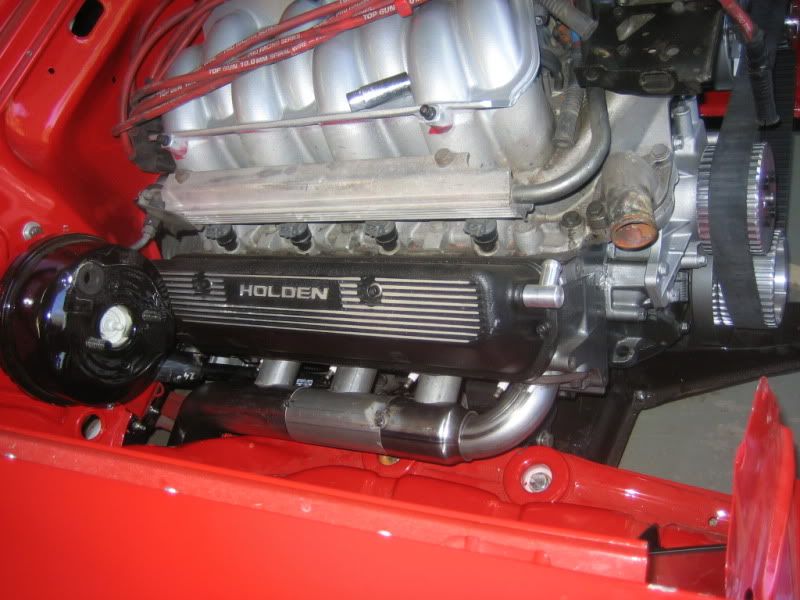

Decided to finally get my finger out and work on the old girl again, got a couple of mates around to help and spent most of the day making log headers as per Gary (V8EK4US). Thanks Gary.
here are a few progress pics.

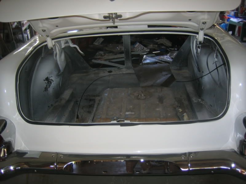

Fit the boot rubber
No exhaust shops open so had to get these from truck supplies
work space
cut off old extractors
not the best view :lol:
site manager 1
Site manager 2
mates working
tacked up ready for final welding.

Like basic.green's FB, there's something about this car which makes you just want to keep looking at it... probably the excellent choice of colours, styling and finish...8) 8) 8)
Really good that you have gone to the trouble of making your own headers which avoids the cutting of holes in the skirts (I really don't like the look of that with V8 modifieds)....

Great progress SC00BB! It's good to see you use the log header idea, it looks like it should be there not like the CRS headers that you have to hack the inner guard out for. Performance from the Log header is actually better than the CRS style as it flows much easier, nice job on them they look great, are you going to have them Jethot coated? The coating looks good but also helps reduce the engine bay temperature. How did you go with the handbrake cable clearance on the header? I relocated the hole on the firewall up 20mm and relocated the pulley in the engine bay to give more clearance (you may not need to do this with the Holden V8).
