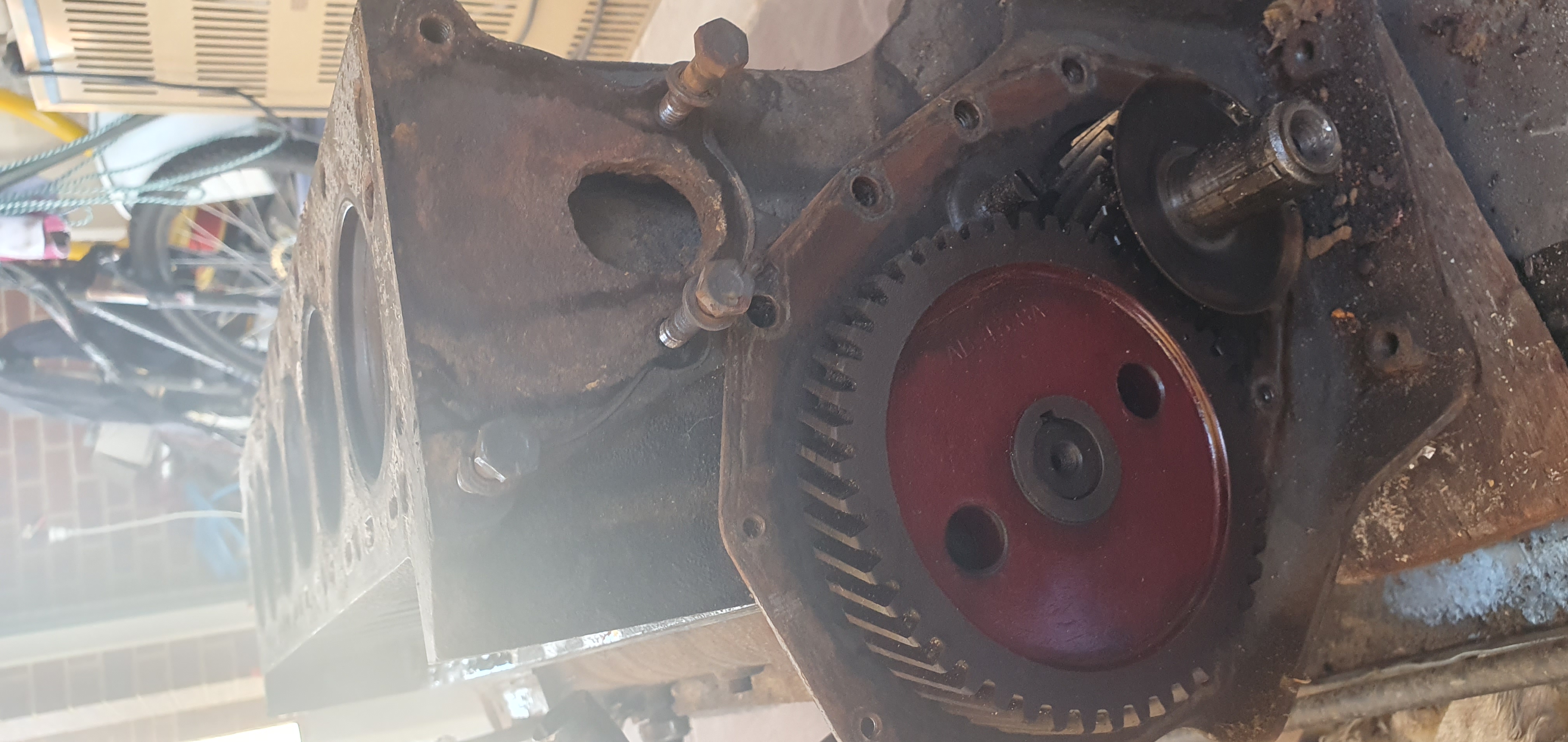

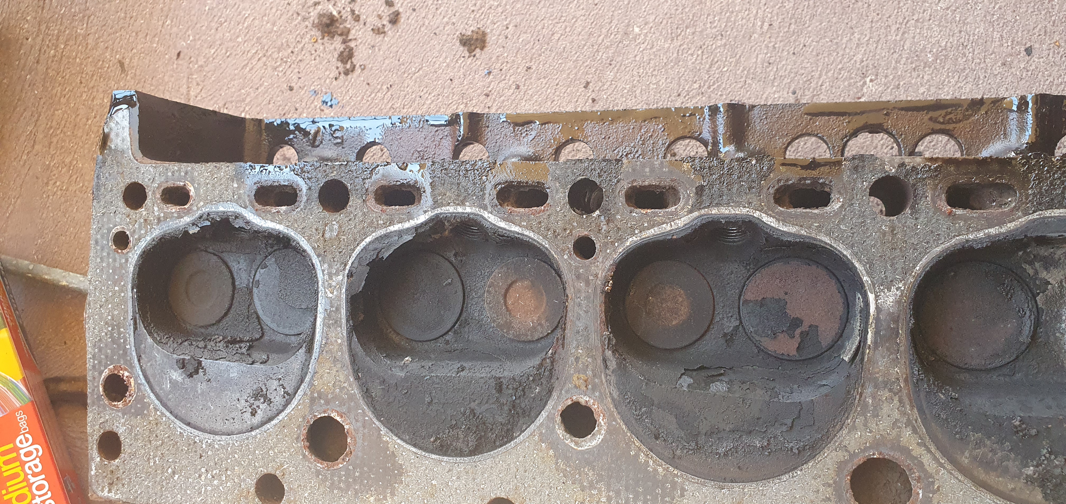

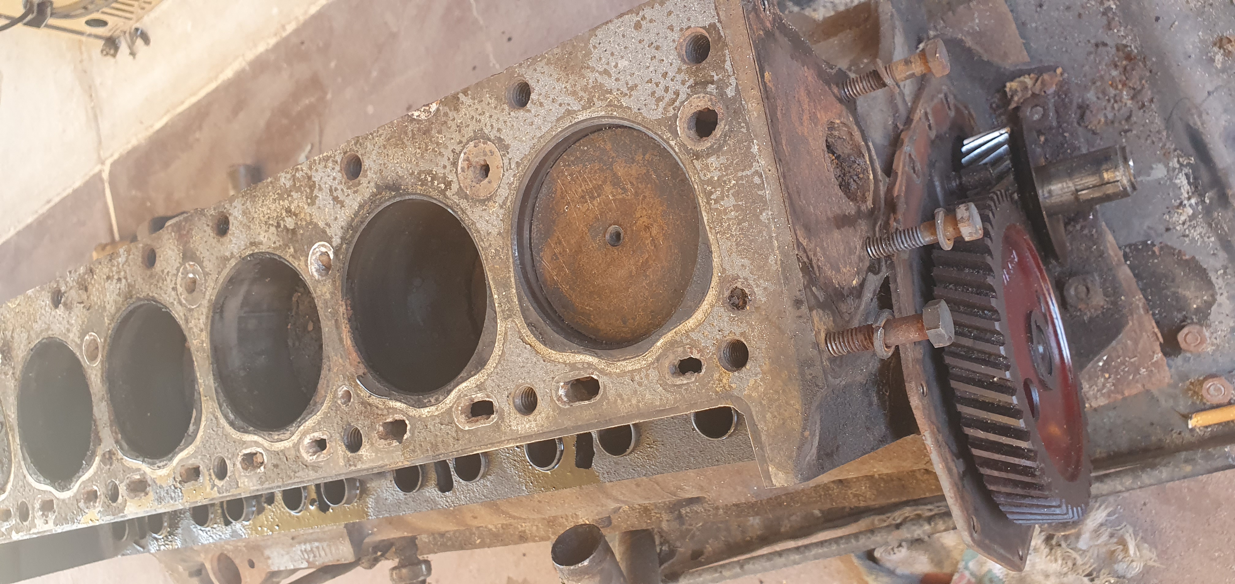

Re: Are you Bored? Bang for Buck Engine recipe required.

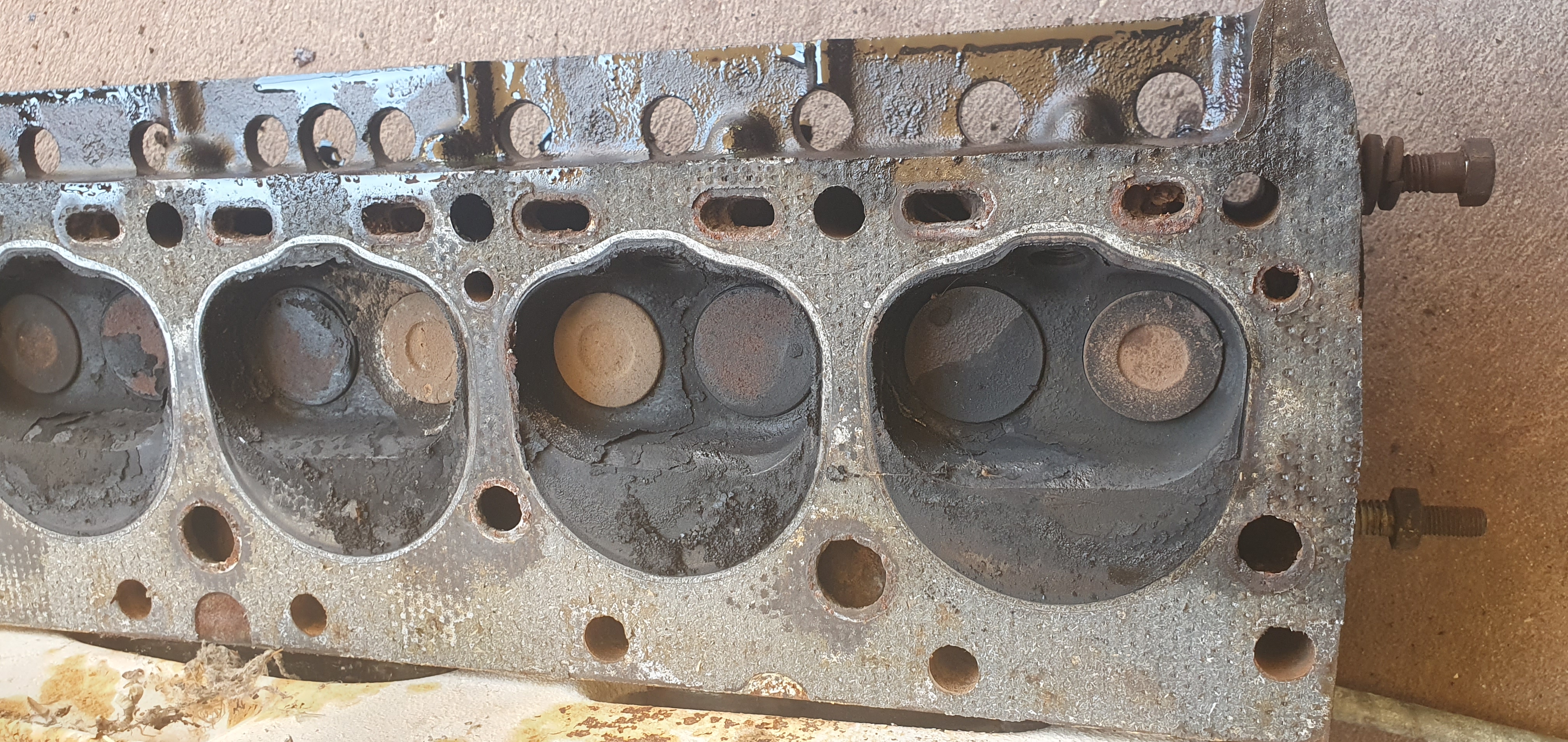

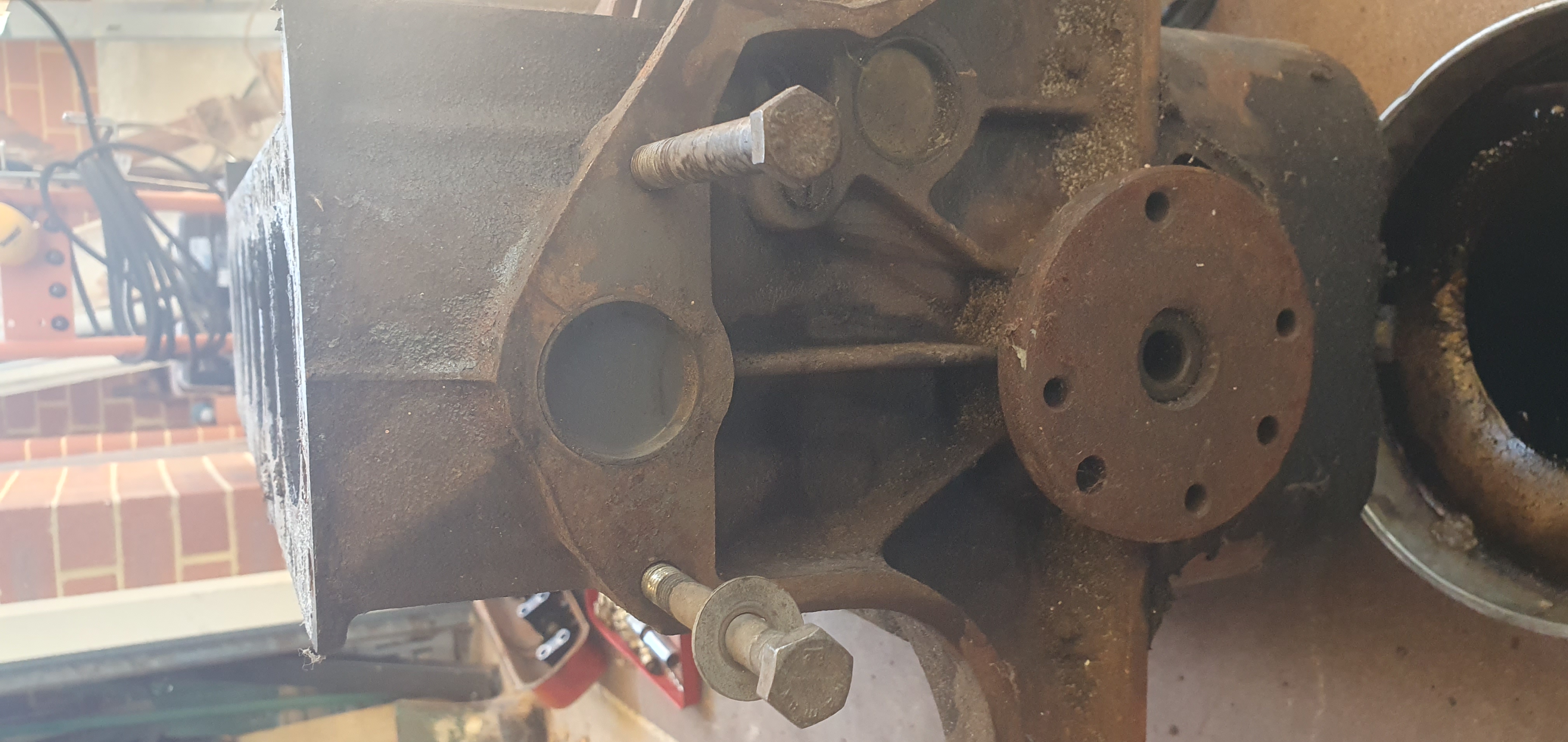

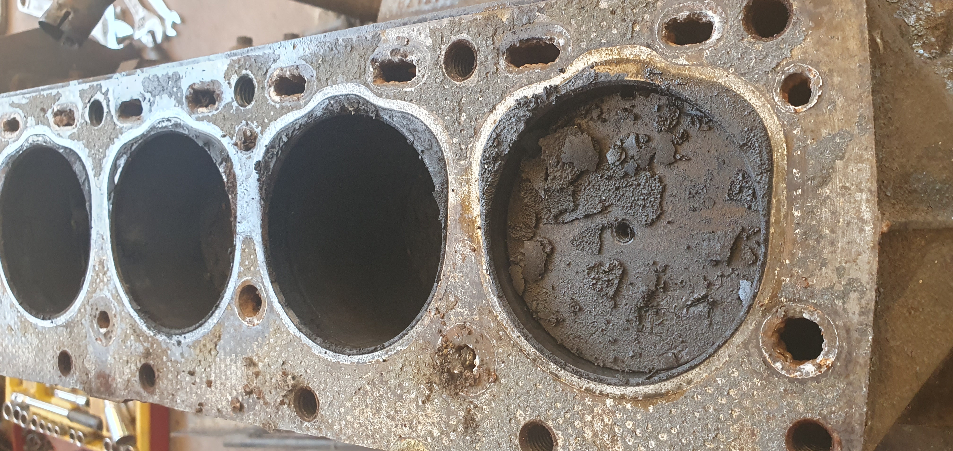

Some pics
- 20260123_152216.jpg (2.28 MiB) Viewed 8842 times
- 20260123_152206.jpg (2.31 MiB) Viewed 8842 times
- 20260123_152233.jpg (1.57 MiB) Viewed 8842 times
- 20260123_152252.jpg (1.61 MiB) Viewed 8842 times
- 20260123_152314.jpg (3.33 MiB) Viewed 8842 times
- 20260123_152358.jpg (2.69 MiB) Viewed 8842 times
- 20260123_152404.jpg (3.36 MiB) Viewed 8842 times
- 20260123_152540.jpg (2.71 MiB) Viewed 8842 times

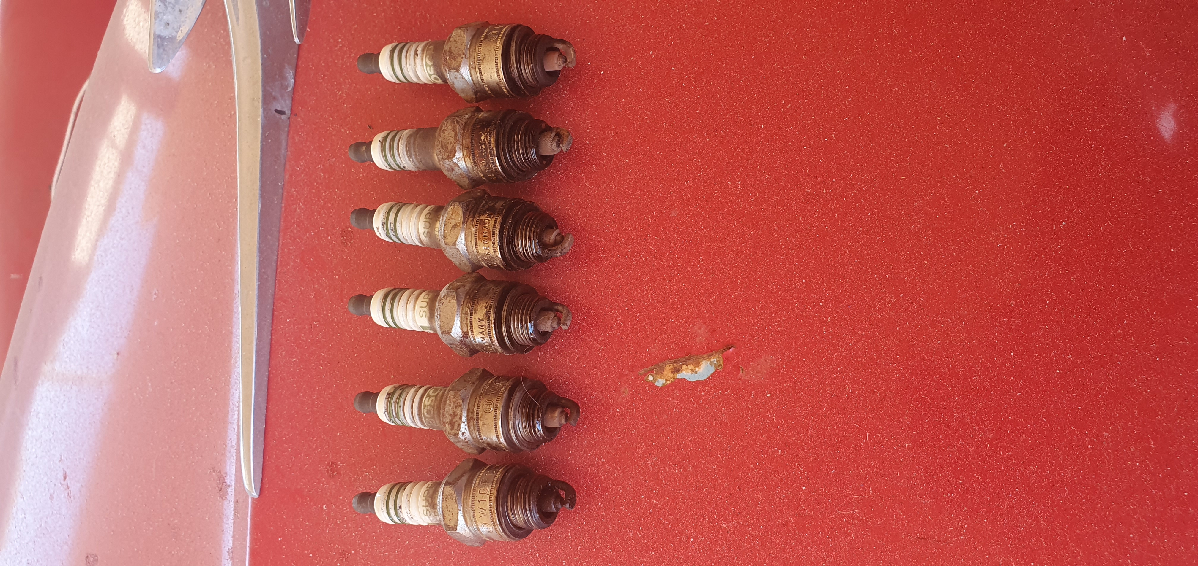

Can anyone tell if it was running on leaded or unleaded last?
Apart from running on oil on number 6, the left Plug.
From my experiences the carbon build up looks like leaded fuel, the unleaded fuel again from my experinces runs much hotter and usually less carbon. You may also see heat effected or at least a black residue around the exhaust valves, which in this case could have, hard to tell.ed.harris wrote: Fri Jan 23, 2026 6:58 pm Can anyone tell if it was running on leaded or unleaded last?
If the motor was running lots on unleaded you may see valve recession, particularly the exhaust.

Thanks Greg, that make sense and explains valve recession on Unleaded. I am amazed how much carbon was in the combustion chambers when I lifted the head off.

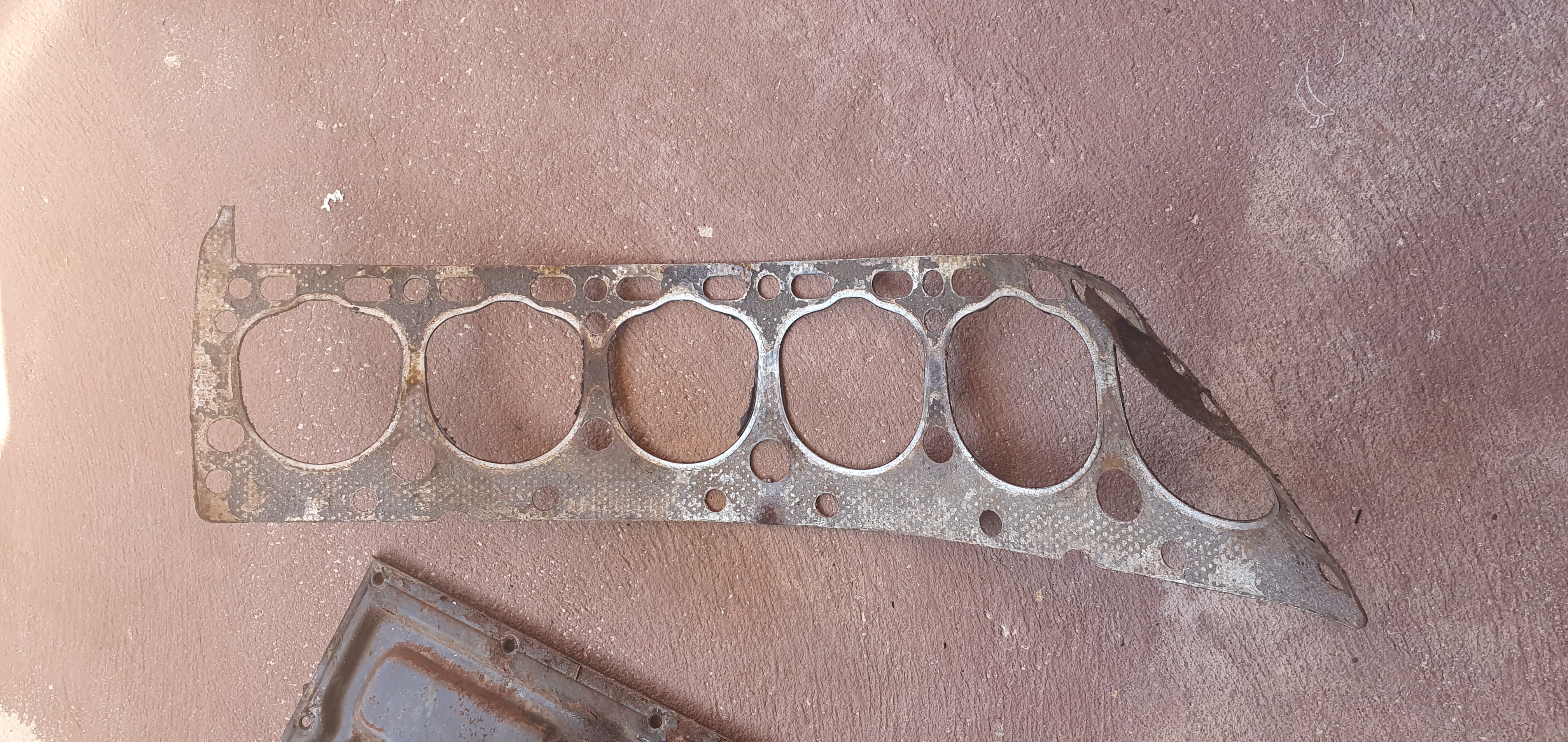

So I believe the Engine was last run before 1986.
I believe this engine would have been a runner.
I can't see any signs of overheating in the engine and the head gasket could be original.
This is making me think I could have a crack free block head and crack, fingers crossed.

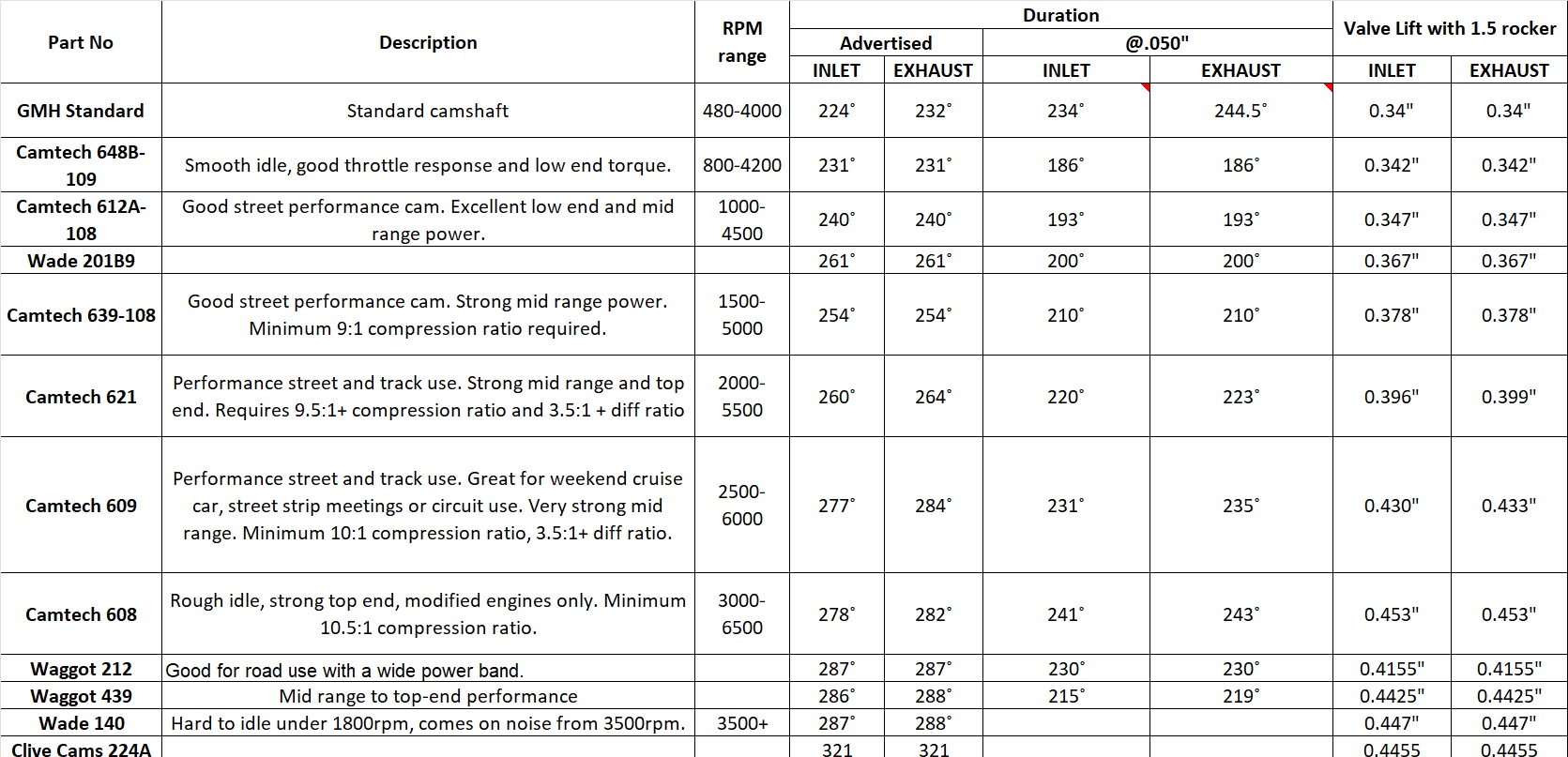

The table is useful as it is written in order of duration. As duration increases (going down the table) the cams get lumpier, make more power... and are harder to live with in traffic. The descriptions in the second column give you a rough idea of what behaviour you can expect at a given duration range. This will vary a bit from cam-to-cam, but is not a bad guide. Just like you have done, choose a behavior that suits what you want. You can then discuss that behaviour and approximate duration range with a cam grinder. They will then find one of their grinds to suit.ed.harris wrote: Sat Jan 24, 2026 11:30 am Thanks Harv I am thinking something similar to the Camtech 639 108 cam. Will that Cam make 125HP?

Anyway, Yesterday I dropped the J motor head off to Galloway`s for his Usual Grey motor rebuild, bigger Valves, back cut valves, 3 angle job, throating and blending and slightly enlarging the ports with the inlets going out to the locating rings outer diameter.
David did say the Exhaust valve size won't increase by much due to their location.
Looking these heads now closer, it is amazing how poor the design is. The Siamese port design must be to keep the Engine Compact.
Anyway, I also dropped off the Cam as an Exchange, David uses Crow Cams and recommended Grind number Crow 846??
David did not have any Specs on the Grind but did say previous builds did result in rear wheel horsepower of 100HP.
So, doing a quick calculation rule of thumb, manual Transmission 3.55 ratio, should equate to, a conservative, Flywheel Horsepower of around 120HP.
So, this should match the Target Horsepower.
I also left David the Master brand, Cast Iron Cam gear and 22 lifters for him to reface, one of the original lifters, no6 exhaust was pitted.

ed.harris wrote: Sat Jan 31, 2026 2:32 pm Anyway, I also dropped off the Cam as an Exchange, David uses Crow Cams and recommended Grind number Crow 846??
Close to a Camtech 639-108 from the table above.
