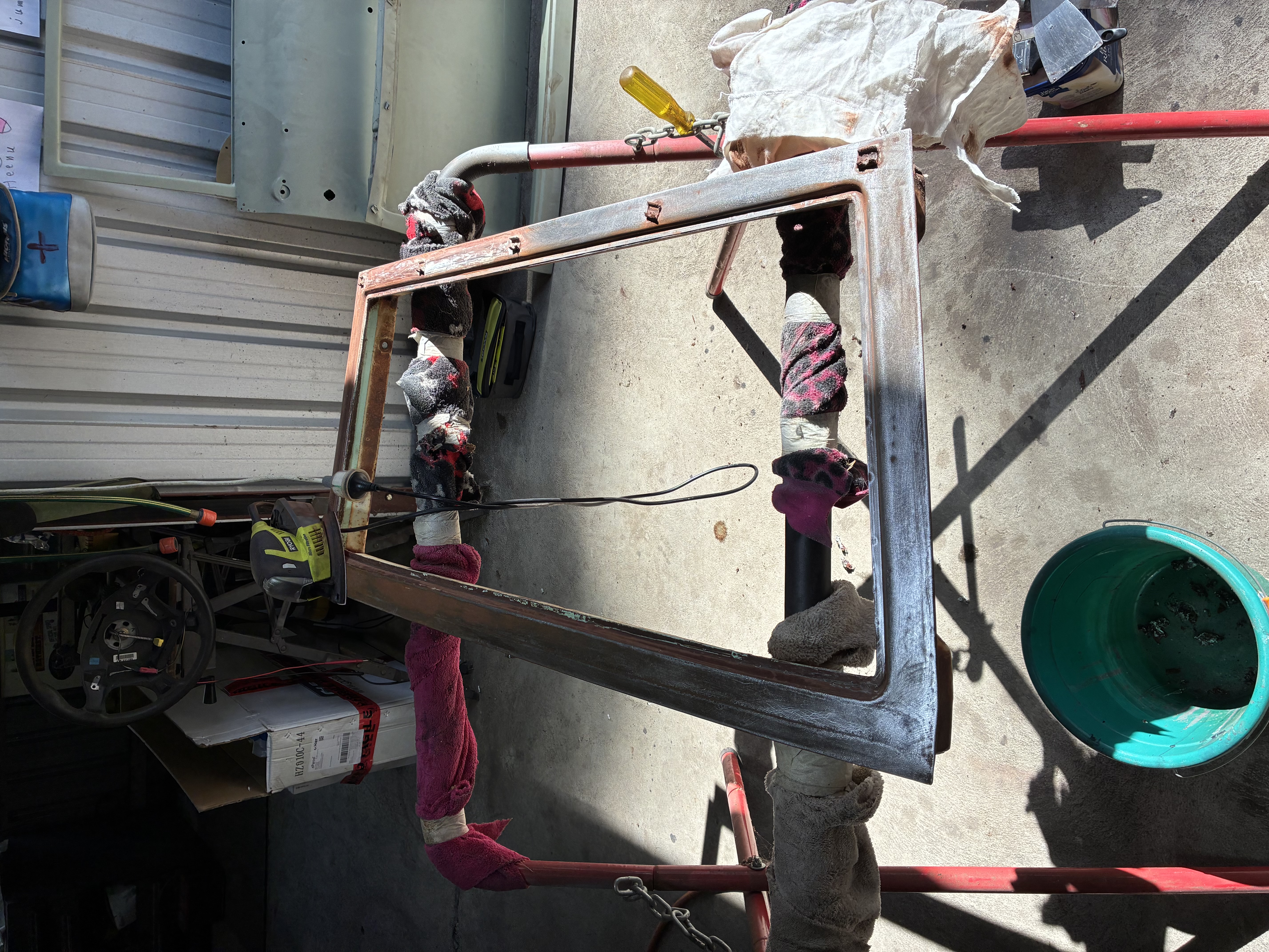

Had fitted my upper tailgate while changing the roof so that we could check alignment after the new roof was tacked, found we couldn't get it to shut properly without forcing it shut the last bit.
After having a good look at it we found that it is bent on both sides up towards the top, looks like it has been pushed up and back maybe without the struts connected and bent back towards the roof.
Cookie, one of the club members was going to EK Mart so I was able to get a straight one from the proprietor the esteemed Mr Black, once again EK Mart saves the day :clap: :clap: :lol: :lol: :lol: :lol: :lol:

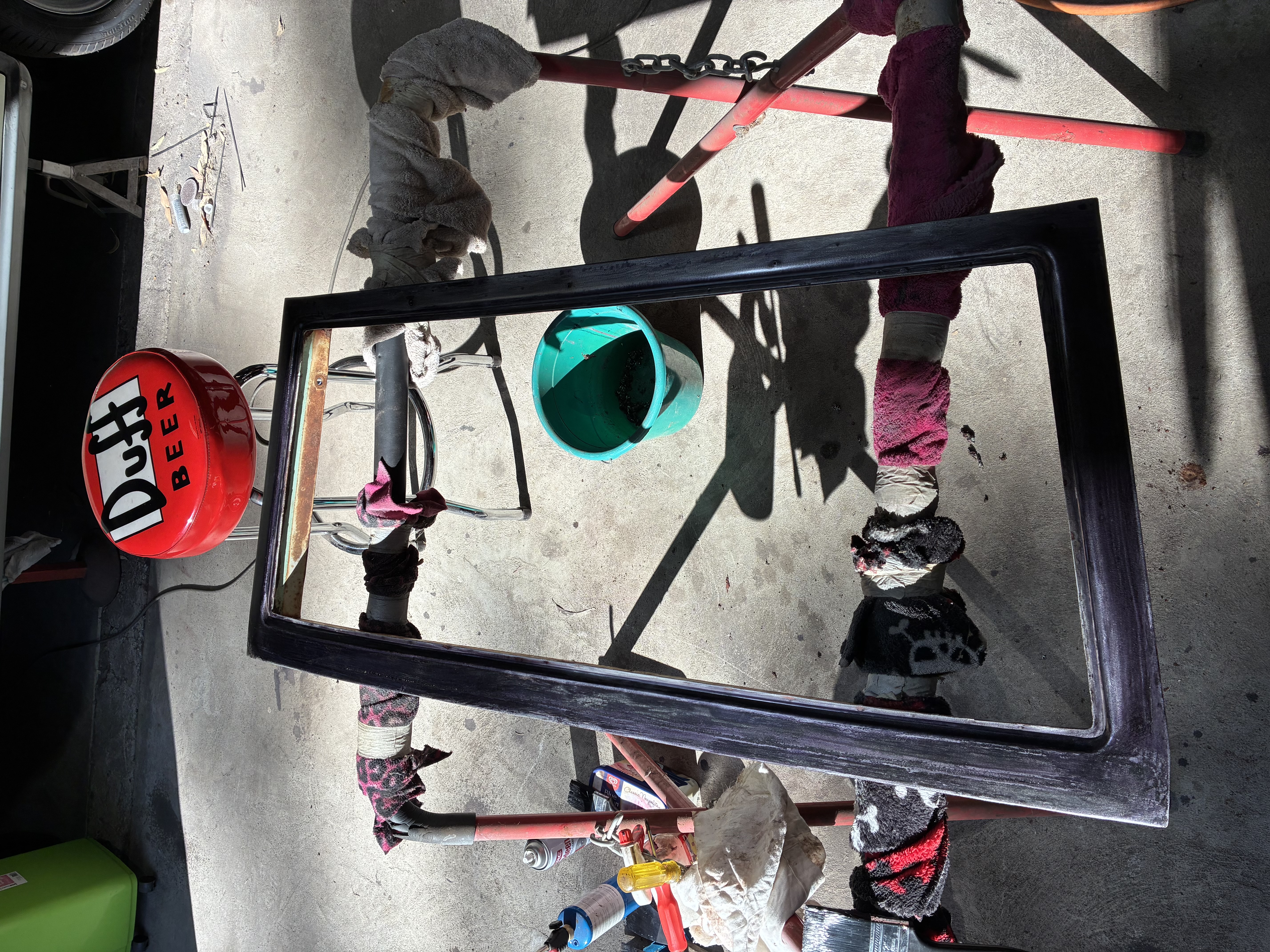

Started cleaning up the EK Mart upper tailgate, can’t believe how thick the red oxide is, I thought it was thick on the roof, it’s a wonder these things ever rusted al all :lol: :lol: :lol: :lol:
Bit of rust converter and move on to do the rest of it
