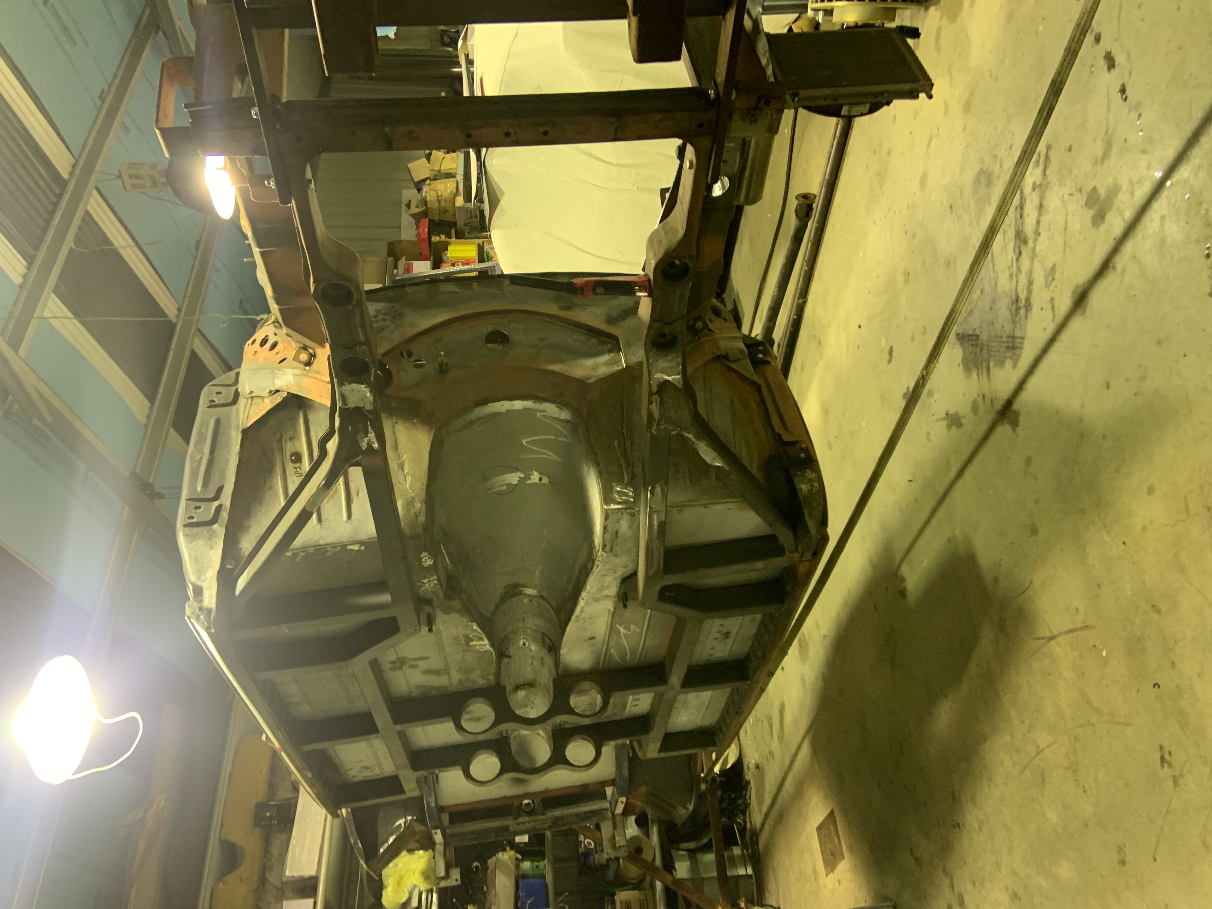

Just a few random shots. Only the front suspension to come out but I need to drill
the locating holes for the steering shaft grub screws before I remove it.

Re: LS1EK
coming apart for paint mate ????

Blacky wrote: Mon Feb 10, 2025 11:29 pm coming apart for paint mate ????
Yes mate, underside, engine bar and all front and rear suspension etc.

Underside more or less sorted , I just need a couple of days to strip it and hit it with some primer.

Well today was a case of going backwards to go forwards. I have been stuffing around with a section of the floor which had oil canning in it for ages. It was giving me the shits, I shrunk it and then it had highs and lows. Hammer and dollied it then it oil canned again.I was going around in circles and it just got worse.
I could had left it as once it was sounded dreaded ect no one would know, well except me. It would had haunted me if I did not fix it. So I bit the bullet and cut the whole section out and redid it, 5 hours latter fixed.
All in all that is all fab work done, no more welding just cleaning up now and mounting of a few items like the overflow tank for the radiator.

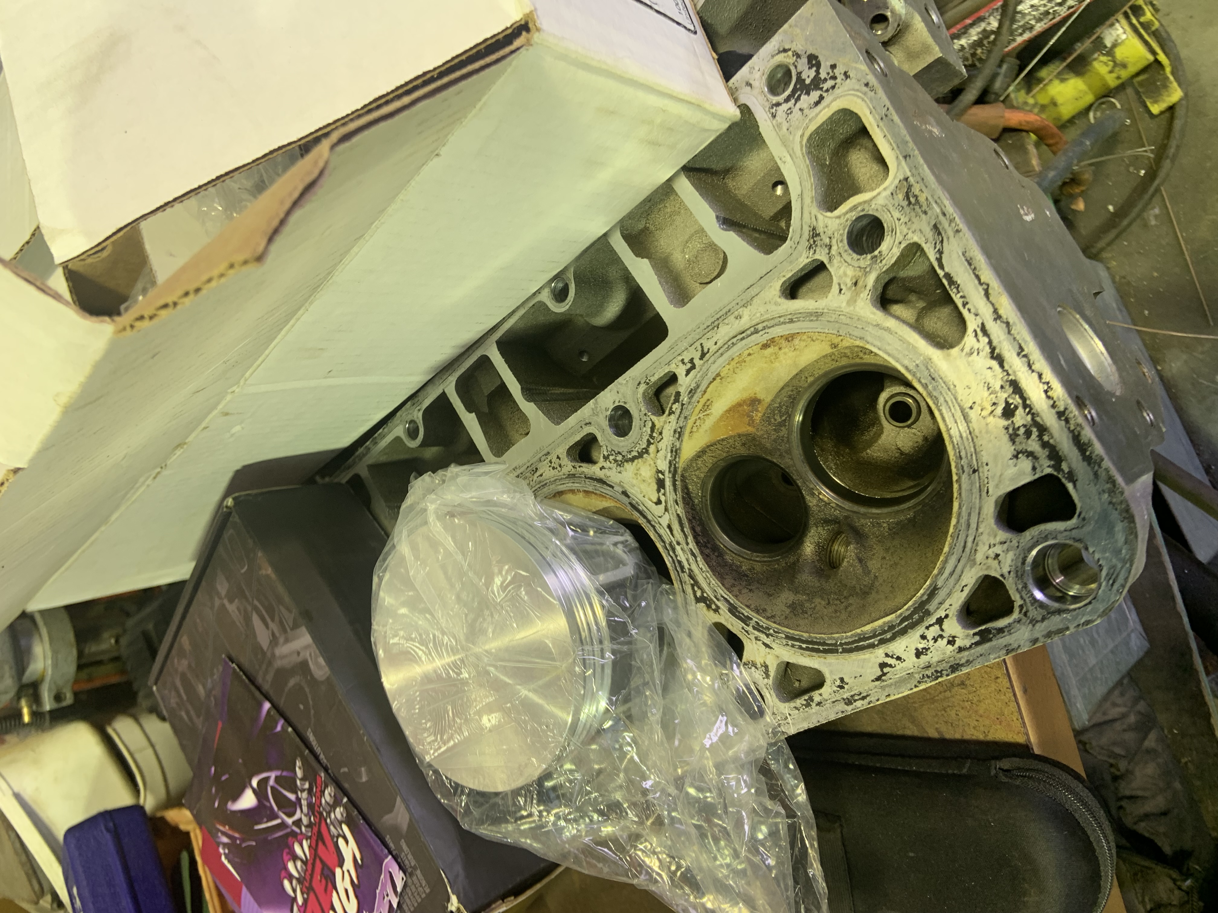

Finished the brake lines on the diff and sourced some LS1 pistons for the LM7 327 C.I.
So, yes it will become a LS1 but for all intense purposes the block says 5.3 L. Don’t tell the engineer.
Also picked up a nice lumpy cam, double valve springs, rocker upgrade kit which should work well once I port the heads.

Posts: 10819
Re: LS1EK
Looking good. The intake valve seats look roomy.
