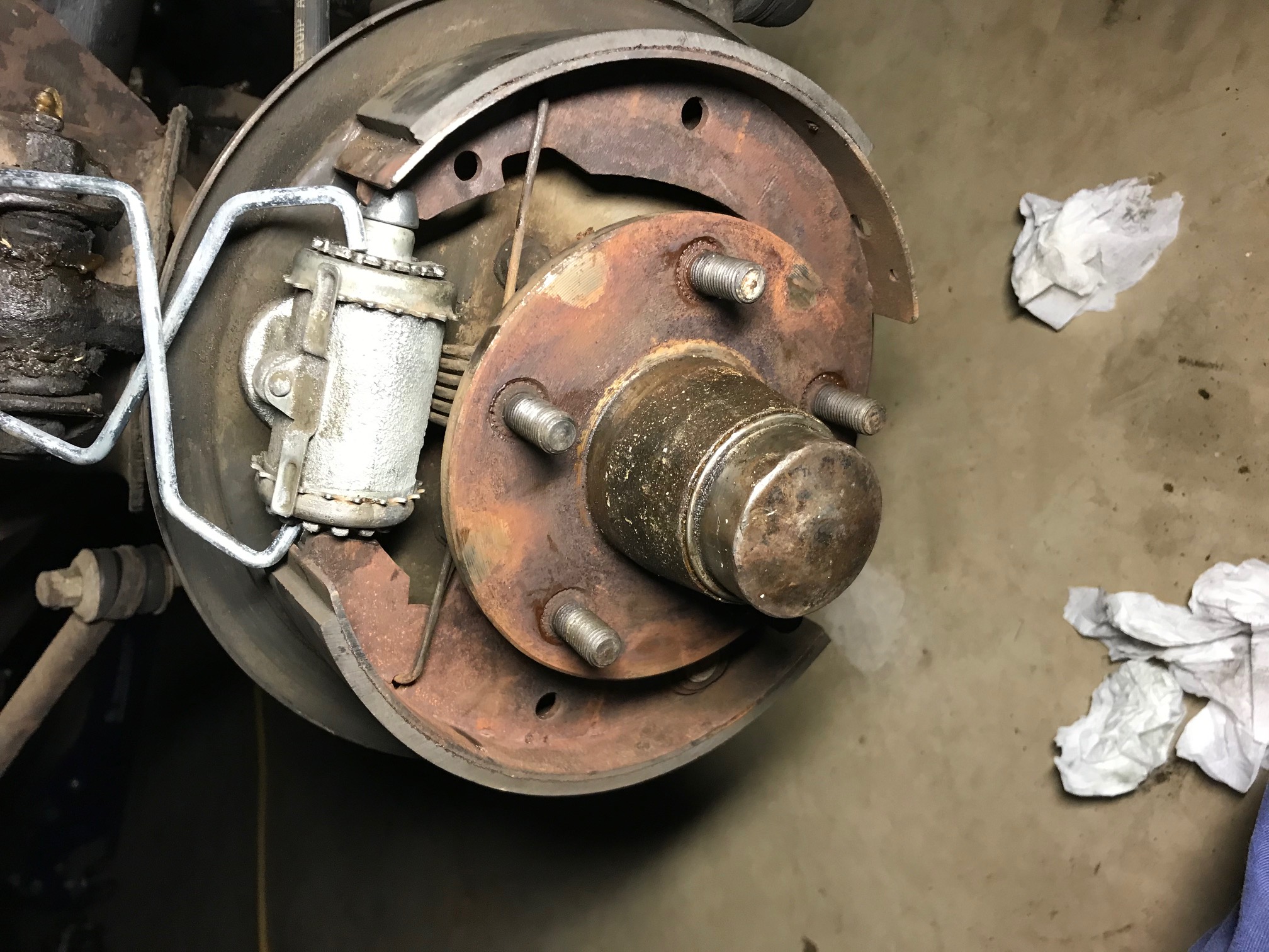

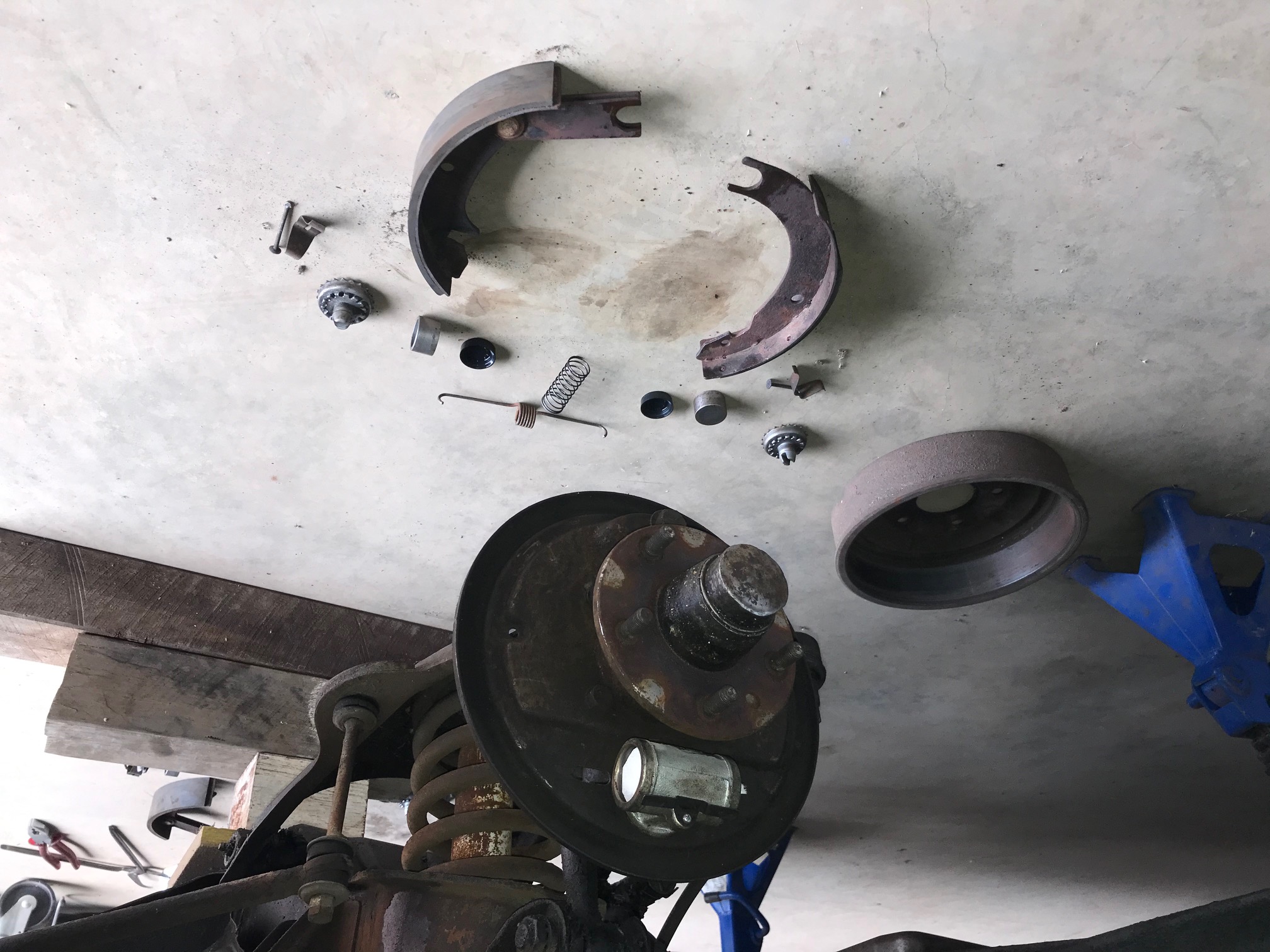

Seem to recall the last time I redid the brakes, that the spring was a pain to get off. I hunted around in the shed for my trusty meco brake spring pliers to assist. Phaffed for 5 mins or so before I figured out I must have used them on the FX not the EK last time. Alot of stuffing around but managed to get everything apart.
Cleaned as best as possible with out pulling it fully down and started reassembly. Greased the rubbers and pistons and put them all back in. Holding the cylinder adjusters together with one hand i looked at the brake shoes and spring and then looked at the spare hand.... Figured this wasnt going to work but thought here I am, it might magic into place. Wrestled the brake shoes on and had a one handed go at the spring with the pliers. Not sure how, but the only magic thing that happened was an instant black fingernail with things let go. Time to rethink. I knew I had brake cylinder clamps somewhere. Brank new pack, didnt want to open them, but figured I have them, might as well use them.
I had screwed the adjusters all the way in to make it as easy as possible. I ended up setting one brake shoe in place and leaving the other resting on the actual adjuster ring/cogs. (as shown in the above pic). Quite easily got the spring in place. Then pulled the brake shoe out and over and into correct position. Had a reverse go and it worked quite well to remove the spring as well. Dunno if thats bad for the spring, but it worked well.
Still need to adjust and bleed but figure Im most of the way there.

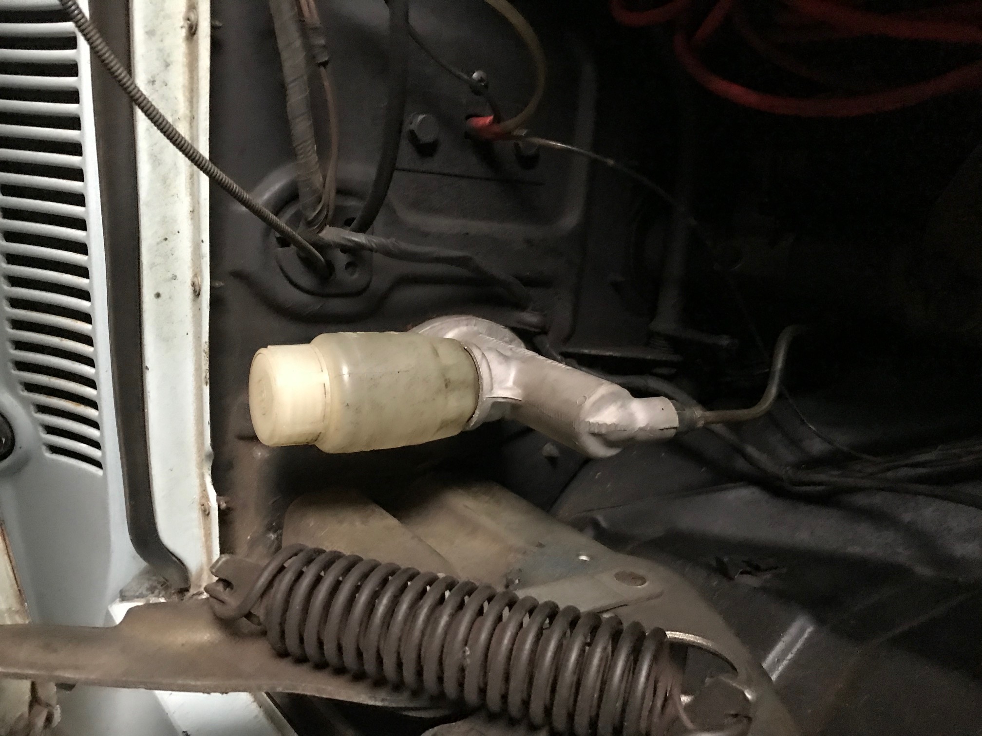

Then figured I should drain the fuel tank. I never used to put much in so that it had less chance to go stale. So, cant be too much in it. More than a 4 litres ice cream container though.... Alternated a few times between that and an oil pan. Remind me not to plant veges behind the shed....
A question if I can (sorry basic one and a few more likely to come..). Do I need to drain the fuel bowl or lines? The fuel smelt surprising good given its age. Given I saw 98 for $1.90 on the boards in town this week, I should have saved the fuel for the mower.. I just didnt want to undo the fuel bowl for fear of it not sealing again easily. I just dont get a lot of time to play so minimising risk if I can get away with it. Can I run it with fresh fuel in the carby and tank but some older stuff in the lines that will splutter and fart for a while till it comes through?

Not to hard to disconnect at the pump and blow back in to the tank if you are worried about it. Ditto the carb float chamber and pump bowl. Once it is back in the tank will be diluted with fresh stuff.
If it were me I would just crank away till it fires and burn it up. But I'm rash and lazy.

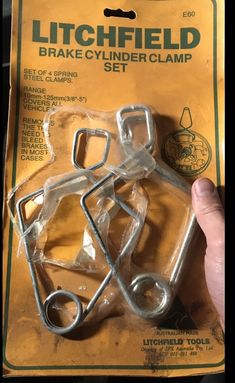

The Litchfield clamp probably smiled when you took it out of it's packet. Tools is for using
Agree on running the fuel line/pump strainer contents through the engine (the float bowl will be stone dry).
The stuff in the tank has the open fuel cap vent above it. Some of the light ends (butanes, pentanes etc) evaporate out over time, making it sluggish to ignite. No evaporation from the fuel tank. The fuel in the tank is also in contact with oxygen. Some of the more complex parts of the fuel (mostly cracked components) will tend to oxidise, forming stuff that does not burn as well or gums/varnishes. A lot less oxygen in the fuel line.

In relation to the fuel I have had a car sit for a long period of time and had it evaporate to a point where it become crusty and stunk like a tip after rain.
There is a drain plug on the fuel tank by memory so my suggestion is to dump all the old crap and blow through the fuel line with compressed air.
I have had this crusty crap block my fuel lines and carby that literally put a stop to a fun weekend.
An inline filter under the car out of site was also high on the priority list.

Harv, only one clamp got to the party. The others are still packed away so I will hopefully always have 1, 3 or 4. Not all or none

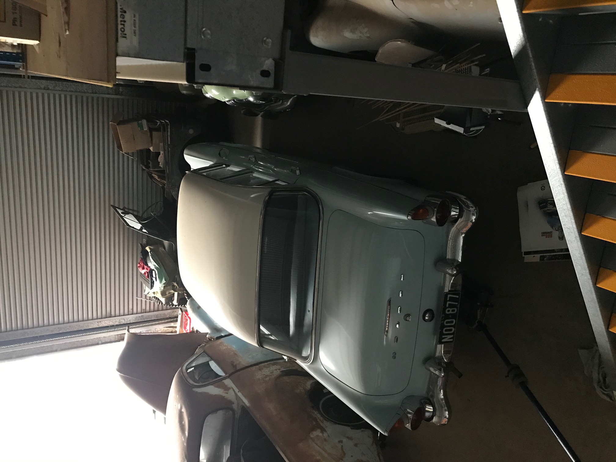

Did I count three Humpies in your garage photo?
Re: Nationals Prep 2021
Hi Rob,
current count is 5. I have a thing for utes... That will be the limit for a while. A wife and 2 young kids kind of put the brakes on things. Its a bit of a "one in, one out" scenario if i want something new.

Now THATS a cool shed I would love another Humpy ute
When you're faced with an unpleasant task that you really don't want to do, sometimes you just have to dig deep down inside and somehow find the patience to wait for someone else to do it for you.
I agree with Blacky great shed if I had one like that I wouldn't have sold my FC Sedan

Geeez Andrew,
You’ve got a few projects there A “thing” for utes is a good hobby / obsession to have
Maybe you need to go up in the shed with a mezzanine and/or hoist? You could squeeze in more stuff?
Thanks guys. Shed will get better when I get it wired up and get some lighting. There’s a mezzanine in the end bay. I’ve built stairs since this photo was taken. 4 cars live under the mezzanine.
I’ve got more than a lifetime of projects there so the kids better get interested!
Cheers, Andrew
