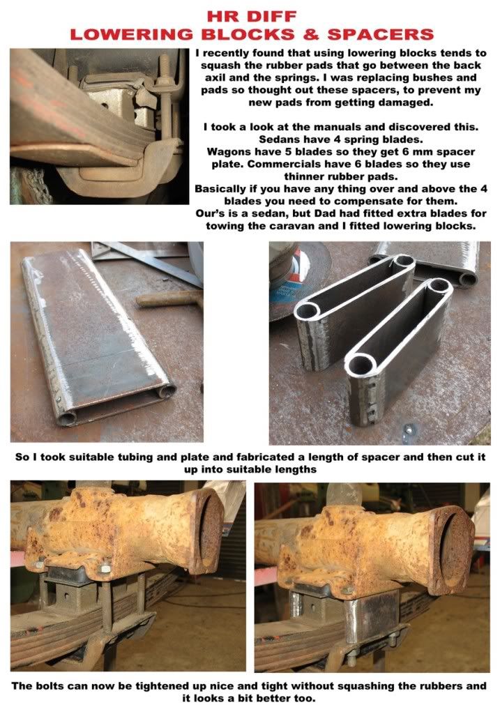

Although this was on our HR, there are a lot of guys who have HR Diffs in their FB's. Maybe it's old news to you , maybe someone will find it a useful tip.

You're not only have OK with your coloured pencils (and building one beaut little pedal car!) but handy with other ideas as well. No engineer would turn his nose up at that mod !

Nice job Alastair, looks real neat! Myself- I just chuck the rubbers!
