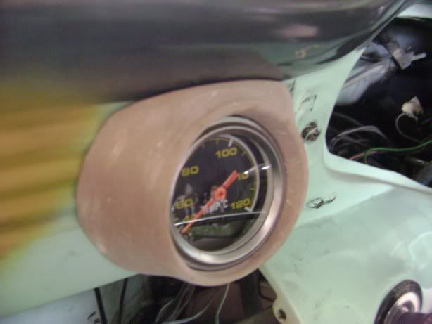

I could'nt stand the old temperature gauge under the dash (plus it did'nt work :oops: ) so I decided to move it up to where I can actually see it! I did this also on my old wagon..but it looked a bit out of place just sitting there..so this time I've decided to make an FB/EK esque frenched surround.
Firstly it was out with my trusty pvc tube and gorilla hair (actually in my case it becomes "guerrilla" hair :lol: ) and start moulding a piece.
Here's it in it's first 1/2 finished state..
Next (when I was happy with the surround ) was fit it to the dash and mark where I have to cut the hole for the gauge to go through. Once the hole was cut I drilled two small holes either side for mounting screws.
once I was happy with the fit of every thing it was a simple case of bogging the gaps and sanding it smooth ready for high-fill & paint.
Note: the new place for the CD player..now passengers cant change my change my music or radio stations!! :lol: :lol: 8)

It's too bloody hot here to give it a coat of Seaforth Green..it's 41c in the shed..not much cooler inside at 39c!:shock:

Had perfect weather conditions this arvo :D so out with the masking tape & touch-up gun ..YAY it's back to Seaforth Green again! 8) :D
Note: inside the Temperature Gauge surround is the darker metallic Green ..I'm doing this to the dash gauges as well then lacing the area that the Special's alloy fascia plate goes. Should have the dash finished Thursday arvo..fingers crossed. :shock:
