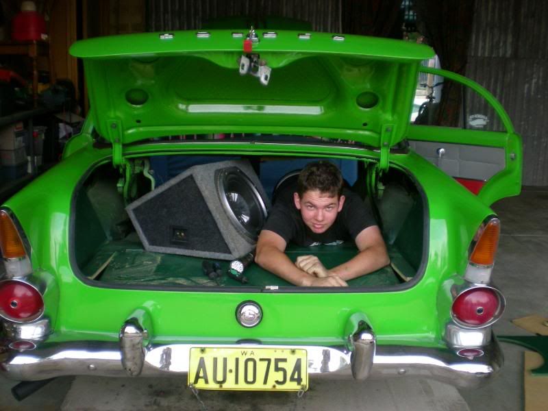

ok so the other day I put my baby in the garage, then had my mates over and a dude who had never seen my car before wanted me to crank up the sound system.
I did so, went to show him the sub in the trunk, stuck the key in - and it wouldnt unlock?
I opened the boot earlier that day n it was fine WTF!!
it moves to about 2 o clock and then just wont budge, dont wanna snap my key off but yer how the hell do i fix this :shock:

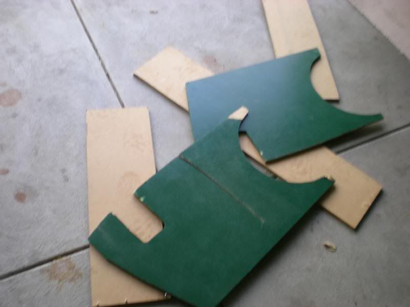

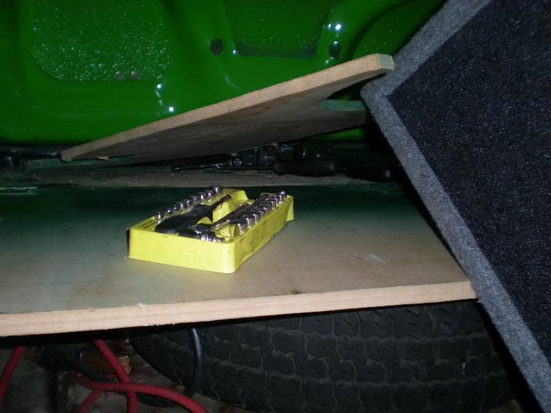

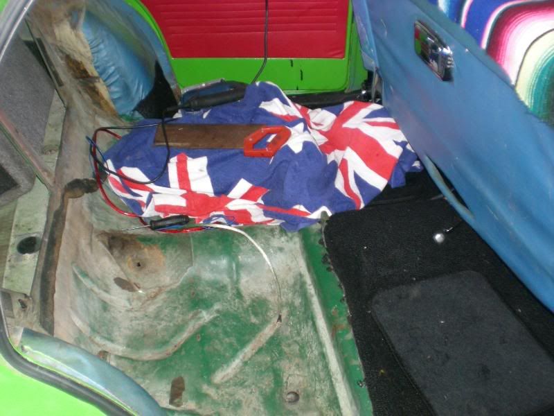

now... i just tried to get into my boot through the rear seat, had to cut up my back board with a saw, then I also had to kick it to make it snap properly..... I now have decent access, there is nothing caught in the lock i think its just being a bit stubborn...
will have to unbolt the latch n screw around with it....
that was heaps of fun :|

i had two big bolt screw things,
and 2 small screws
tight working space
broked :(
FREE AT LAST!!!!
