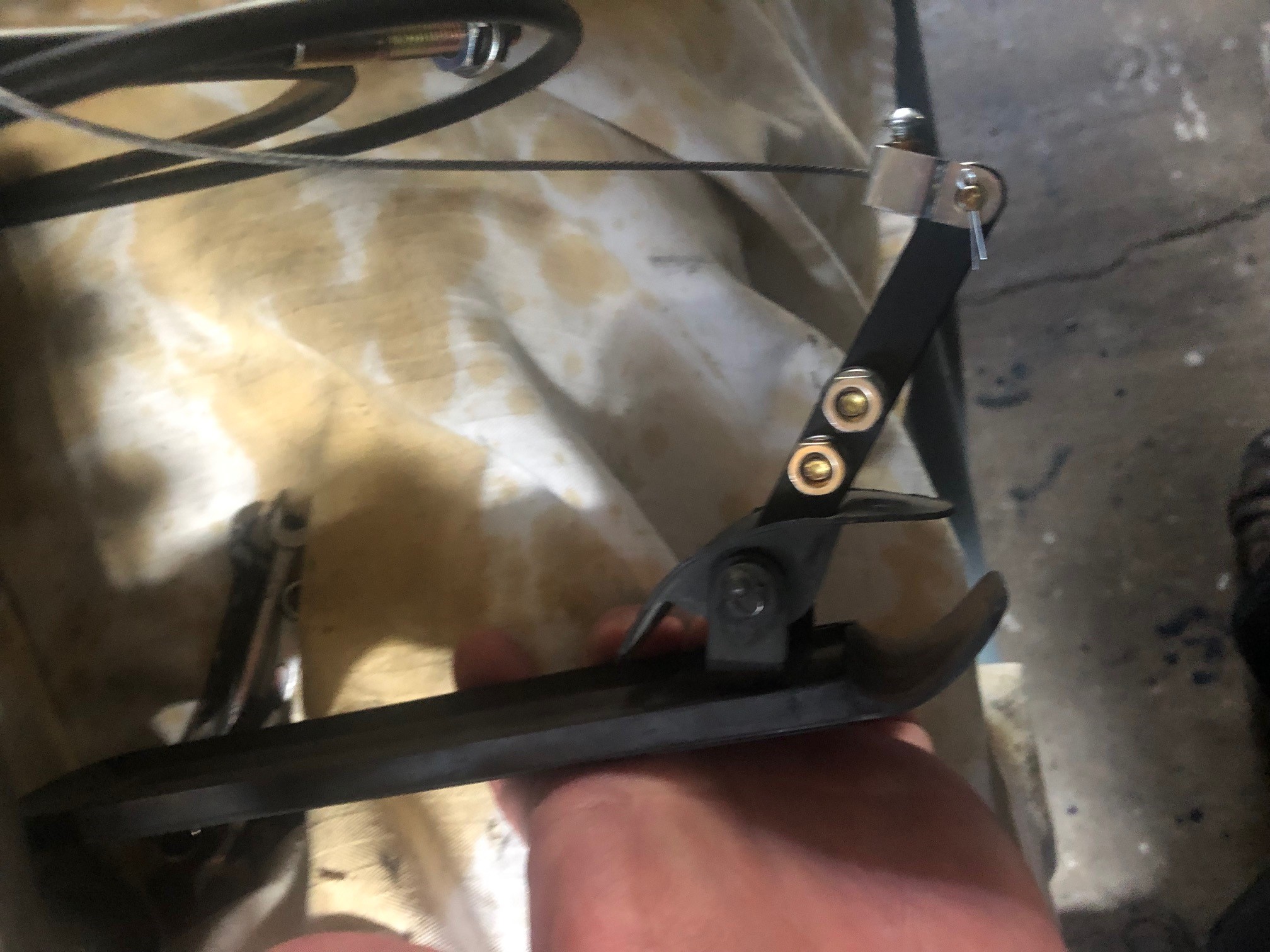

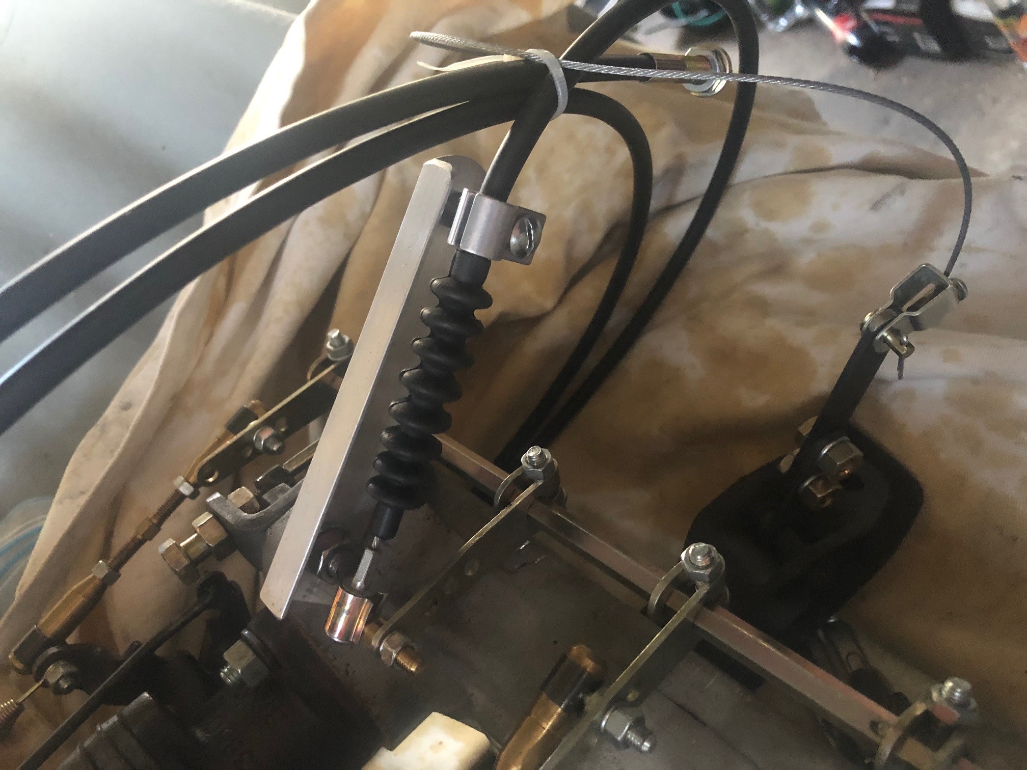

Another option for the cable (for those who can't weld): original pedal (this one is a Rares replacement), short extension on the pedal arm, and aftermarket cable kit from Flexibledrive.
cable 2.jpg (532.81 KiB) Viewed 2059 times

cable 1.jpg (583.37 KiB) Viewed 2059 times

Yeah it worked OK but I prefer using the stock pedal , something like Harv has posted, I wasn't aware someone did a kit for them though , that comment above was from a V6 EK sedan my wife used as a daily so the Commode pedal fit straight in for the throttle body end and just required a bit of fettling inside to make it comfortable to use .

Part number for the flexible drive kit. It has the cable, clevises, rubber boots etc. Have to DIY your own pedal arm extension though. Some guidance in the Strommie Guide on length of extension vs. cable pull possible.
flexible drive cable kit.jpg (477.82 KiB) Viewed 2042 times

Thanks Harv, I went straight into Flexiblw Drive and had a look and yes I think it’s a great kit… bought it home with me to Hagar a play with now.
I think I’ll extend the pedal shaft by 1 inch, if it is no good I can always have another go at it.

Check how much cable pull you need once you have the carb manifold linkage put together.
The standard pedal will give you 12mm of pull. Extending it 40mm will give you 35mm of cable pull.
Extend it much further than that and you can hit the y-frame leg. If you need more cable pull, change the lever length up on the carb manifold linkage (shorter lever = less pull but more force needed).
