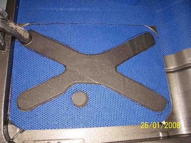

Hi Strogger,
I'm pretty well convicted to leaving the floor with only a paint finish - had some very anxious moments with deadener and adhesive sound material....
I now use a Clark Rubber material called "moonwalk" it is a perfect medium to fit between a high gloss floor and carpet - it grips to hard slippery surfaces tenaciously yet still grips carpet....... I find it quite good as far as sound absorption is concerned - but I'm nearly deaf..........
The product is quite expensive - $44 per lineal metre @ 1300 mm wide...
It is not too bulky - certainly not to the extent that the original fibre mat is....
I have fitted 3 layers to my floor/boot/underside rear seat and "waffered" some absorbent cloth to catch any grain/dust which may "filter" through the carpet - in the view of preventing abrasion to the paint........
One layer of "moonwalk" is around 1/4"..........easily removed for inspection.
It will compress quite readily yet return to its original state within seconds....
This pic shows the moonwalk (blue) and also a much thinner similar product - I used Loctite 424 to "weld" the two different thicknesses together.
There may be better options, this has been my most satisfactory attempt thus far..................
