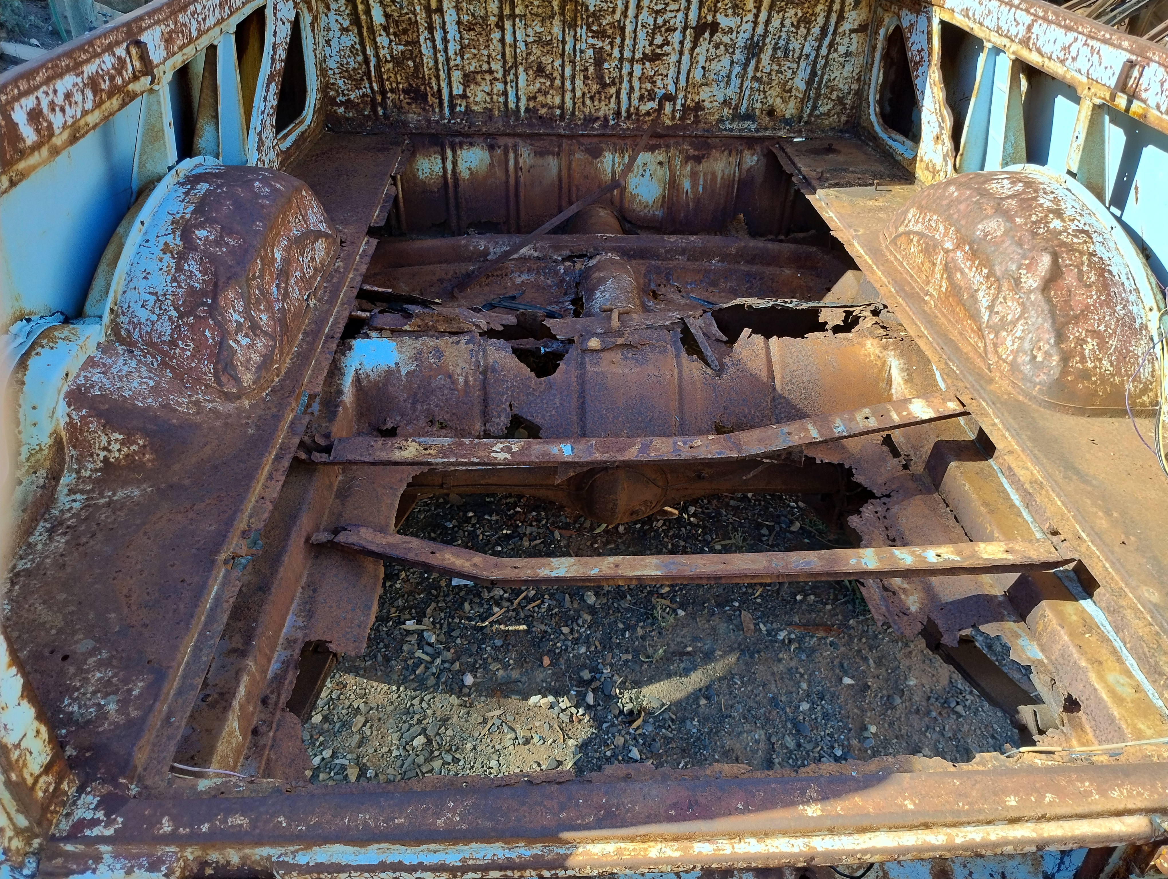

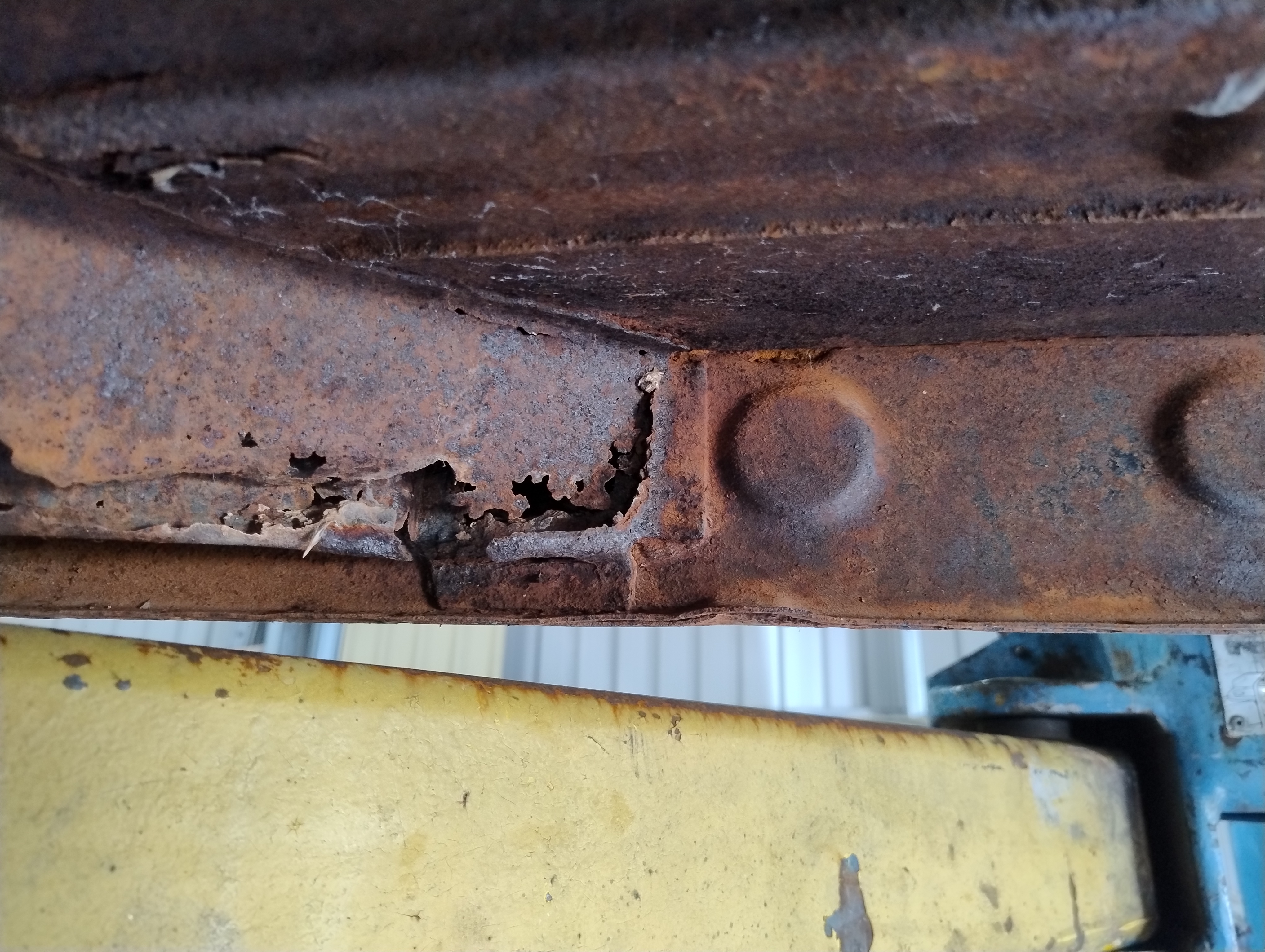

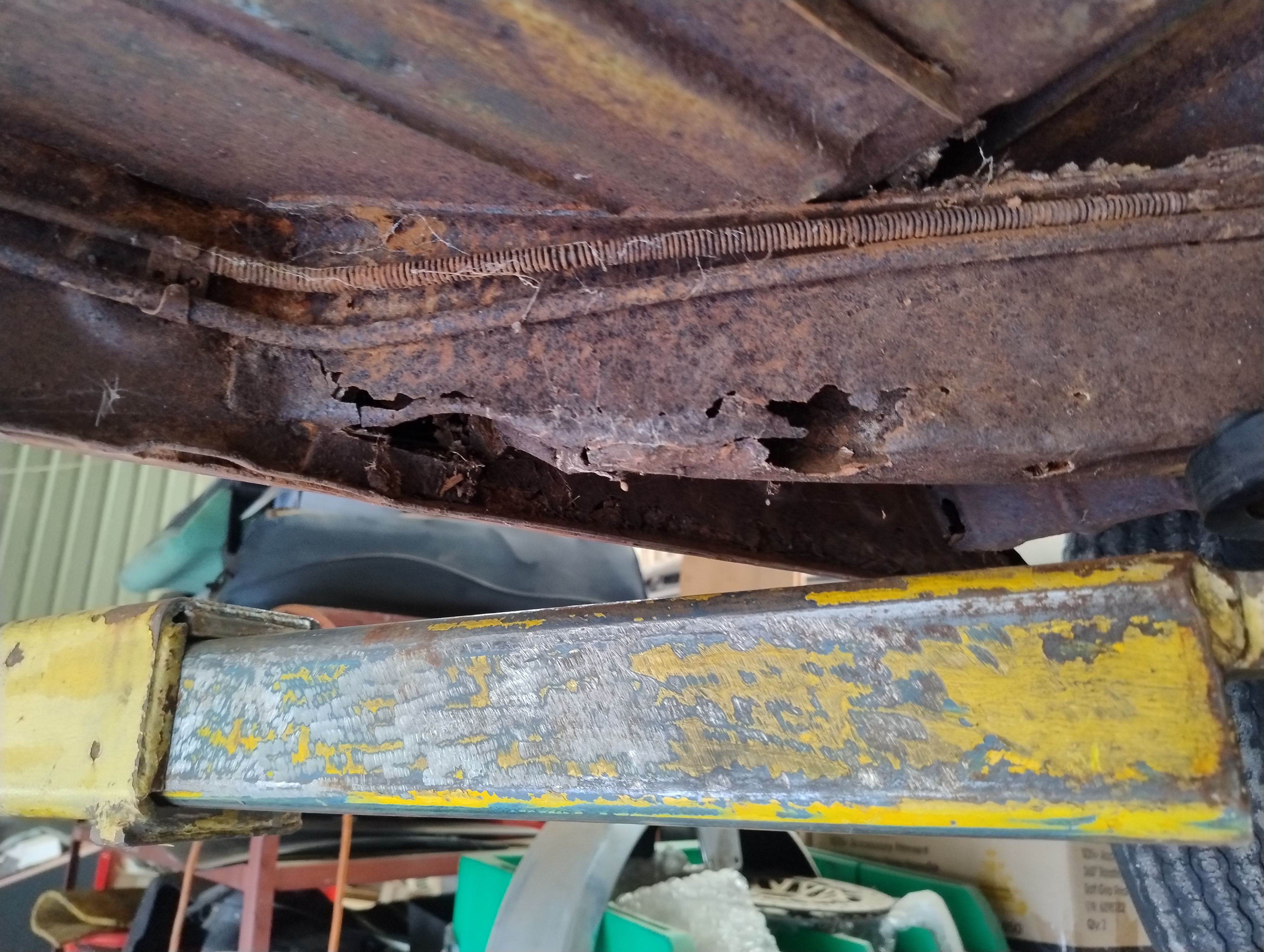

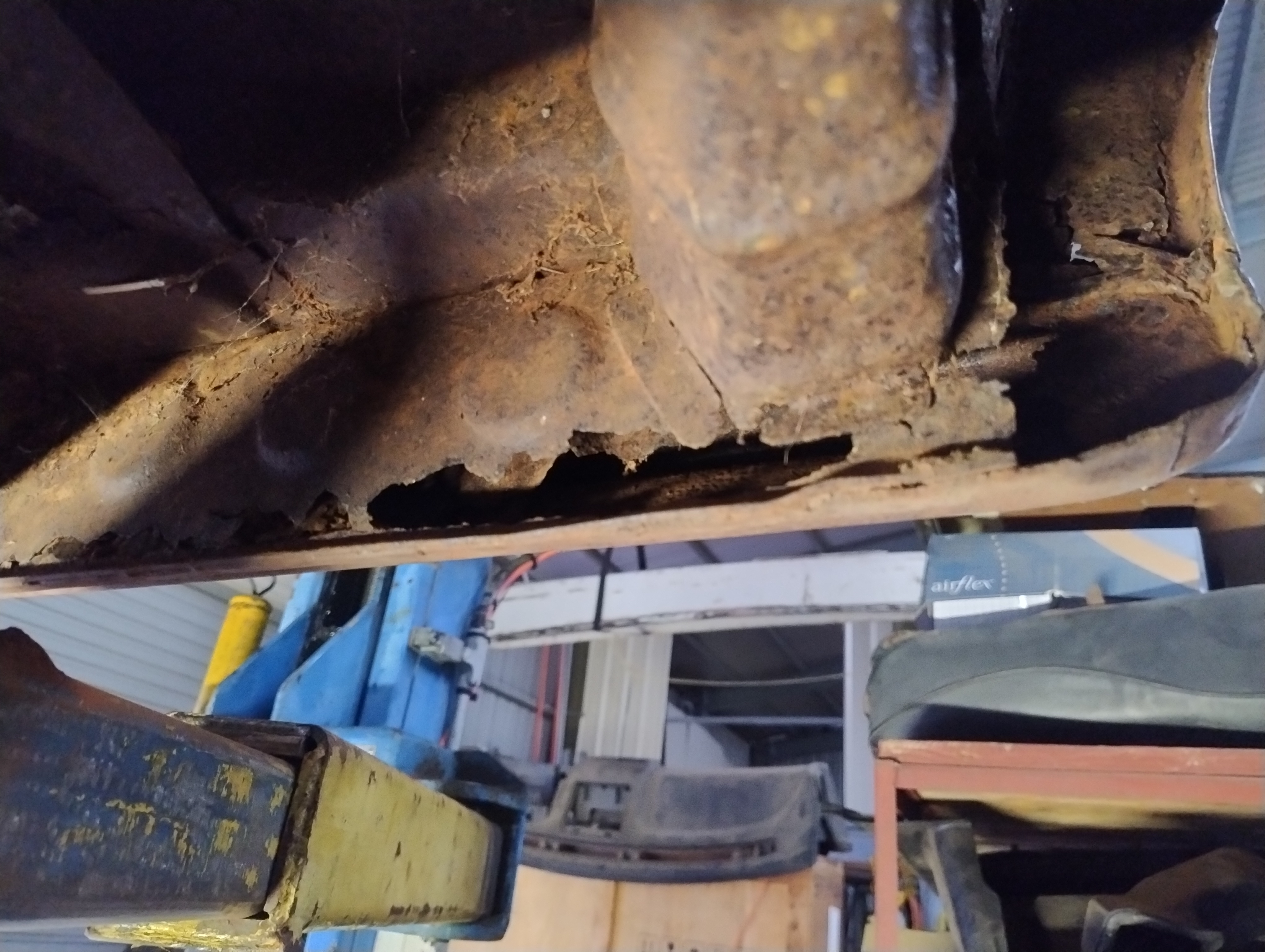

Got the wife an EK ute from outback NSW, full of mud nest wasps nests and desert sand and dust. Has rust above the sills in back and needs a complete floor from dash to tail gate due to dust and sand sitting and getting wet. Y frames are solid, passenger side inner sil is solid except where rear rail connects. Drivers side inner sill is rusty from where the rear rail connects to rear wheel arch. Passenger outer sil is solid except for a few little spots under the crease line at the very rear and the driver side last 200mm is rusted, rest is fine. Rear rail drivers side is rusty just above front rear spring hanger, rest is solid, Both rear rails to sils rusted out. I need to replace the panel from drivers door to wheel arch due to accident damage, I have a panel cut from a van.
Had it up on the two post hoist, banging on everything underneath with a ball and pein hammer trying to find any soft spots. While on the hoist I am unable to open the doors, dropped it to the ground, opened doors then raised it up and doors won't close, they have dropped below the latch striker, I presume due to flex from loss of strength in the floor.

First recomendation is to brace. Inside the door openings so you can fit doors as you progress. I used 25mm RHS about 3mm wall thickness. A few diagonals and across openings and across pillars. Get it back to square before you start.
Second recommendation is too measure before you cut/ take bits off. If you have a look at my builds you will see scribbles everywhere.
Third recomendation is to only do one side/ bit at a time. It is much easier to master one task before attempting the next. Build confidence by starting small.
Final recomendation is to think " Zen and motorcylce mechanic". Try to fight impulses and plan each task before you cut away.
Good luck with it and have fun.

When I first started my Ute I would procrastinate sitting in front of it and not now where to start until Blackys words of wisdom told me to get it blasted first so that I could see where all the issues were, if your whole floor pan is as bad as it sounds you may want to strengthen the whole thing before blasting.

Thinking of possibly using a donor floor from a VP commodore wagon, it will give me mounts for seats, seatbelts rear suspension, etc and a bigger fuel tank and tunnel.

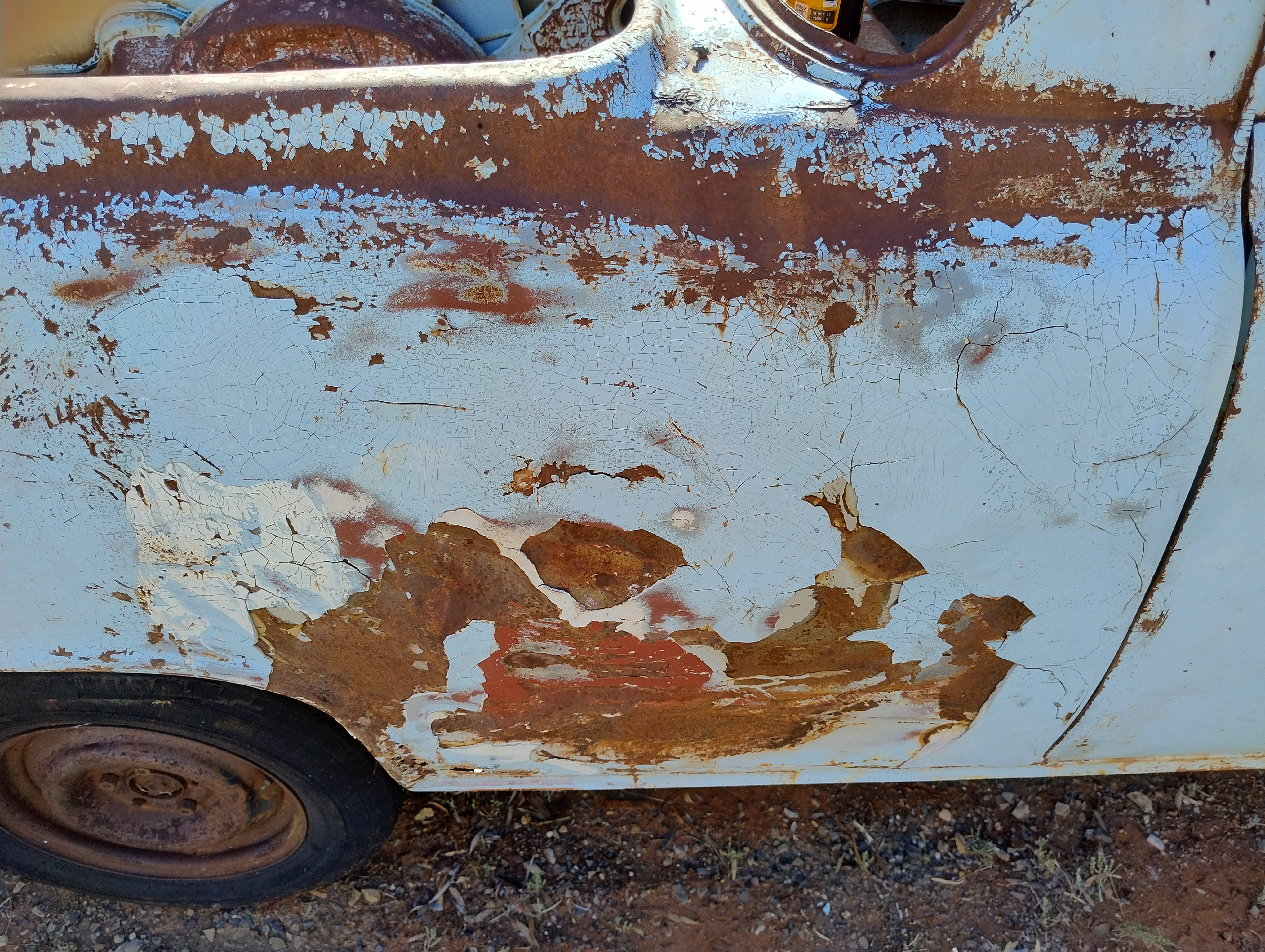

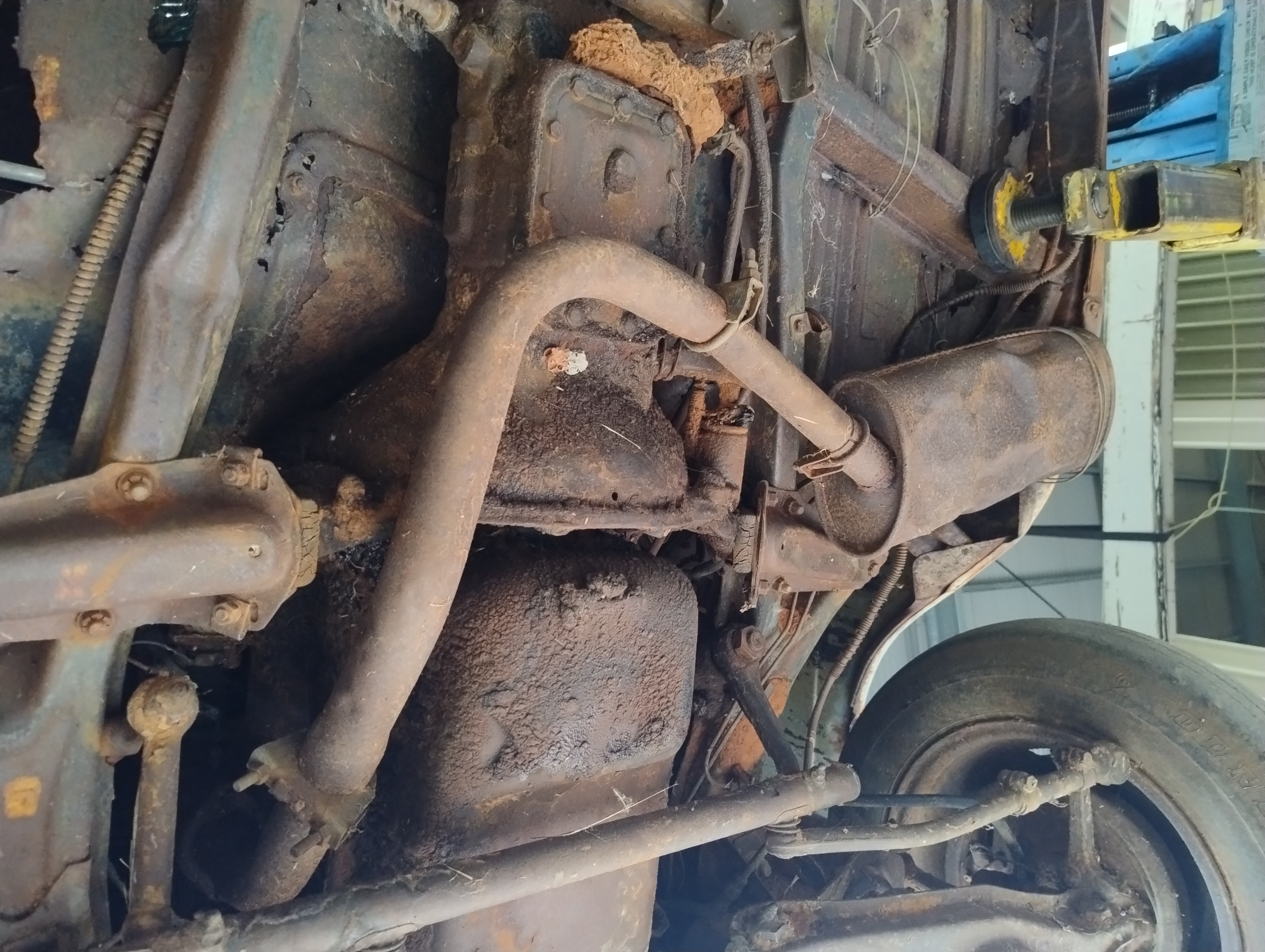

Thanks, the rust is just from dirt and dust that has settled onto upward facing panels and gotten wet and of coarse the half ton of mud under every surface form mud nest wasps, including massive amounts under the dash. Window surrounds are still solid and have paint, Y frames are solid, front guards have a little at the top rear. Wasps also got into the rear sill pans where the rear rails join. Put the photo of the exhaust up cause I knew people would like that, think the bend is from over the axle.
Also have 2 bullet holes, both from the tray, one into the right side and the other into the cabin just behind the driver!
I've got 4 different wheels on this, 2x13's and 2x14's, one of the 13's has a riveted in centre. One front brake drum, right rear is a finned drum and left rear is smooth drum, no hand brake cables at all, front left brake hose is cut out, right is just cut, rear hose still there, but the 20m of sheep fence that was wrapped around the axle between the springs and wheel got so tight it has squashed the steel pipe flat against the axle housing.
So far I have picked up a replacement section for just behind the drivers door( to replace the massive bog filled dent), though it is from a van so will need a bit of extra cut and shut. A few sets of ute rear and side glass and I think there are some extra windscreens around here too. A set of doors though I think I will only need the passenger side, an original under dash parcel shelf, replacement drivers side guard spear( left one is good), some roof bows, HD ball joint front end and a set of HR lower arms, an assortment of brakes and stub axles, some rear axles and the list goes on.
May be easier to replace the roof too, as it's solid but very much dented.
Sorry if this is a bit of a longwinded rant.
If any one has any questions, wants clarification or specific photos, just ask.
I'll be looking for some bits too, Ill do a separate post on here for them as I think I've out done myself with this post.
I'll ad a photo of the big bogged up dent.
