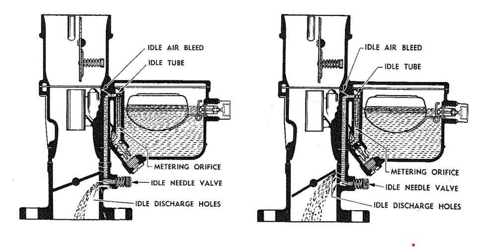

What we suspect is causing your stumble from idle are the two upper idle transfer holes. When the carburettor is at idle, fuel is fed from a little hole in the throttle body, below the throttle plate (in line with the brass idle needle valve). You can see this as the fuel squirting in from the picture below, to the left:

When you begin to accelerate, the car needs more fuel. Initially, the carburettor fuel pump plunger puts a squirt of fuel into the carb throat. Rob repaired your plunger leather cup, so now you are getting that squirt. Once that squirt is over, the throttle plates are open a bit more. This uncovers another two holes in the throttle body (the idle transfer holes), a little higher above the throttle plate. These holes start flowing, as per the image above right. That little flow of fuel tides you over until the main jet starts flowing.
We suspect the two upper holes are blocked, or partially blocked. You could bend up a bit of fine wire and give them a gentle probe - the idle transfer holes are #56, #64 and #70 drill (0.0465", 0.0360" and 0.0280”) diameter. Put a piece of string on the end of that wire... so that if you drop it, you can fish it out of the carb throat.

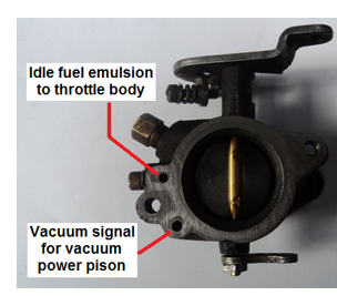

To really confirm those three holes/passages are clear, you take the main body off the throttle body, and blow compressed air down the hole labelled "idle fuel emulsion to throttle body" in the photo below:
throttle body hole.png (105.38 KiB) Viewed 20008 times
You should be able to feel compressed air coming out each of the three holes with your finger tips.
