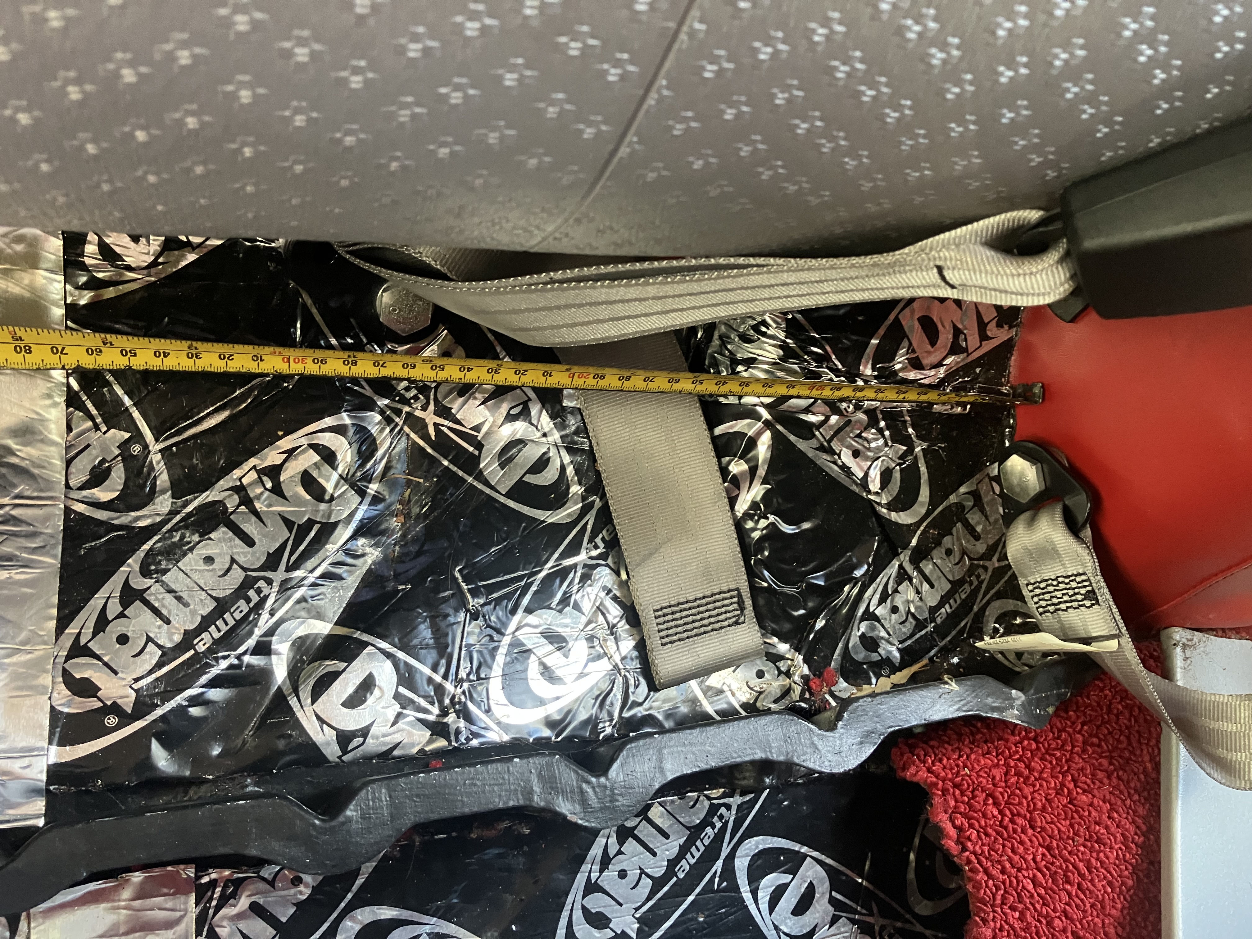

Can any of you give me an idea of how you put your retractable seat belts into the back of the wagon, possible some measurements too :ebiggrin: :ebiggrin:

I demonstrated these belts, to a rather particular engineer, to be NCOP compliant. The only thing he did not like was drilling and UNF tapping the C-pillar plates. The 10mm plate is not as thick as a UNF nut. Had to retrofit a nut back in there with fishing line, wire and swearing. Other plates are the standard cad-plated ones from HEMCO, BFH’d to the floor pan contours. I have all this written up into a seatbelt guide, but have yet to finish it. PM me an email address if you want a copy of the draft.

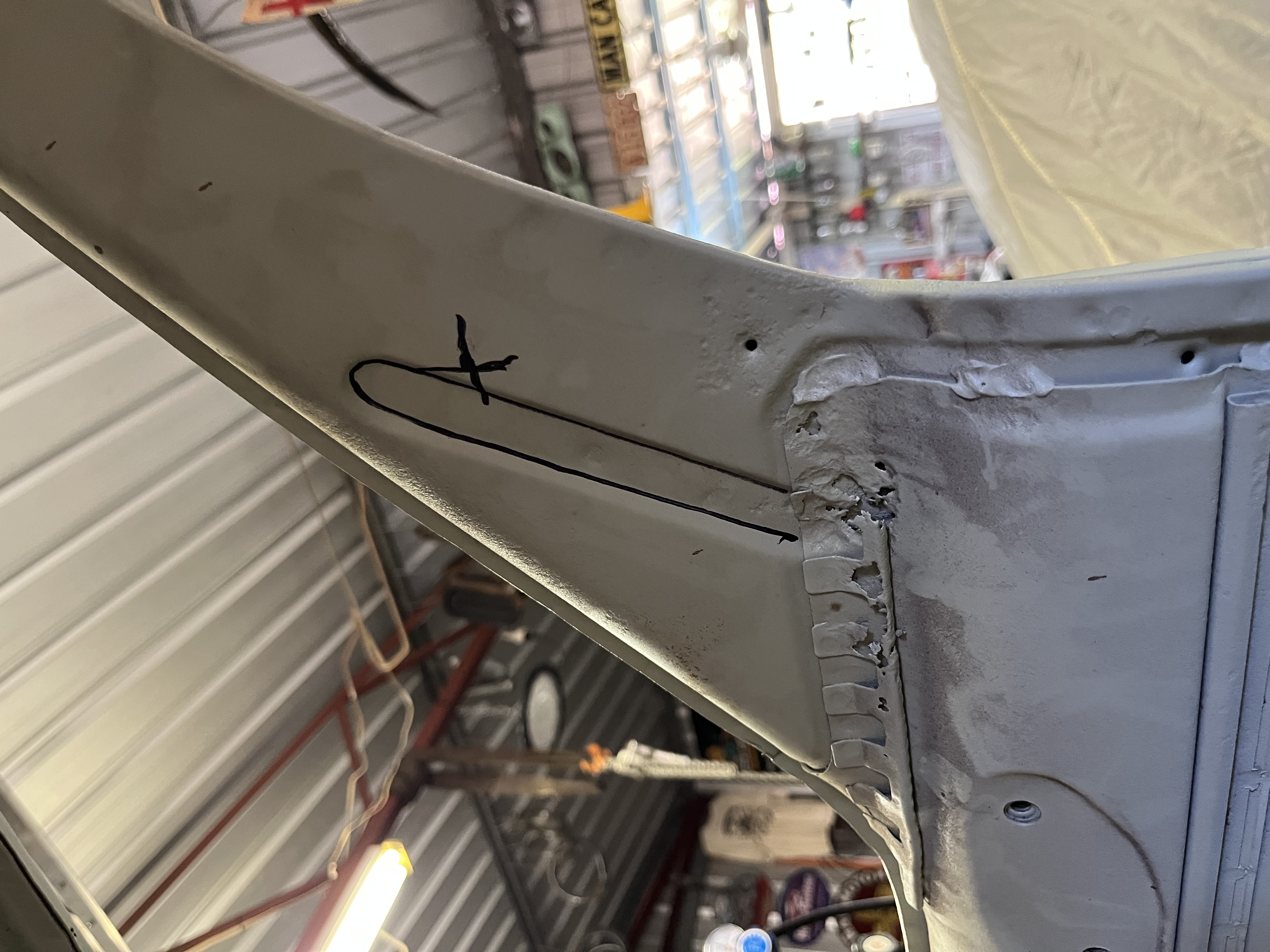

Harv sorry to bug you, I’ve been fitting my seatbelt doubler plates, your guide has been a great help.
Got an issue with the C pillar plate, can you tell me what you did, there is a formed section in the pillar (see photo) and I have marked where the bolt should go, trying to get my head around how I can fit the plate.
Can you also tell me what reels you used for the front.
Posts: 5749
Re: Station Wagon Rear Seat Belts
