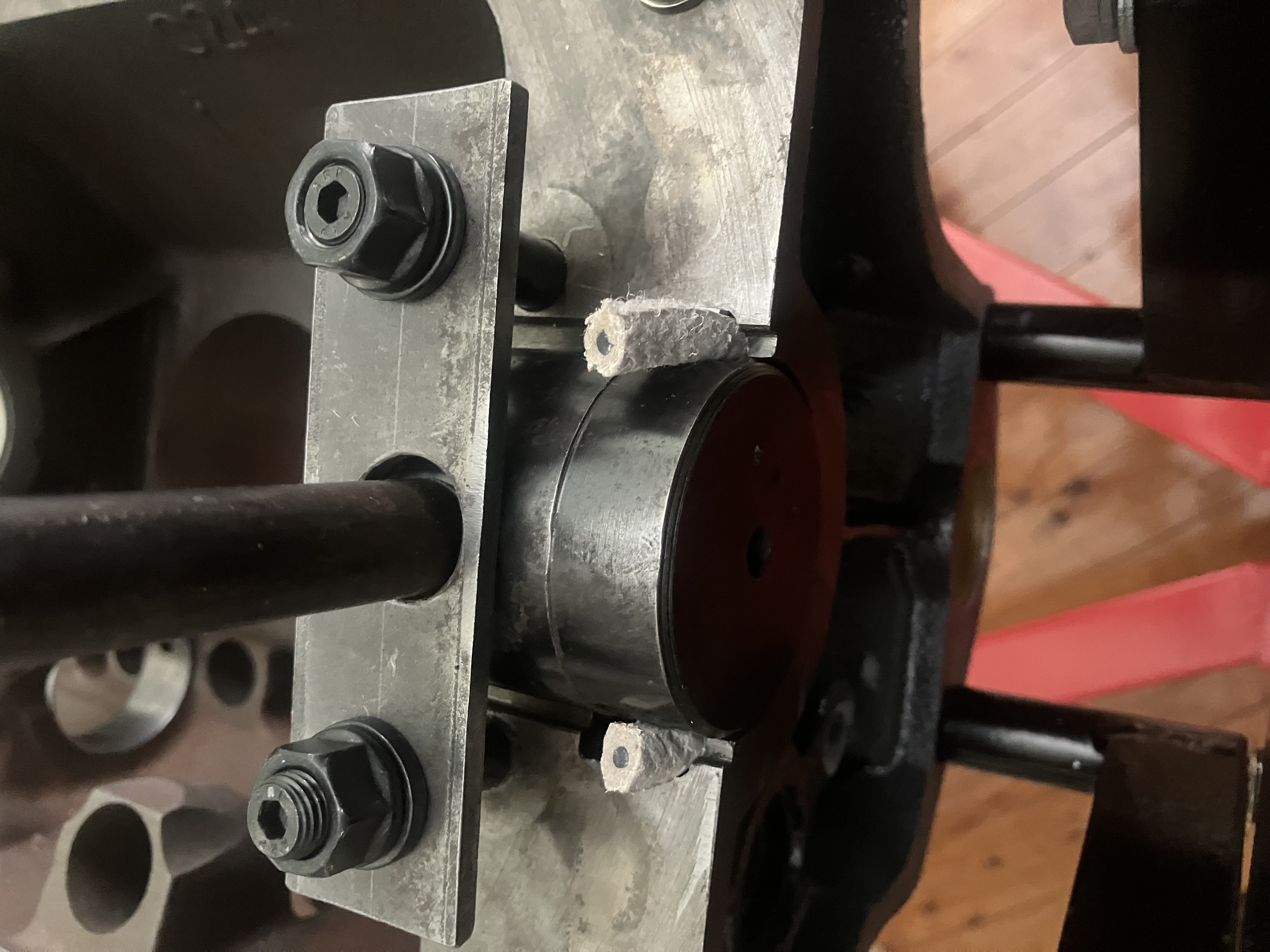

Block end of seal in, and being “trained” overnight with the factory rear-main tool. Nods to Rob for the idea of using a flat bar bridge to hold the tool in place. Humpy crowd reckon that the seal needs no training, but can’t hurt.
