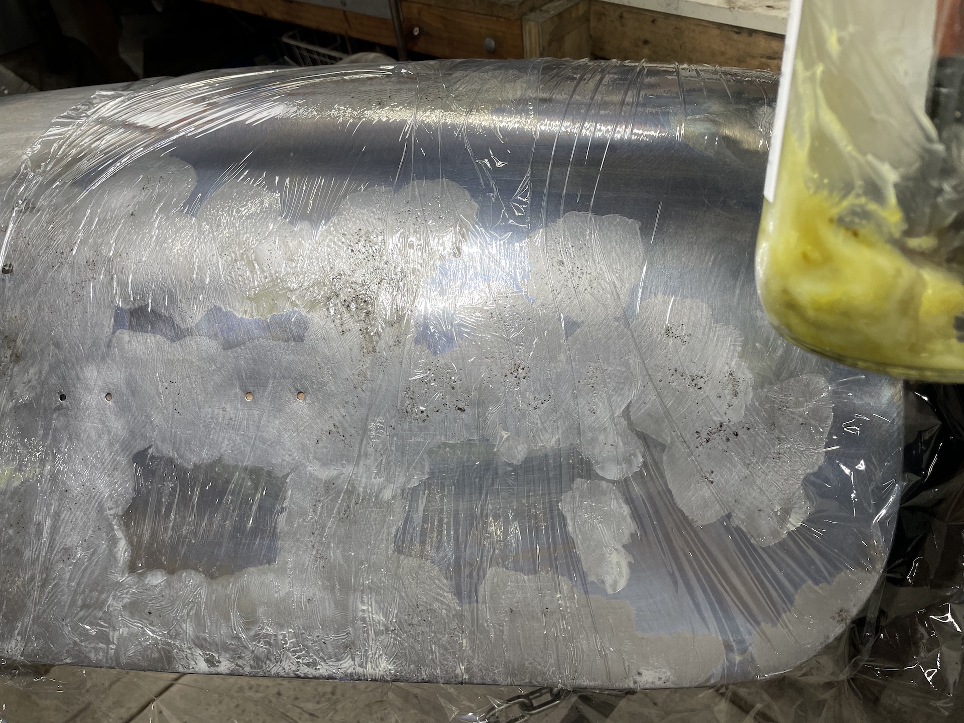

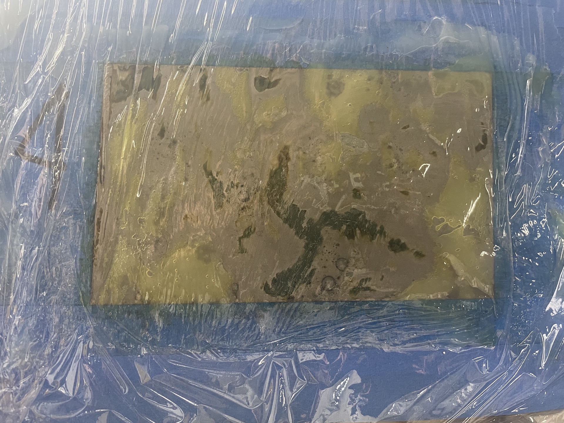

Applied to test area of the boot lid. It is thick and needs some sort of applicator (spoon).
Wire wheeled the test area first, then applied paste and covered in glad wrap. Used a small roller to help distribute the paste under the plastic.

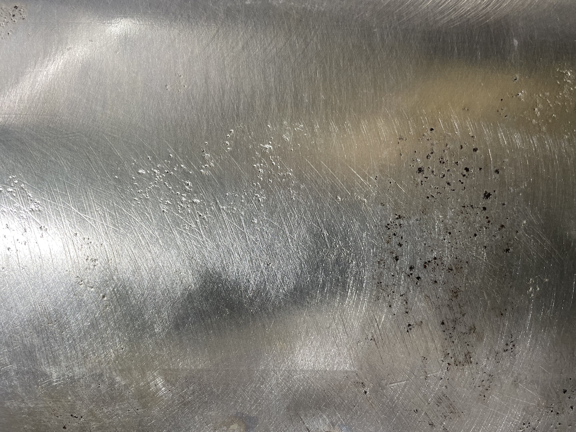

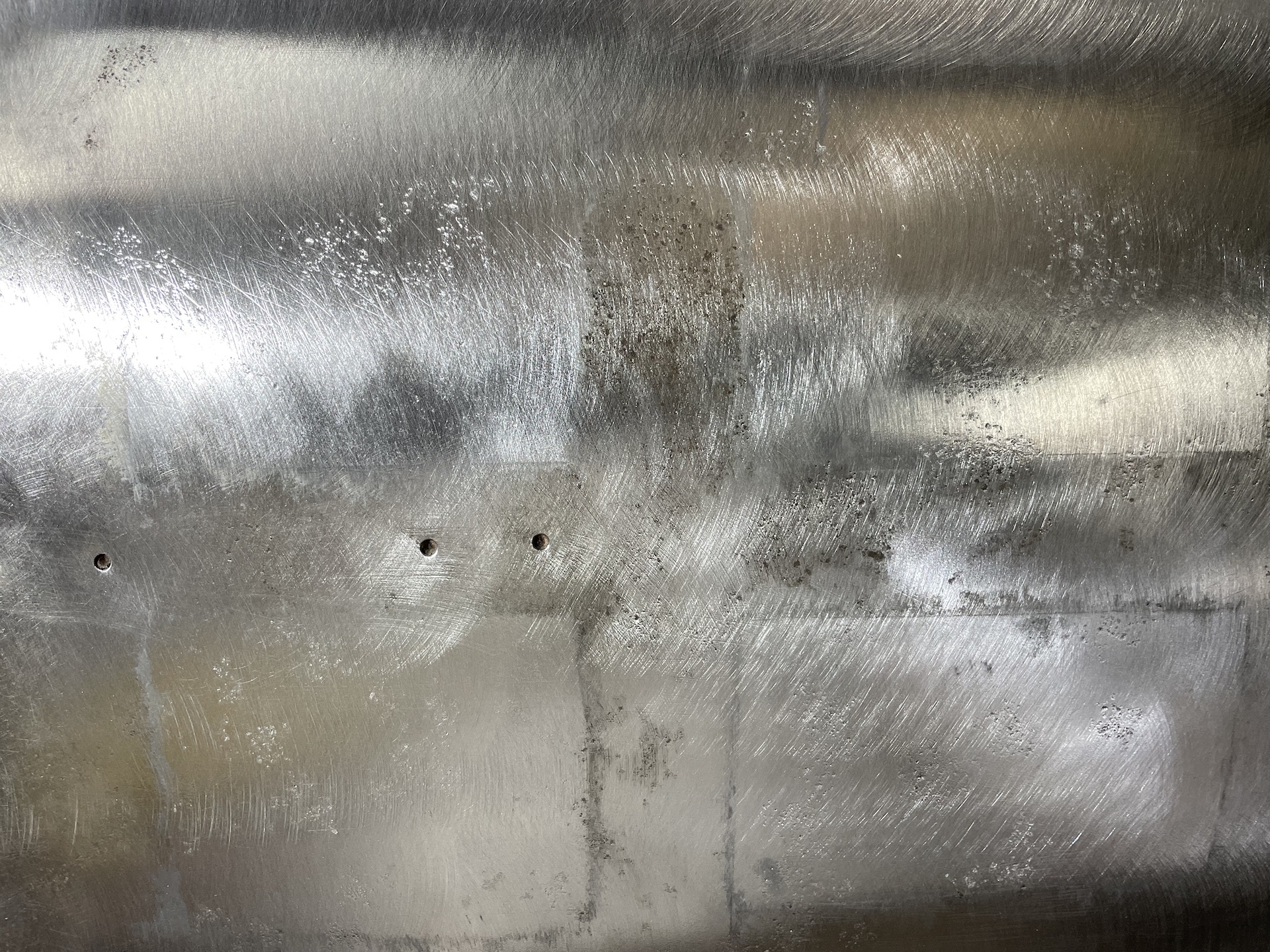

Left overnight, scraped off paste, saved in a jar, and wiped surface down with water several times to neutralise.

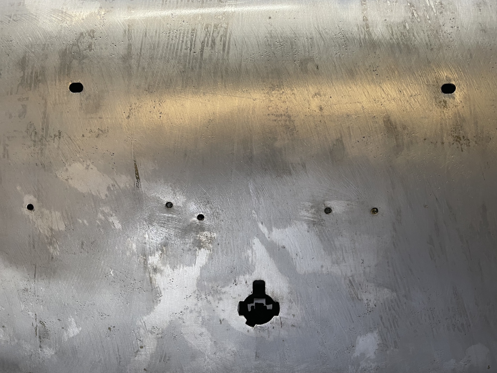

Once over everything again with the wire wheel

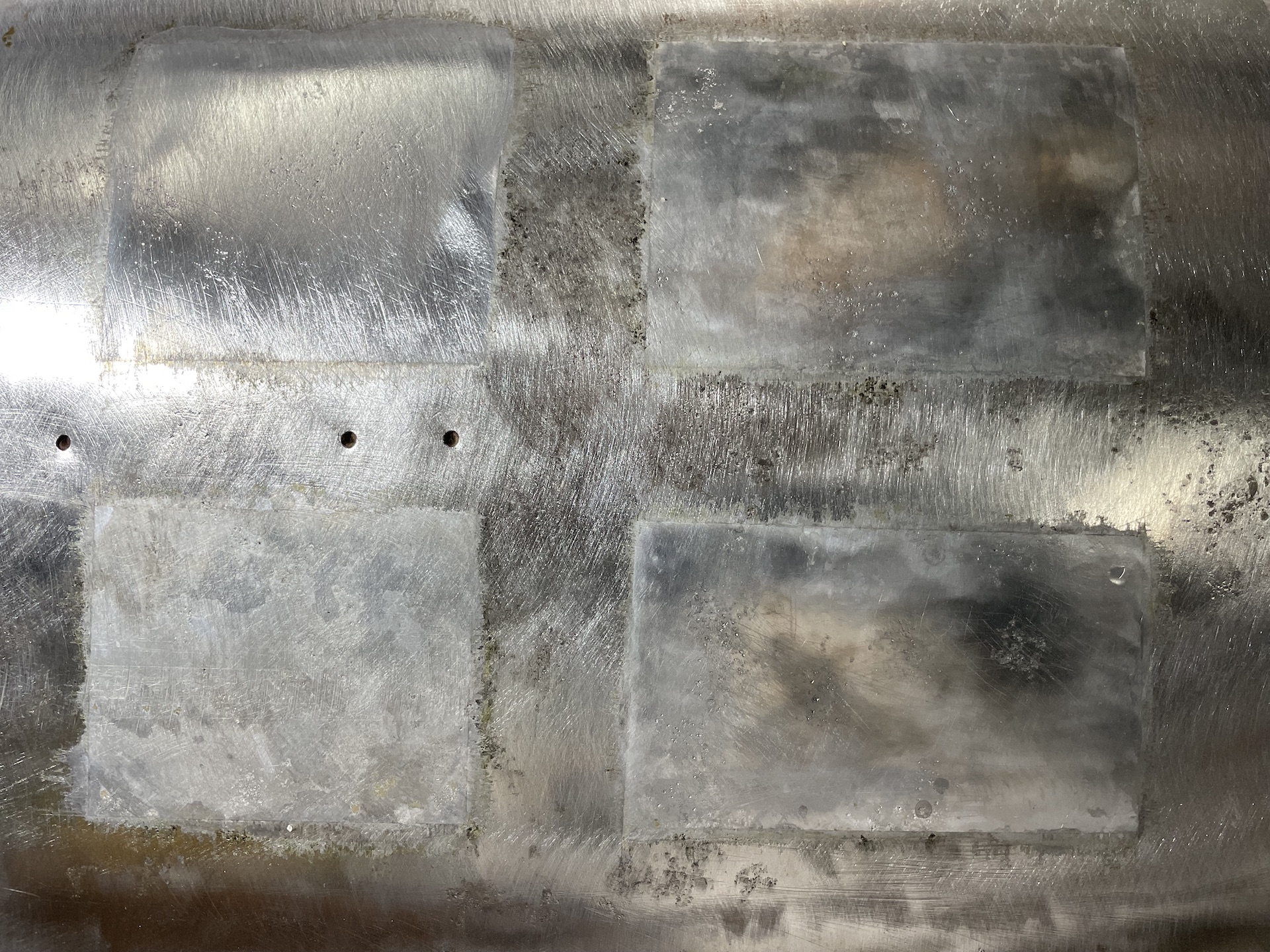

You can see the untreated areas, that was covered by the masking tape, contains a lot more surface rust than the acid treated sections.
Had to go over all the other areas I missed with the paste which I managed to save enough of to re use.

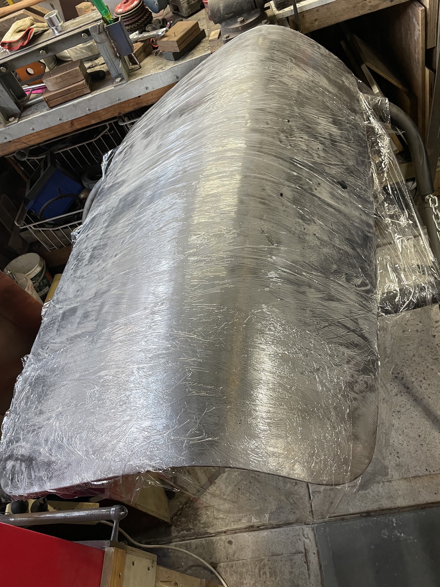

Now onto the gel.

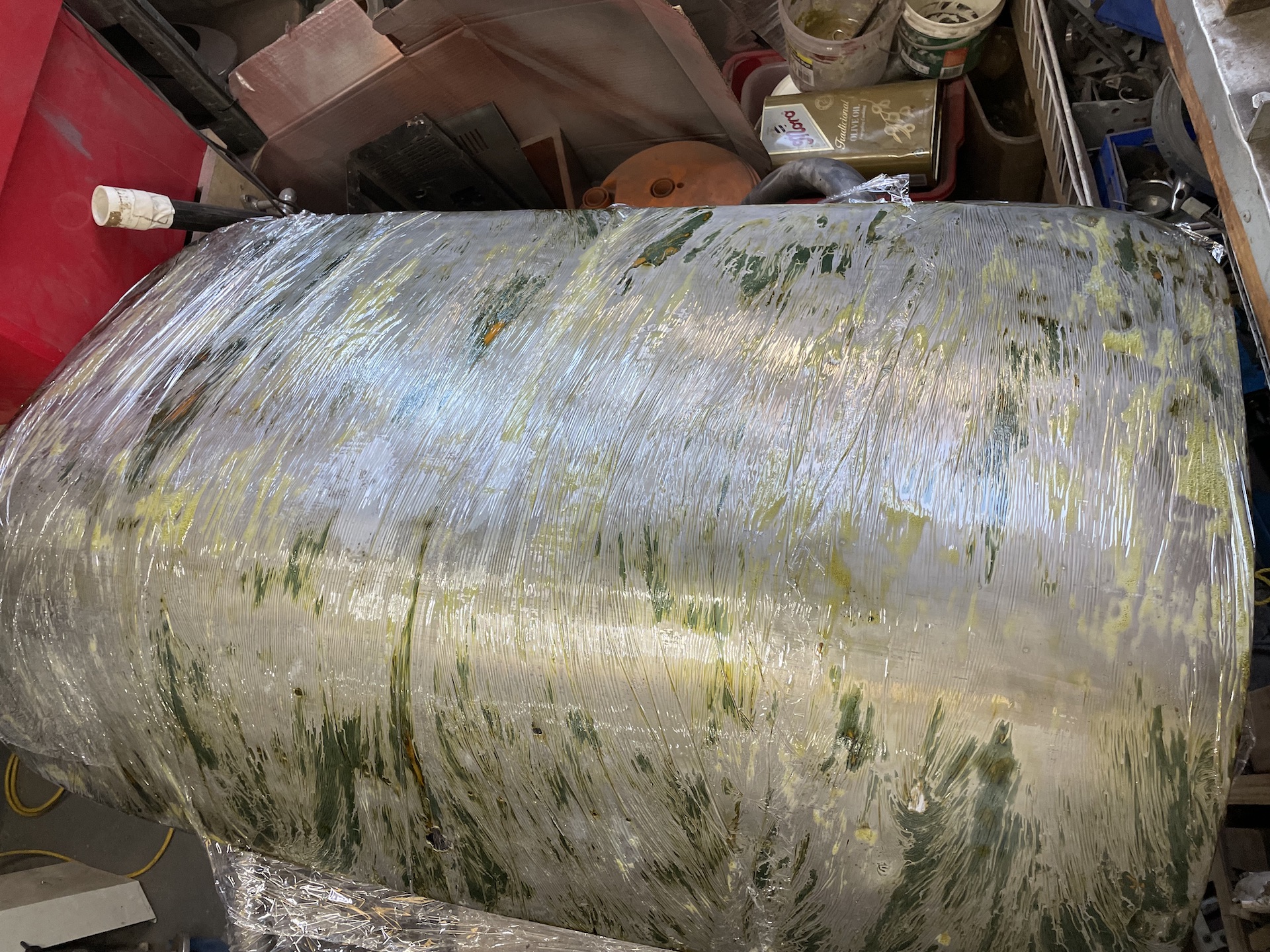

Applied with a 30mm brush to the whole panel and covered with glad wrap.
Three hours later

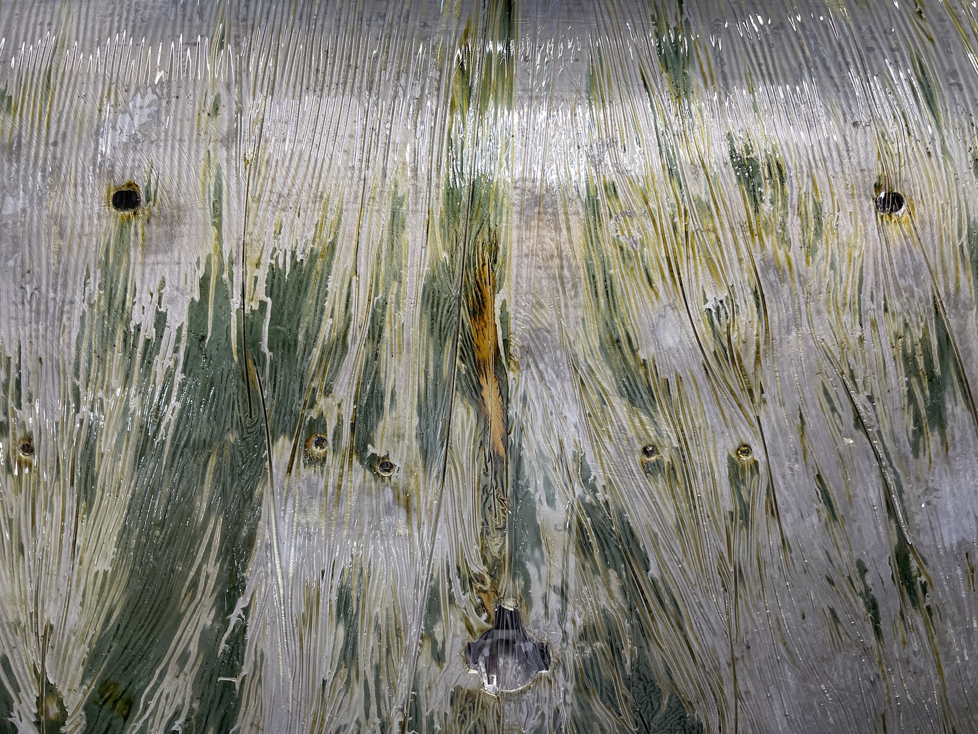

The next morning. Gel has gone quite liquid under the plastic.
Wiped down with water.

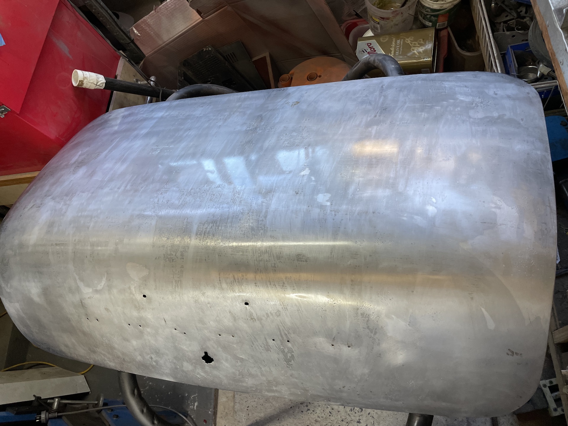

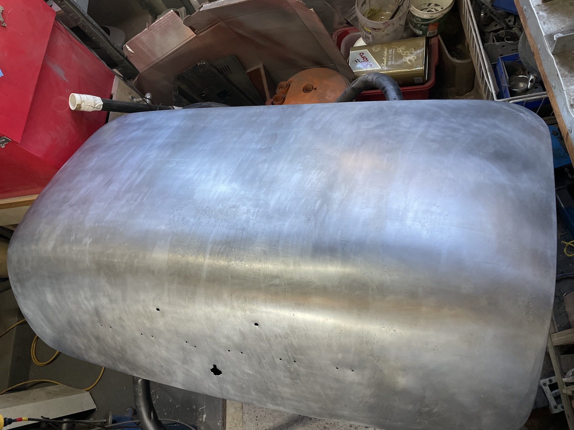

Looks pretty good, although deoxide reveals a few spots. Should have wire wheeled it again but was interested to see how it went by itself.
To sum up, will definately do this again. For a heavy soak, the paste is the go, but for a general clean up, the gel does the job and is easy to apply.
Either way, it's not magic - you do still need to wire wheel it, but far less than if you did wire wheel alone. Also less chance of warping the panel with heat.
Here is the end result sprayed with easyphos for storage. Lets see how long it takes for surface rust to reappear.

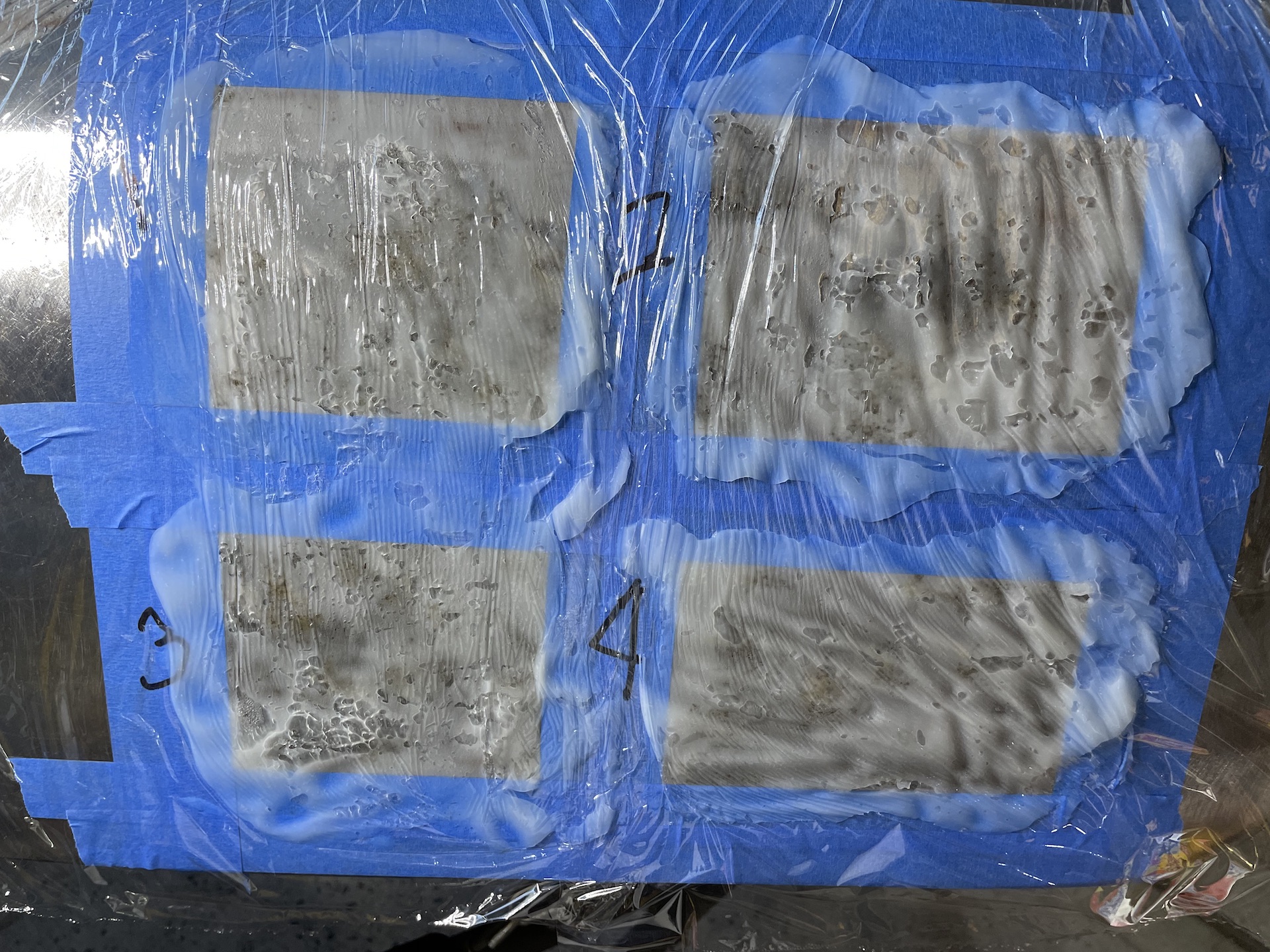

Clay - interesting to see how molasses would work, but might be too runny. This stuff didn't move when applying and seems to stay trapped under the glad wrap - even on the steep angle of the boot. As for time, I can only go by my limited experience with parts in citric acid bath. I soak for a day, rinse, scrape/wire brush and repeat. Things that have been left to soak longer still needed to be wire brushed and repeated. So decided 24 hours is more than enough.

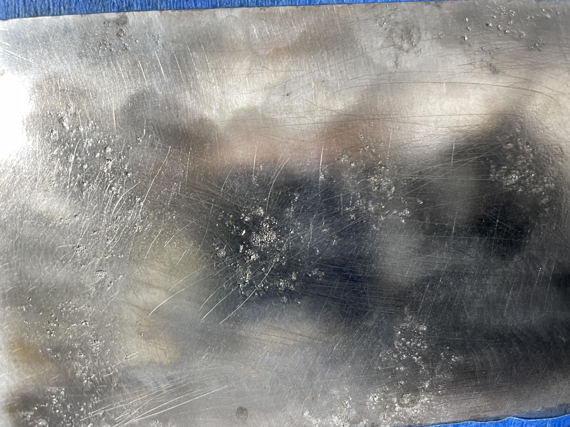

My original idea with the 4 boxes in the first picture was to test different amounts of time. But I started late in the day so I only tested panel 4 after 3 hours. I took about 70 photos of the whole process, most of them now make no sense to me so I did not share more than I felt explained the concept.
But to visually explain a little more, I present panel 4 ....

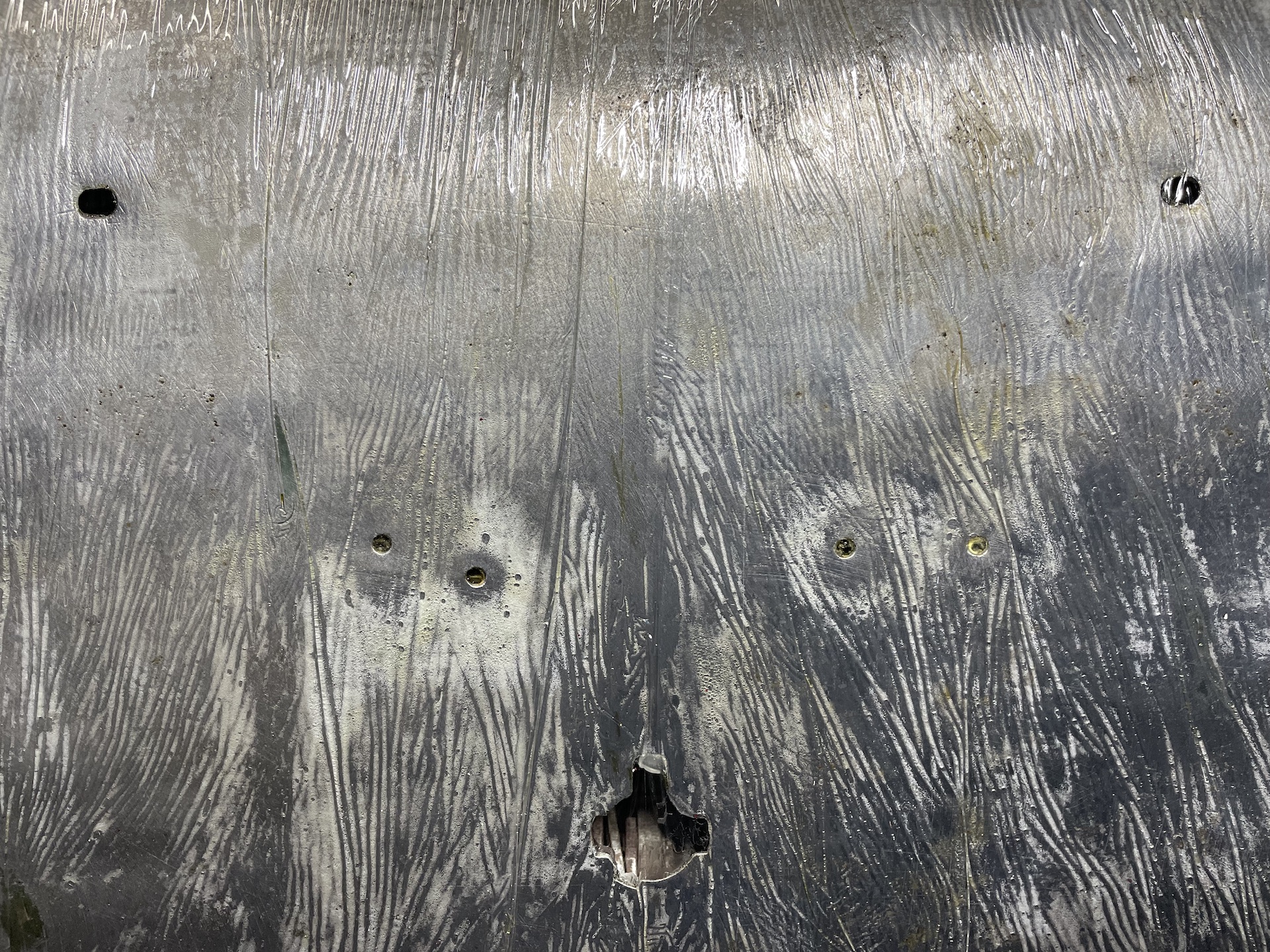

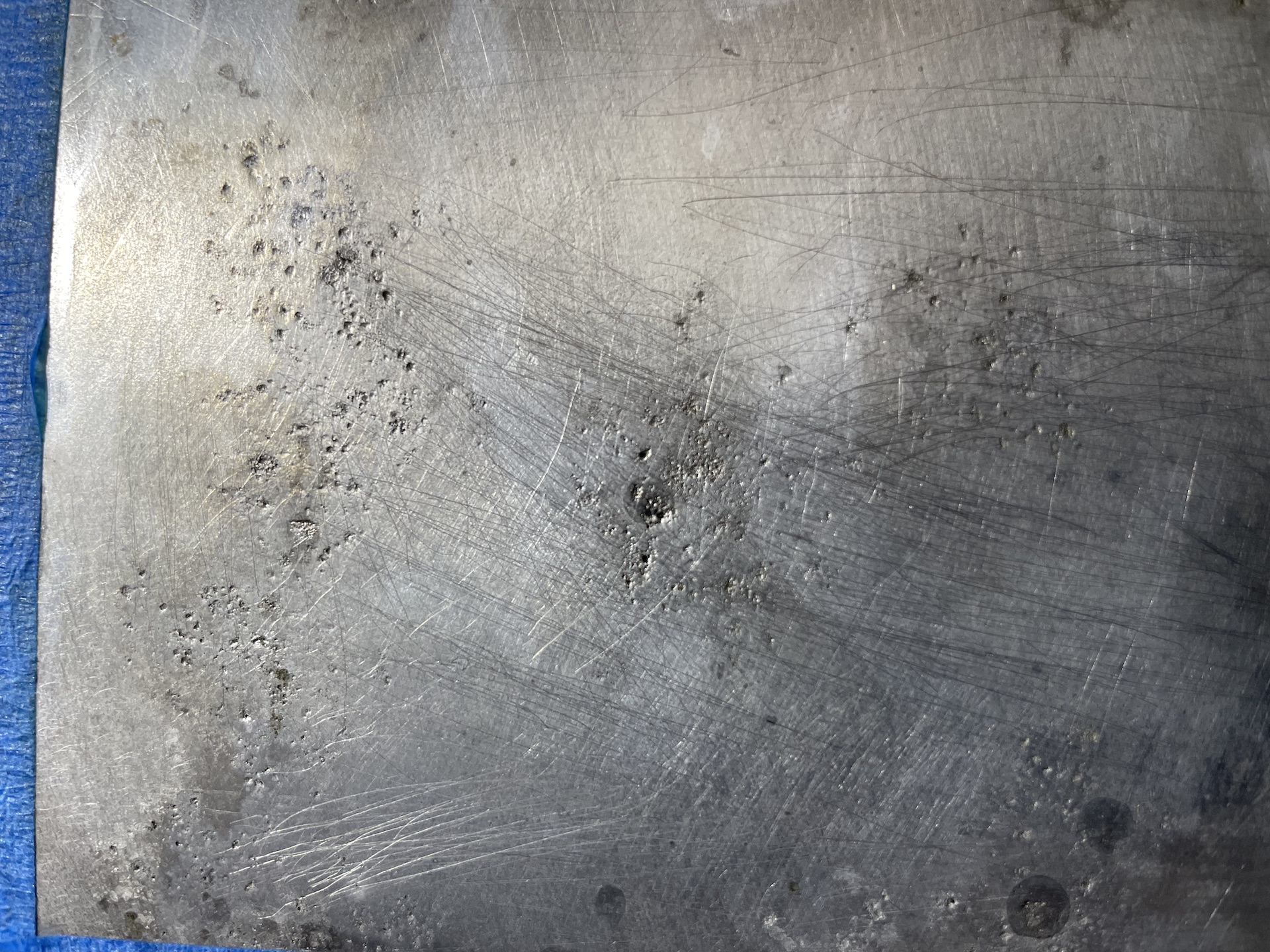

Here is panel 4 wire brushed
IMG_2409 2.jpeg (1.35 MiB) Viewed 16586 times

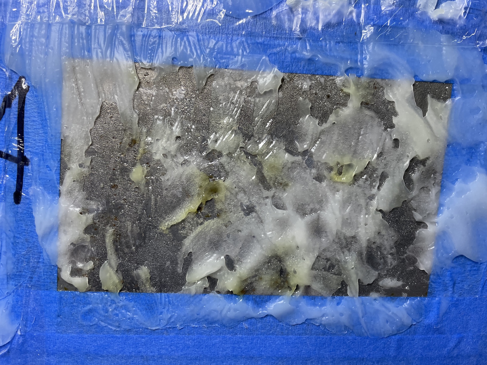

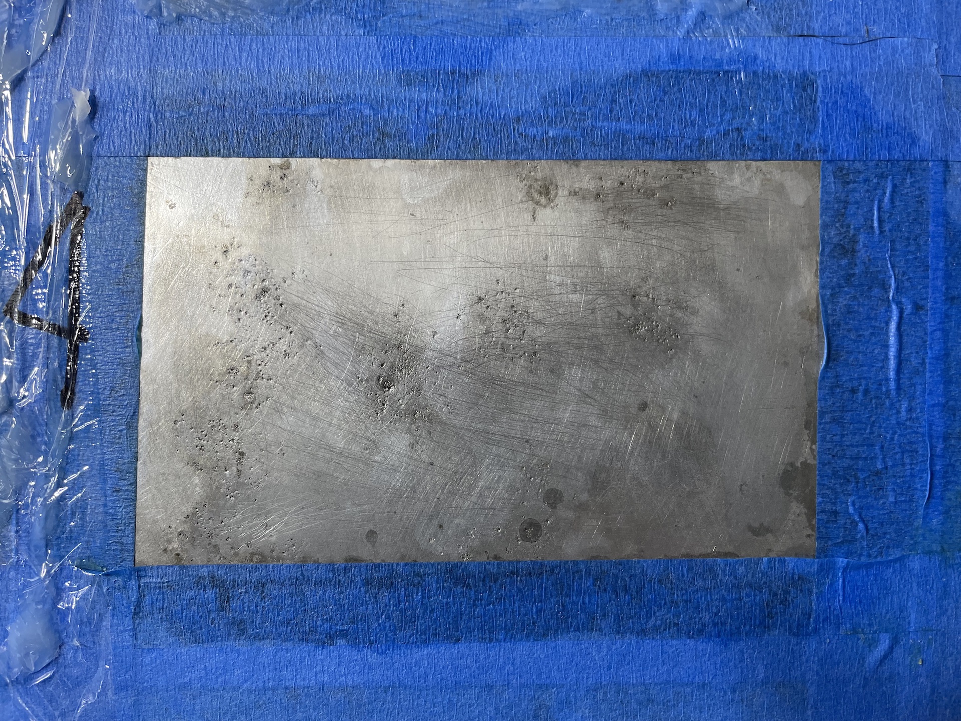

Paste applied and wrapped - after 3 hours

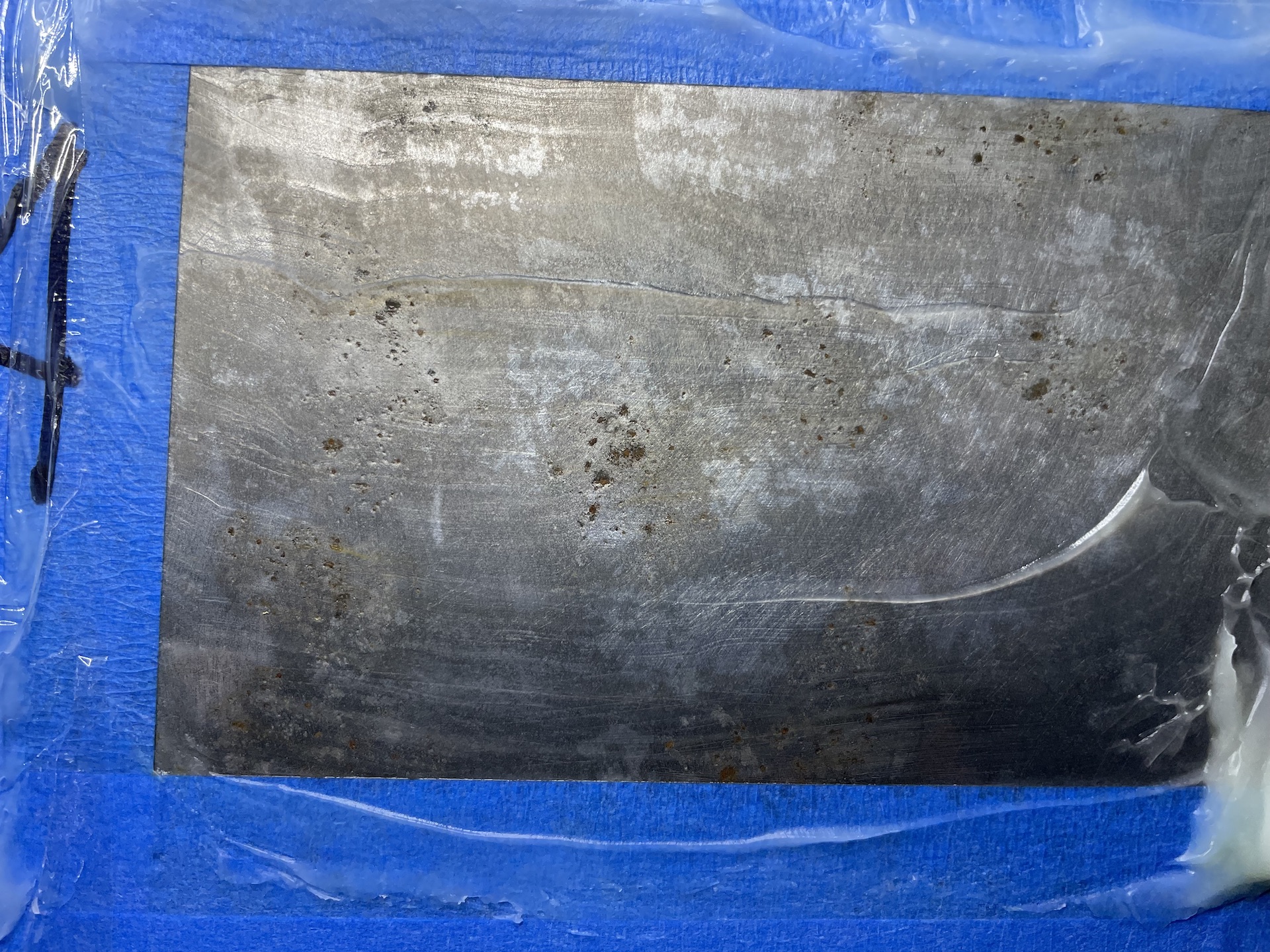

Scraped off the citric paste. Still a lot of surface rust so not long enough.

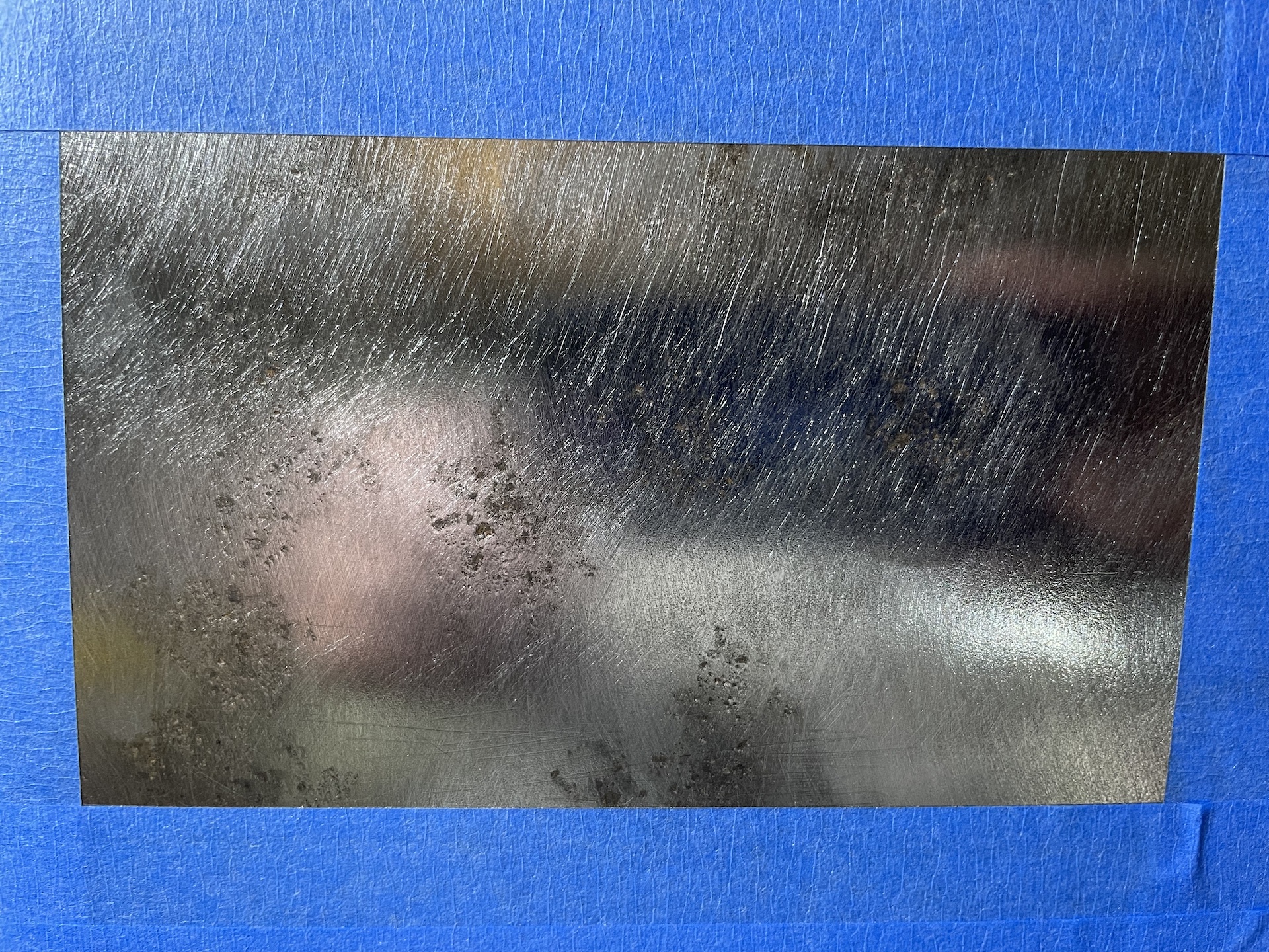

IMG_2419 2.jpeg (1.01 MiB) Viewed 16586 times
Washed, wire brushed, and re applied the scraped off paste and wrapped. This is now 14 hours after re application.
Washed again

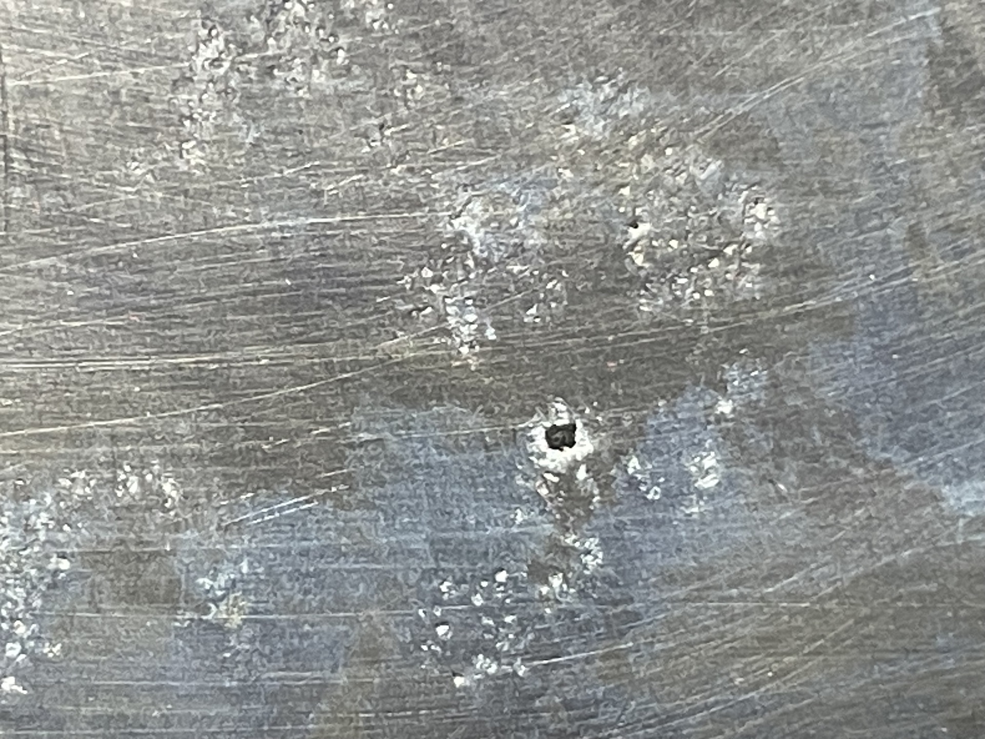

Close up.
Quick go over with wire wheel - not to shabby.
