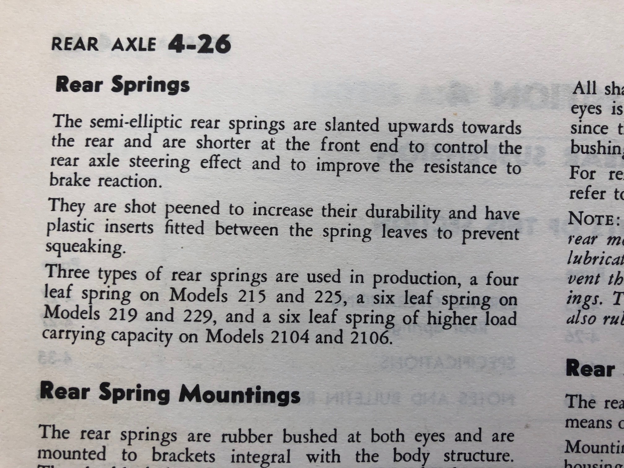

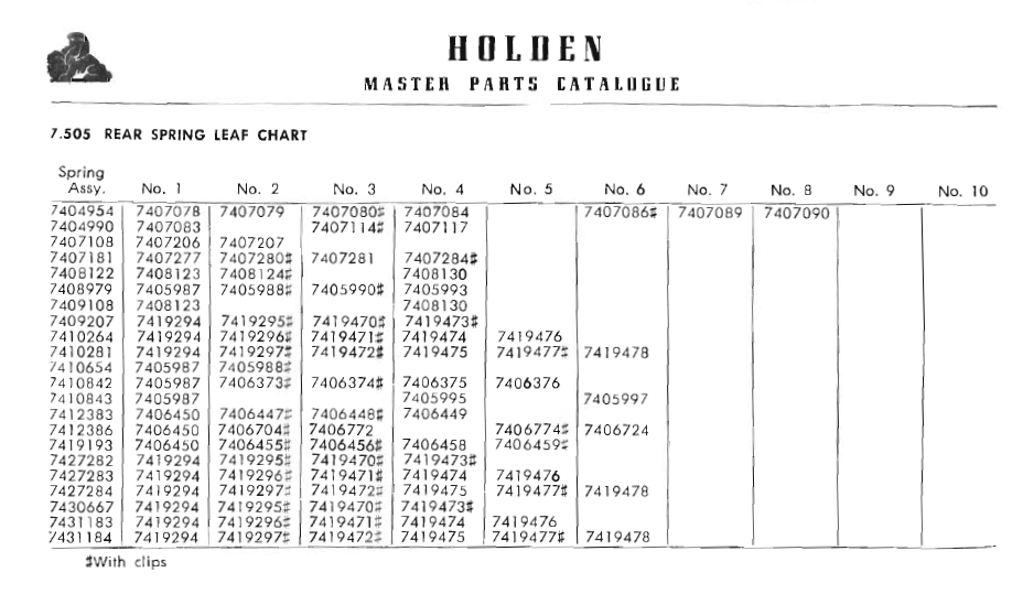

Interesting that the MasterParts (5 leaves) clashes with the Workshop Manuals (6 leaves):
Spring assemblies 1.png (202.17 KiB) Viewed 22050 times
Spring assemblies 2.png (188.73 KiB) Viewed 22050 times

My wagon and Grace's ute both have six leaves. The FB and EK Workshop manuals say the same:
Workshop manual - springs.jpg (738.79 KiB) Viewed 22039 times

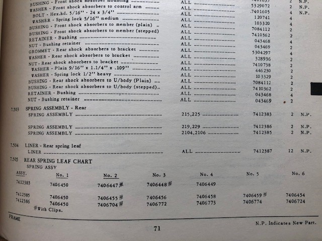

The FB Parts Manual adds a bit more info:
FB parts manual - springs.jpg (100.12 KiB) Viewed 22039 times
The ute and van springs were changed from 7412385 (six leaves) to 7419193 (five leaves) somewhere between the cars being released and the MasterParts being printed. The Specials stayed at 7412386, but that assembly number changed from six to five leaves.
