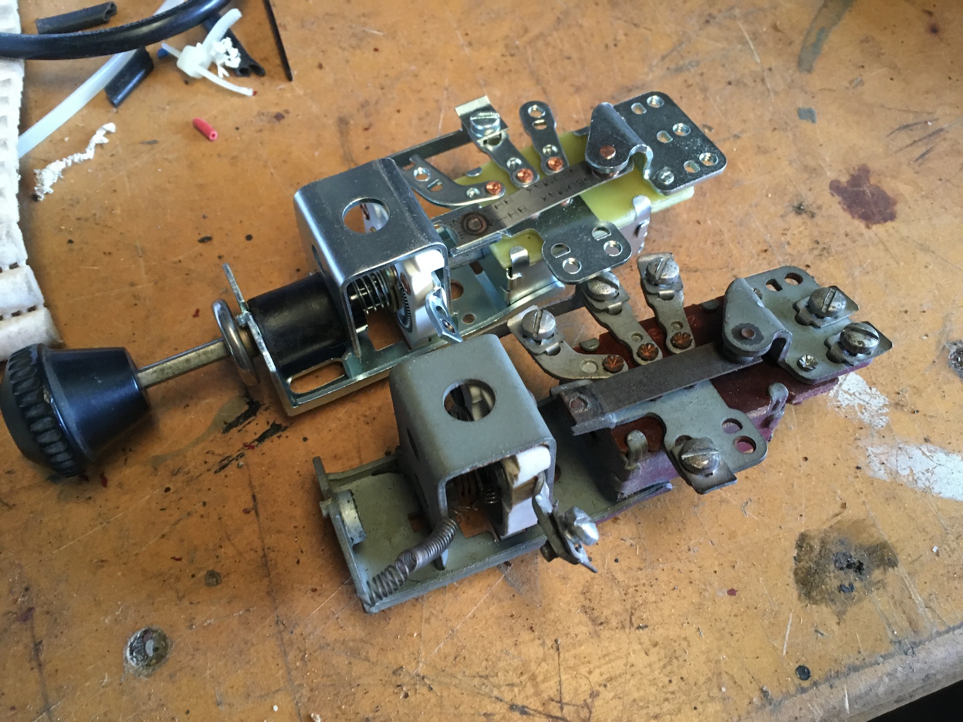

Took the plunge and ordered a new headlight switch off ebay from the States. Mine had a broken dimmer wire. Looked at the one on offer from Rares for $150 + and decided to take a chance at a 'cheaper' option. Still ended up just south of $100 inc postage. Spent at least $50 in my time researching, so lets call it even.
https://www.ebay.com.au/itm/1947-1955-C ... 2749.l2649
Knob fits, dimmer resistance is 0 - 5 ohms. Original was 0-6 ohms. Not sure if the bi-metal safety cutout is different as the unit is sold as 6V. Most likely run relays to the headlights fuse separately. Might test at a later stage.
Only things I needed off the old switch were the knob, the nut to screw the switch to the dash, and the rubber boot that sits between the nut and the ceramic resistor which I guess is some sort of isolator?
Comes with all the screws etc. Pretty happy.
