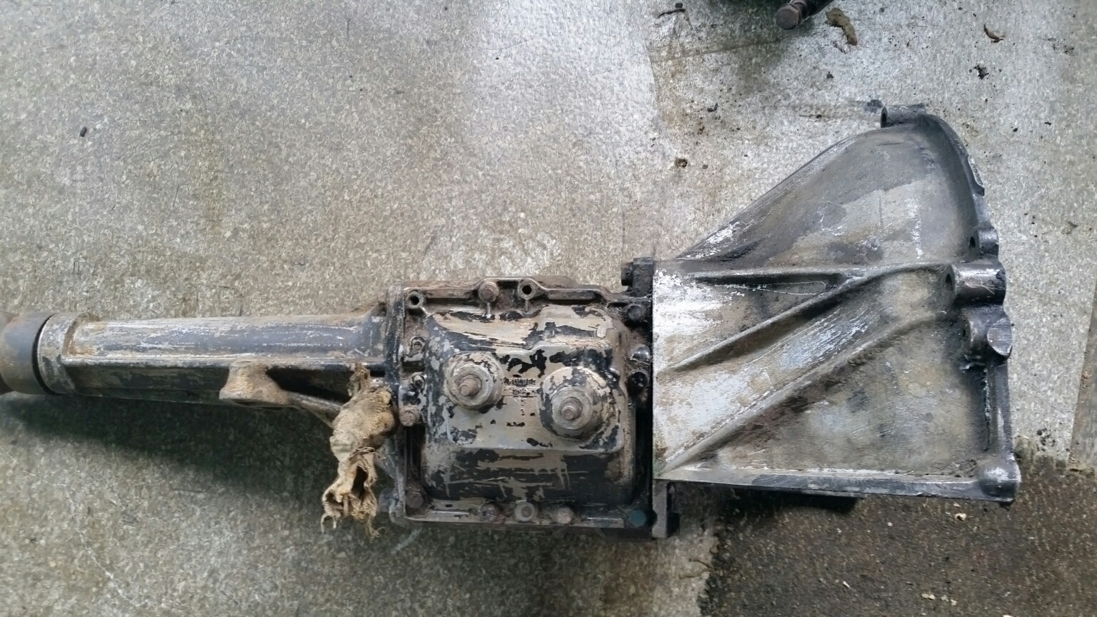

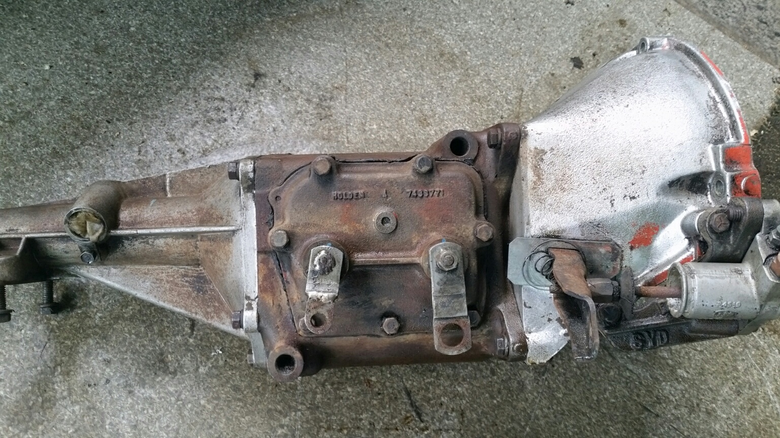

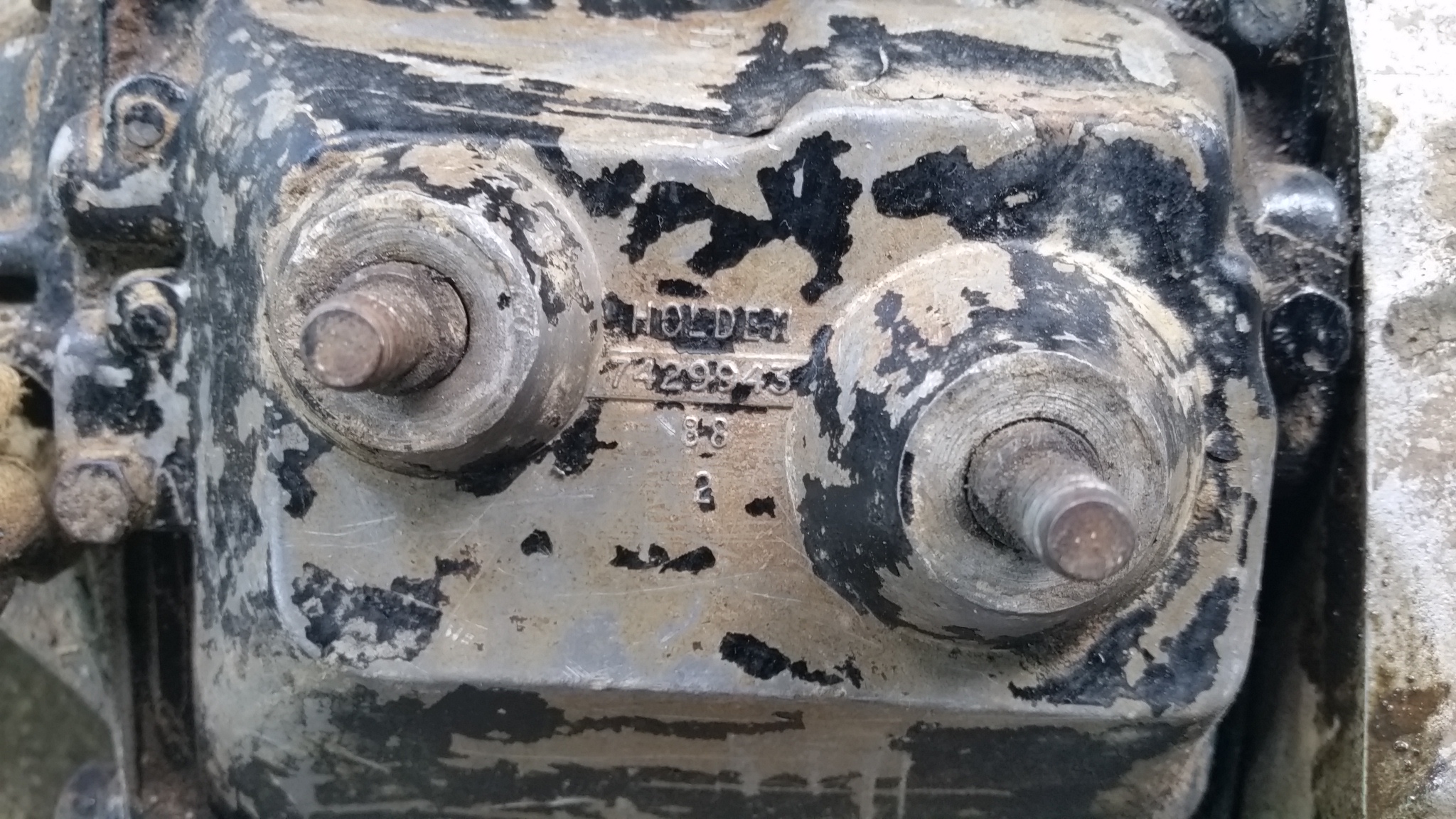

Top one looks like all synchro with what appears to be a Dellow adaptor for the slave cylinder ?
Bottom pics are EJ/EH type box

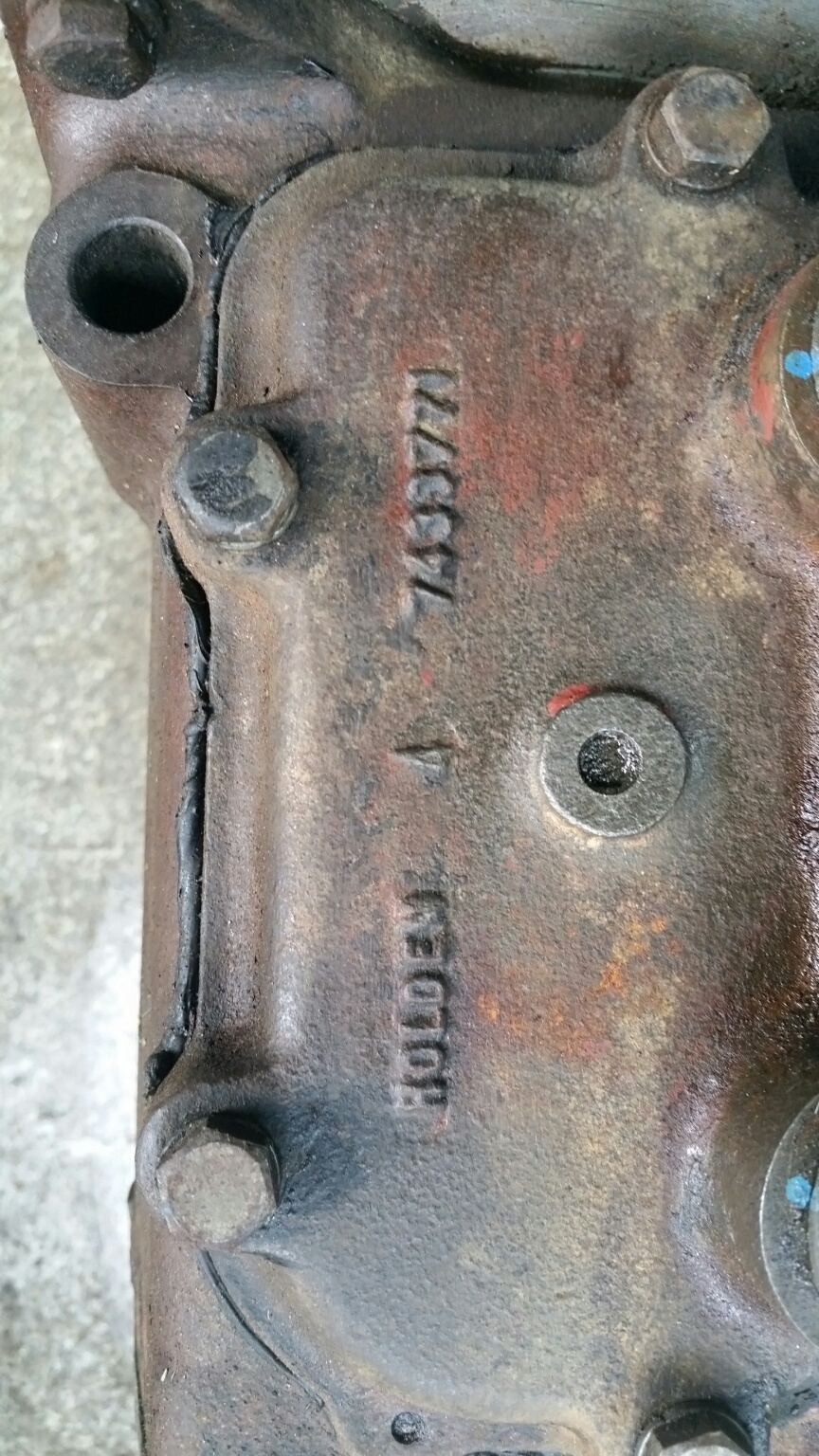

The bottom picture is an early EH 149 gearbox (because the bellhousing is ribbed, but doesn't have the EJ transmission mounts, but yet the rear extension housing has the boss for a rear engine mount).

Checked the MPC and the part number on the cover of the early box is specific to HR. Friend of mine did run one of these in his fb many years ago using the fb linkages and column levers hooked up no doubt to the hr arms on the box. Used an eh tail shaft.
