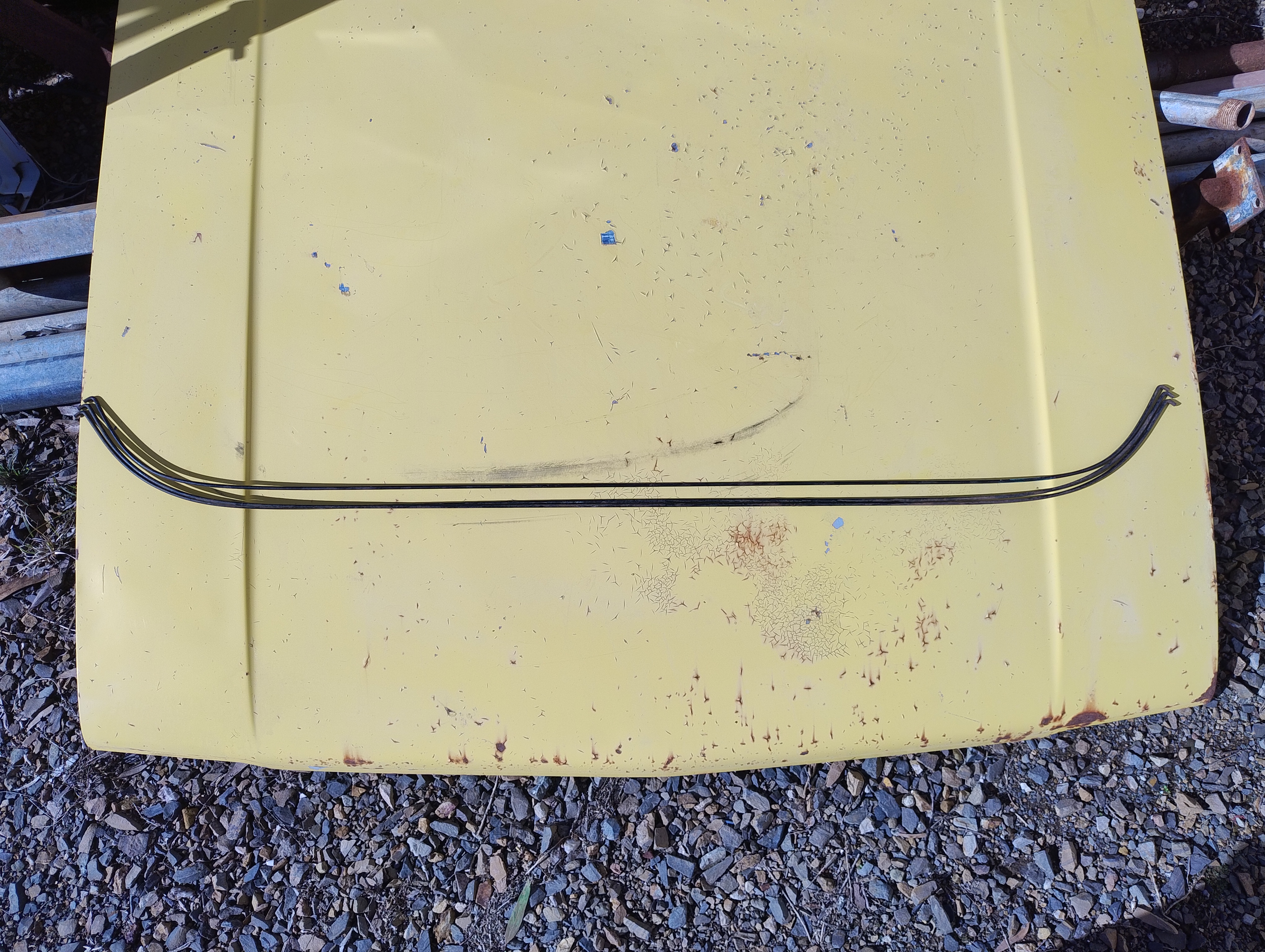

Does anyone have a photo of the listing wire that's referred to. Looked in the manual and there's no mention of them. May have to try and make something to do the job, Thanks
Posts: 11636
Re: Roof lining bows
My lining is at the trimmers with the bows in it as removed from fb ute. I’m thinking I will grab it as the work is still a way away and I’m afraid he sill get sick of it taking up space and chuck it. I’ll let you know.

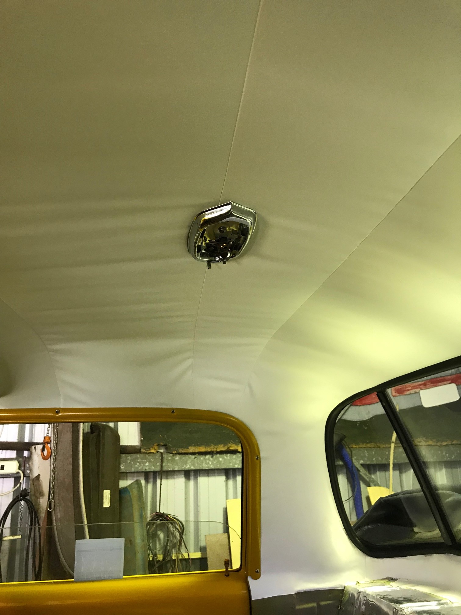

I recently fitted the headklining in my ute and there are only 2 bows as has already been said.

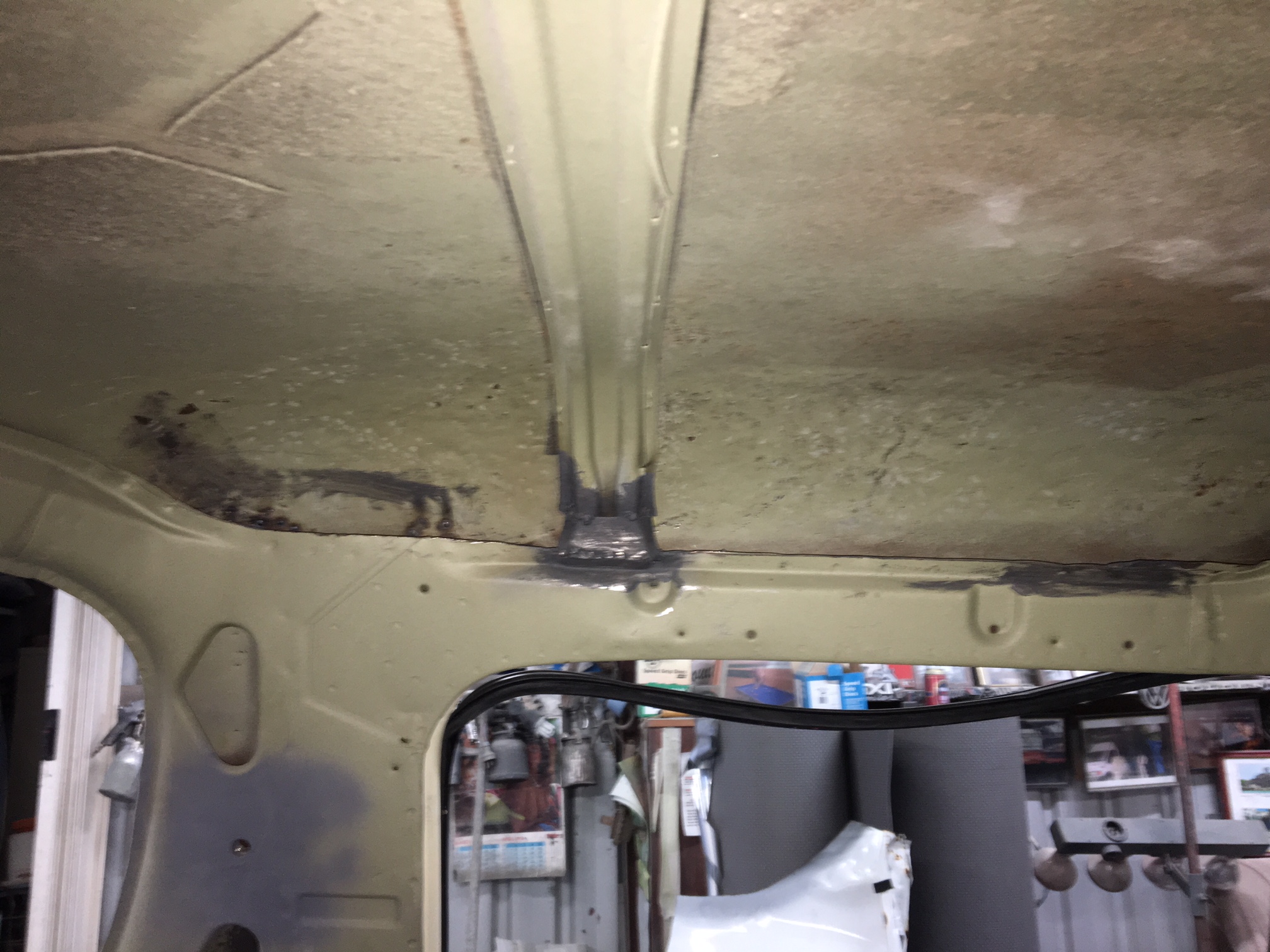

The new headlining that I purchased had cloth pocket in it and this is where the listing wires that Harv mentioned go in, there should be small metal tabs on the front edge or side of the roof strengthener (this is from memory :roll:) and the wires hook over the tabs obviously when you put a hole in the cloth.
I found a photo from my build that shows the wires in place before I removed them , you can just see them on the right hand side; and the second photo shows the head lining in, the middle seam is where the listing wires are, this is not a bow remember.
Roof Repair 5.JPG (774.27 KiB) Viewed 13984 times
Hope this helps
