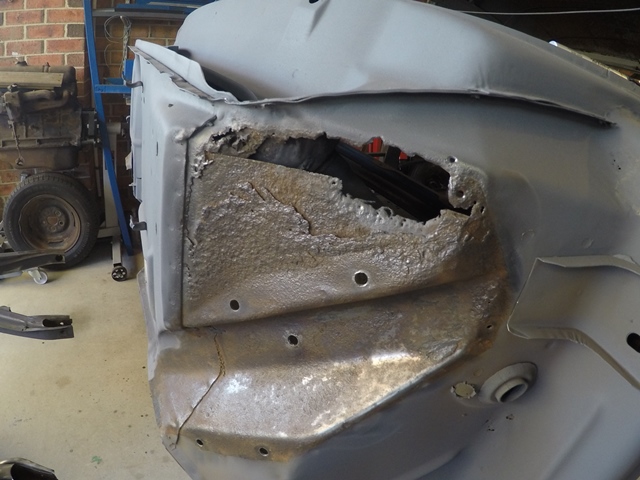

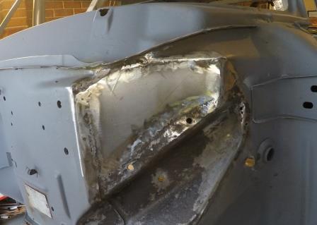

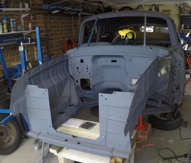

So Orange Betty (OB) was blasted and is now primer grey but I didn't do much since September last year as I was building myself a rotisserie. Took a long time as I only get a few hours each day of the weekend but was good welding practice and successful. But despite mounting OB on the rotisserie and taking her for a twirl I've just got her level and taken the front rotisserie mount off. I had removed the left hand outer sill and cut out what was left of the bottom of the A-pillar but heeding the advice of forumites I decided I shouldn't 'fix' anything until I had the subframe and doors on and could check that everything aligned.
So I made up a dolly (ie?) for the subframe and test fitted which was ok, but before fixing the bottom of the A-pillar which is quite daunting, I thought I'd tackle an easier 'fix' for the first try and do the subframe and body mounting points. The one specifically:
LH subframe wall att.JPG (145.72 KiB) Viewed 32092 times
And hence the milestone, OB's first bit of actual repair!
OB first fix.JPG (153.12 KiB) Viewed 32092 times
Had to chase quite a few holes I blew in the old metal which I suspect is a lesson in making sure I cut out to good metal to start with.

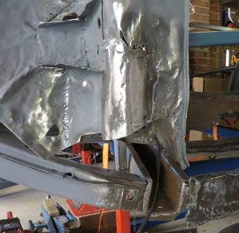

Slowly, slowly. Fixed this on both sides:
Fixed 1.JPG (36.31 KiB) Viewed 31934 times
also fixed the subframe sides where they attach to the body i.e. these bits (wings?)
wing fixed.JPG (32.65 KiB) Viewed 31934 times
and put the subframe back on to get things aligned, at three points anyway:
subframe on.JPG (40.55 KiB) Viewed 31934 times
So I can now work on the bottom of the A-pillar
A Pillar repair.JPG (40.05 KiB) Viewed 31934 times
Brett027 has used the Stark sections to fix Wilma and which look very neat http://www.fbekholden.com/forum/viewtop ... ks#p238622 but they are expensive.
I'm in no hurry and like the idea of fashioning a 'Frankenstein' fix so think I'll attempt similar to Leroy the EK ute here (page 2 I think) http://www.fbekholden.com/forum/viewtop ... 15#p227856

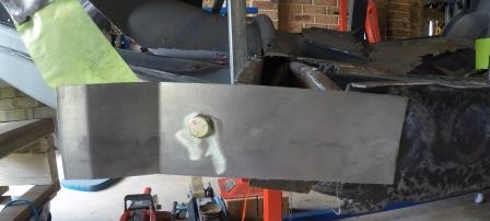

My rough plan is this:
LH subframe to inner sill.JPG (33.15 KiB) Viewed 31934 times
actually extending the back of subframe attachment point across the cross member and onto the face of the inner sill. Then fashioning the outer sill attachment point as for Leroy the EK ute.
A pillar repair 1.JPG (40 KiB) Viewed 31934 times
Appreciate any and all advice as to whether that sounds reasonable.

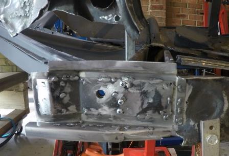

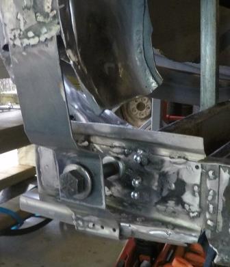

Hi all, so a bit more progress. As per previous posts I thought I'd just do simple bend in some flat bar to be the inner sill extension and to bolt the outer sill through to the subframe. But as I was mocking it up it became apparent that the design of the standard inner sill extension allowed for somewhere to join all the other panel work to (yes I usually only figure this stuff out on the run...). So I thought I'd throw in a few bends here and there:
Didn't quite get it right the first time or second time or even the third time but the third was close enough for me to add on a few of the tighter bends as an afterthought, to mirror the bottom of the inner sill. And so have ended up with something almost like a bought one:
Final 2.JPG (43.27 KiB) Viewed 31786 times
Have just screwed the front flange of the x member for now as it was too hard to get to and didn't mate nicely with my plug weld holes. Then bent up some 2mm flat bar to match the profile of the rare spares outer sill and my best guess at the A-pillar profile and hey presto, a semi-sound structural repair.

Posted: Sun Nov 03, 2019 4:01 pm
nice work mate, is extra satisfying when you fab up something yourself that works rather than just buying one out of a catalog. :thumbsup:
Posted: Sun Nov 03, 2019 5:44 pm
Good progress Dave. I’m with blacky on the satisfaction factor. I use tek screws quite a lot to hold things in place, weld up, remove screws and replace with plug welds.
Posted: Mon Nov 04, 2019 11:15 am
by FireKraka
Nice work Dave, don't forget to put a crush piece in between the inner and outer mate.
