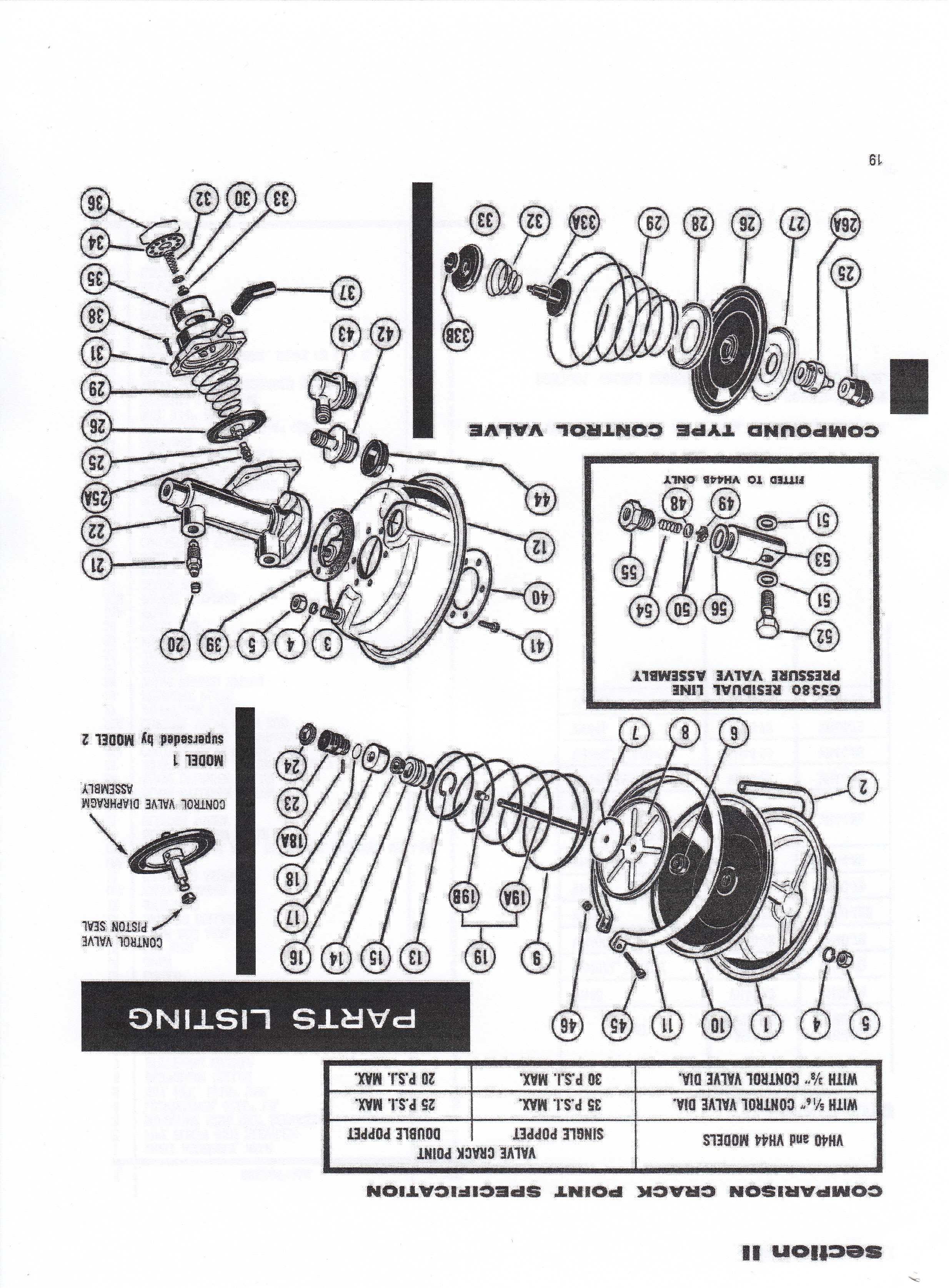

Power Brakes made me up a minor kit for the VH40 hydraulic circuit. Price wasn't minor mind you. I was out their way. No visible damage inside the cylinder, rubbers a bit hard and shrunken as you'd expect. Replaced and back together with some assistance from blackys mate Neil who runs gmh Torana.com and is a brake tech.
Reassembling the diaphragm, I realised I hadn't inspected it closely enough, and had the smallest of tears, which could have happened on disassembly. Good old Car Parts Plus came up with a Protec replacement inside 2 hours for $30.

I ended up swaying out some bits from the VH44 I recently took off. Power Brskes seem to have given me to number 25 5/16" cups, instead of a 25 and a 25A............

Thanks Harv. 40 and 44 are identical in the control valve construction.

VH44 for drums, the smaller one with offset front mount lug.

Sorted out the booster with a control valve piston from the VH44 I took off previously, and the brakes are now great, well, by comparison at the least.
