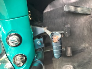

How do you get this bloody thing off?

Recon there is a vertical brass pin?
Any way just replace the whole handle. Unbolt from dash. Remove spring clip from end and detach from cable. Handle assembly can then be removed from ratchet. Chrome replacements on eBay or got a few originals here. Cheers
