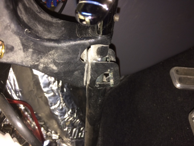

1: Apart from the shaft coming out, a small bracket/clip thing fell out from under the dash. It's the little H bar that makes the ratchet noise and locks the shaft in place when all is well. I believe it is called the handbrake ratchet "pawl". My Gregory's manual mentions nothing of it and searching Rare Spares, Ebay etc, I located a 'repair kit" for EJ onwards which has 3 bits in it, which I presume would be similar for FB EK. There is no kit for FB EK.
http://www.rarespares.net.au/rarespares ... duct=H1291
I also located a spring by itself on Ebay by everyone's fav seller Early Bits (I think it's number 1 or maybe 3) for FB EK. My questions are, do I need the 3rd piece as in the EJ kit and can someone tell me how it all goes together? I've worked out how the H bar goes in, but how does the spring sit and what is the 3rd bit for? Thanks.. My "ratchet pawl" was working because it had been bodged up, someone had managed to hold the clip in with a cable tie, which seemed to work until the cable came off the end...

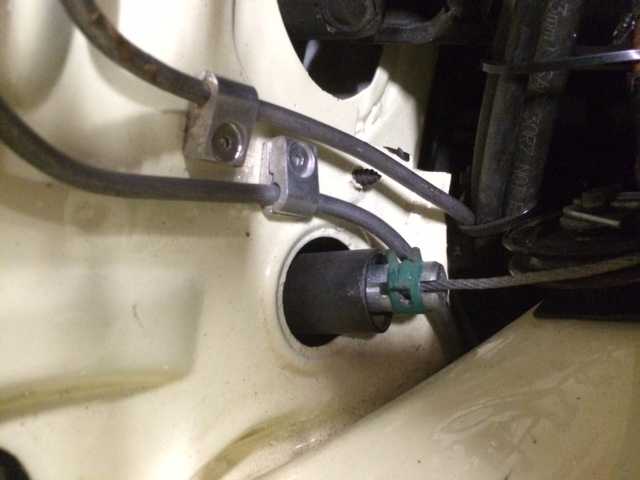

GIDDY UP!!BILLY BLACKARROW wrote:Grind them down to clear
BILLY
Shame it's green. But it beats a used circlip for $21 to my door.
12.7mm is the shaft size if anyone cares..
