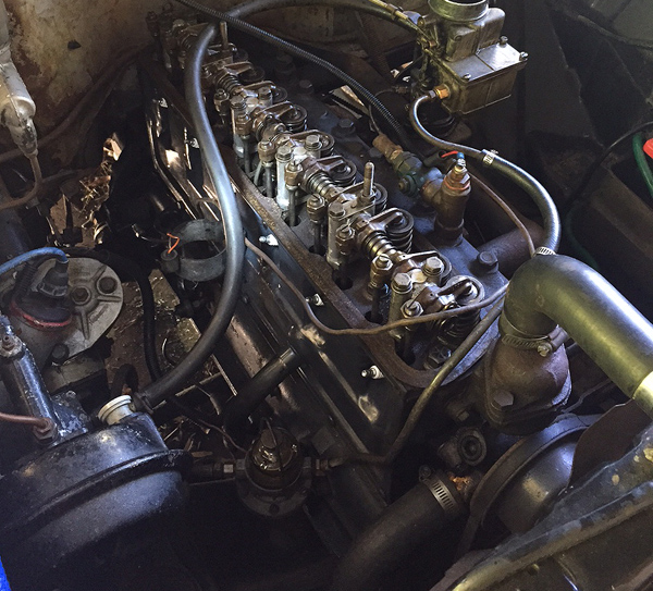

Hi All,
Having trouble getting my sideplate off on the drivers side to have a look at the welch plugs.
All screws and bolts are out. plugs out.
Seems to be some heavy duty sealant in there with the gasket.
Any tips on removing the Sideplate?
BG

Go gently around the side plate with something like a paint scraper. Tap it down between the side plate and head/block, lever it back just enough the break the gasket joint. Do this as much as you can around the full perimeter of the side plate. Resist getting between the two with a big lever and just going for it at one spot.....you'll end up twisting the side plate and you'll never get it to reseal after that. Don't forget to remove the breather tube first as well.

It's been a long time but I thought the spark plugs need to be removed aswell????

Picture is deceiving Trev. It reads that he has the plugs out though.

Yep, the plugs and dizzy are removed now. The pic was a step previous. Taking photos along the process so I can put it all back together again.
Was hoping not to have to undo the fuel pump to get in there, but that might have to go too.
The breather is a bit tight, should it pull down from its bracket? or will a bit of WD-40 do to loosen?

There is a little tag that bolts to one of the sump bolts, have you taken that bolt out ?? That's about all that holds them in.
