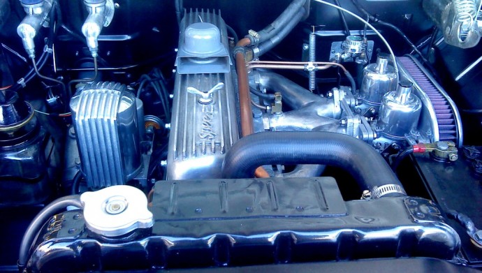

Browny there's a few options. I've run with twin 1 3/4 Su's bolted to a Warnerford DCOE Manifold (Uses a Lynx adapter).
- DSC01202.jpg (91.43 KiB) Viewed 3283 times
The grey motor lends itself well to hand built manifolds as well (simple round port and flange bolt up) There are a lot of fabricated manifolds kicking around that others have made to adpate twin Webers (side & downdraught) and there are some newly made items such as Sonic Injections 2 barrel Weber manifold. I guess the choice is yours. Mine was done so it could be reversed back to standard if I wanted to (no panel mods or battery relocation). I also used SU's for better drivability and ease of tuning. I had a DCOE Weber but expense of jets and ability (mine and its) to get it to work with the manifold was poor. As I'll mention below the port size of the manifold is so important. If your going lumpy cam then I would stay with SU's although I wont discount any others such as Thommos very lumpy grey with triple downdraught Strombergs.
If I can suggest a few things that you should keep in mind when changing to different carbies:
Manifold and port sizing is very important. Don't go too big and don't go too big in carby throat size. Intake velocity must be kept at a reasonable speed otherwise you will suffer with poor low down performance and flat spots.
IF you can try and employ some sort of manifold preheat system. This is rarely done but IMHO is important to good fuel atomisation and drivability when cold. It also reduces run time on the choke and prevents cylinder wash-down which increases bore wear. Su's can also suffer from icing on the throttle plates even when the manifold is warm from external heat generated from the exhaust and under bonnet temperatures. I'm thinking of doing a simple air induction preheat drawn from the engine pipes. Hope fully I can rig a bypass that will open up and draw from colder air when the engine warms up (similar to hotbox on grey, using a bimetallic spring controlled flap arrangement)

Craig now thats a nice looking engine I never
Thought to much on the manifold ports size
More on the carb throat size .heated su manifold
Would be a pretty interesting setup
